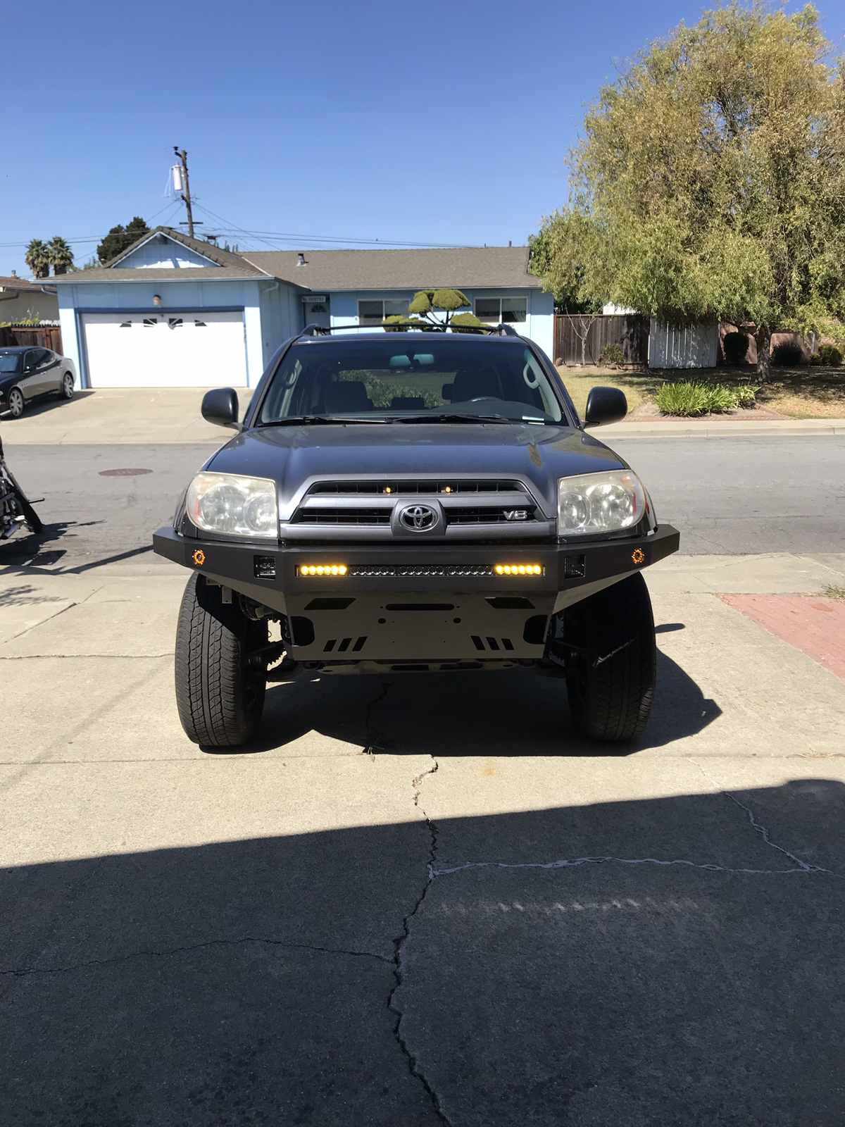

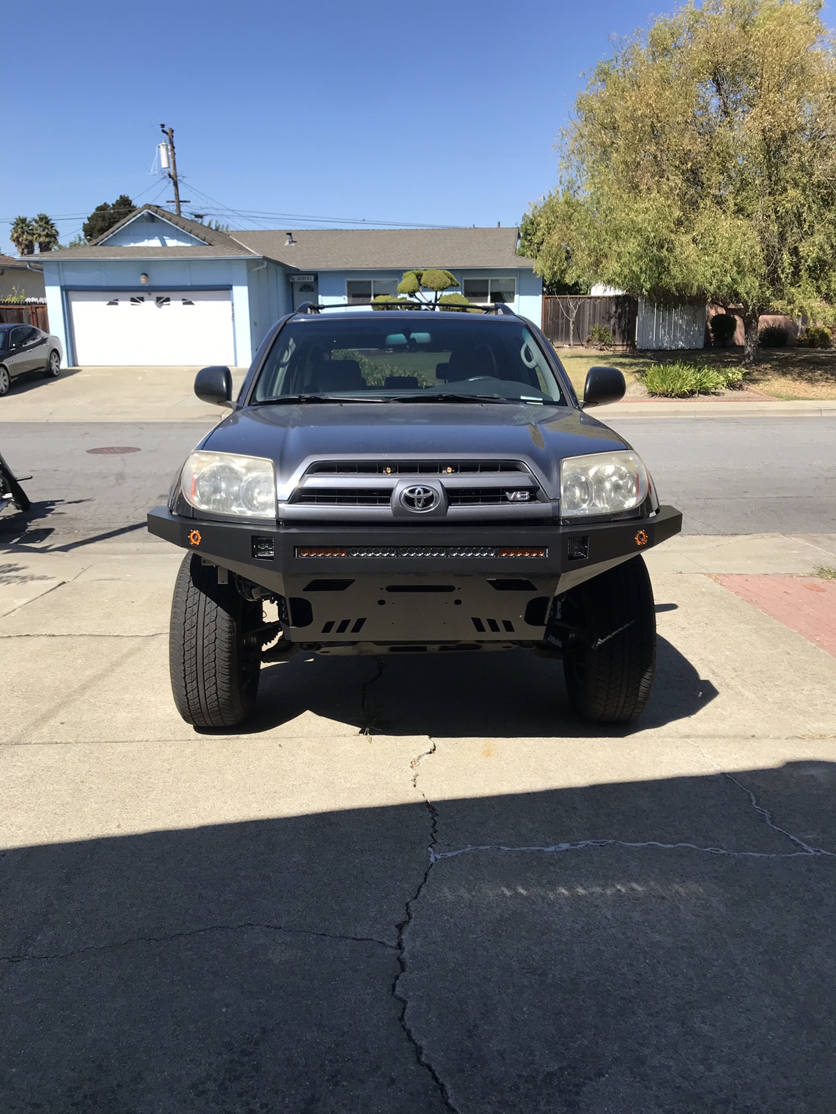

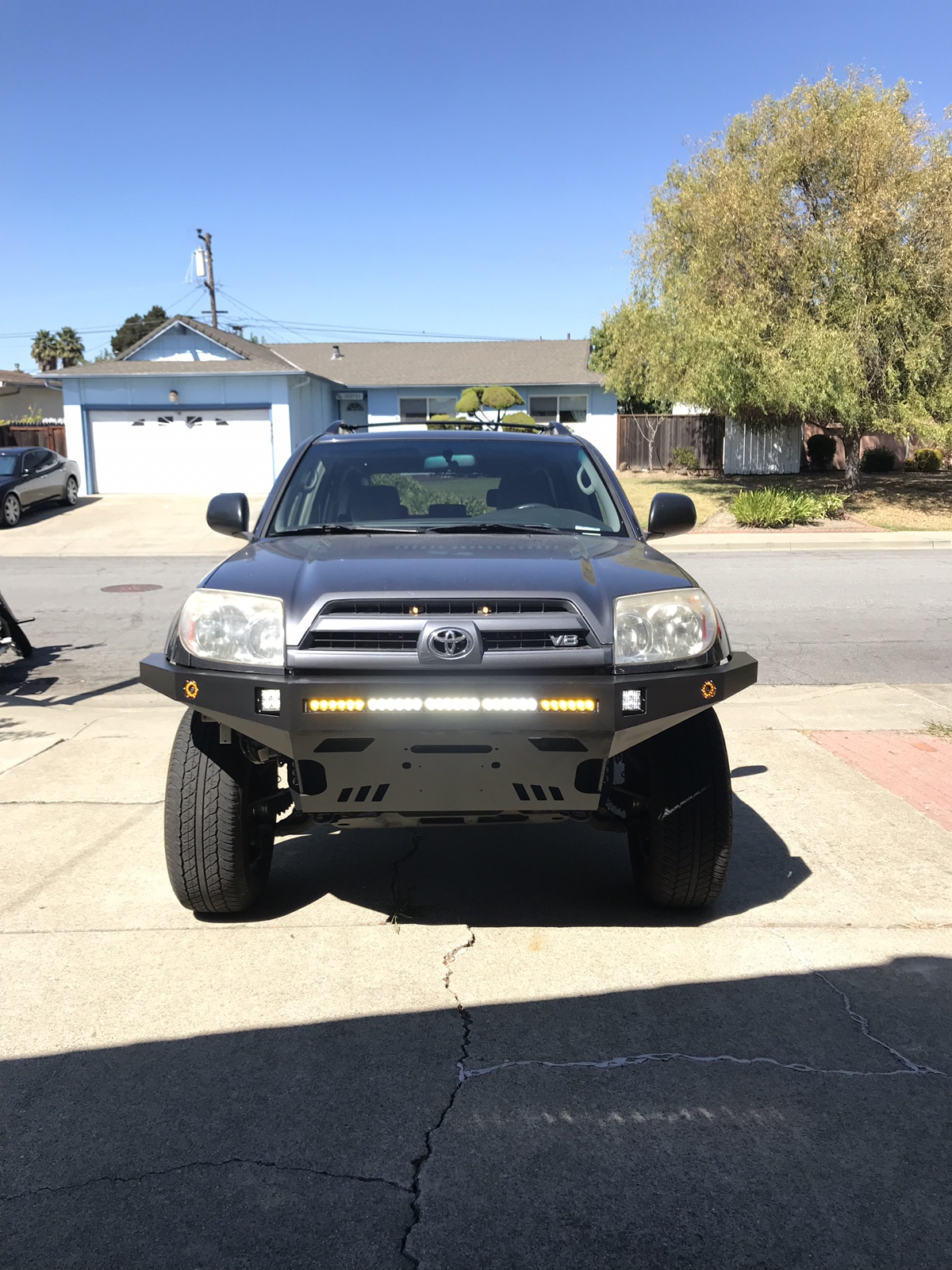

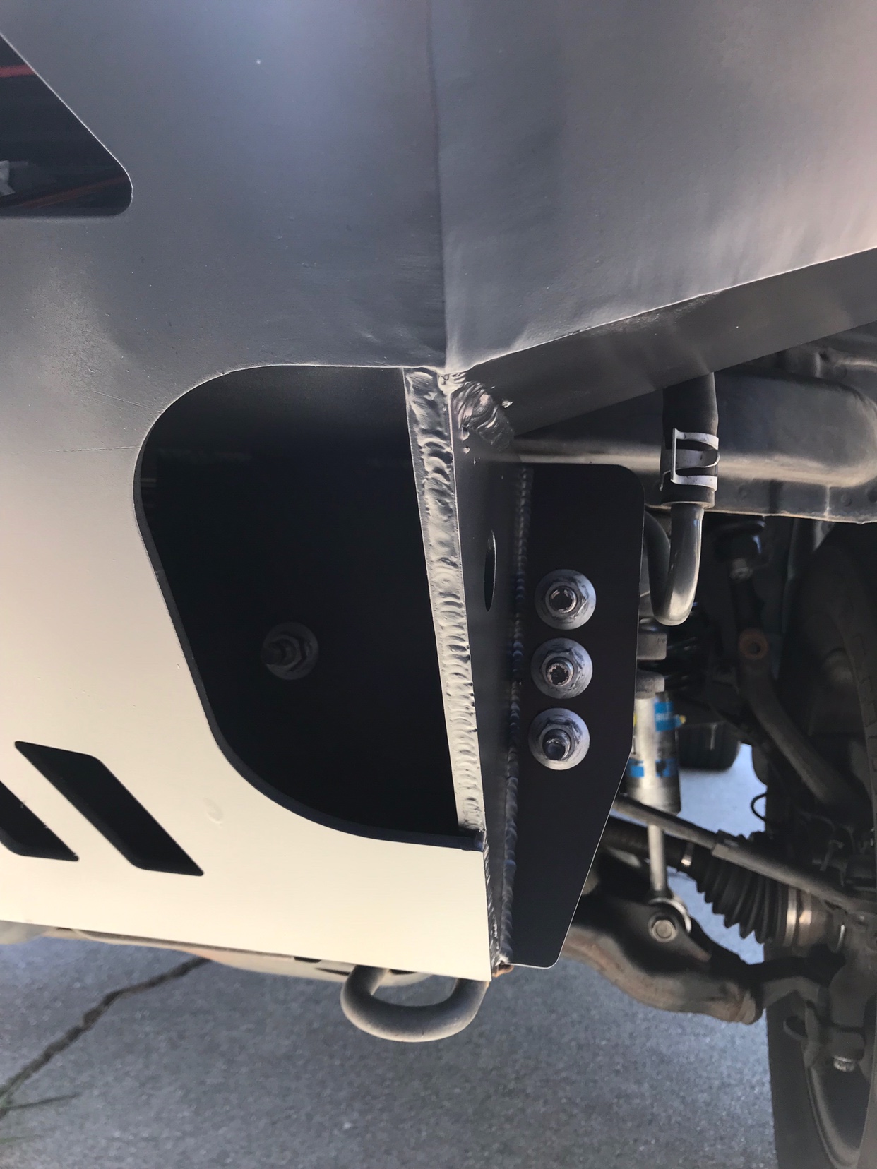

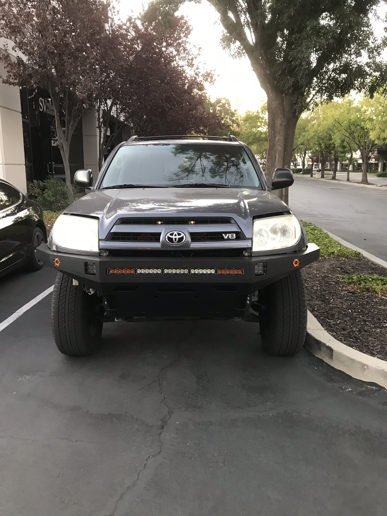

Finalized my front end.
Went through 3 cans of Steel-It. I highly recommend it over Bed liner. It is pretty tough and it hasn’t even fully cured. I personally did not want to go for a textured front bumper look.

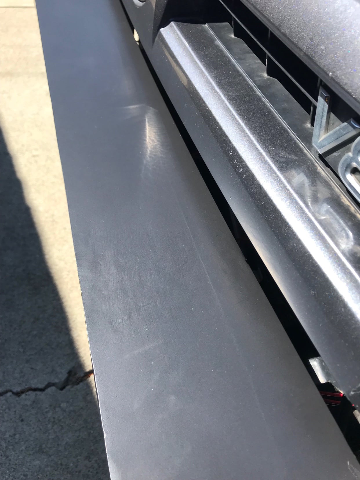

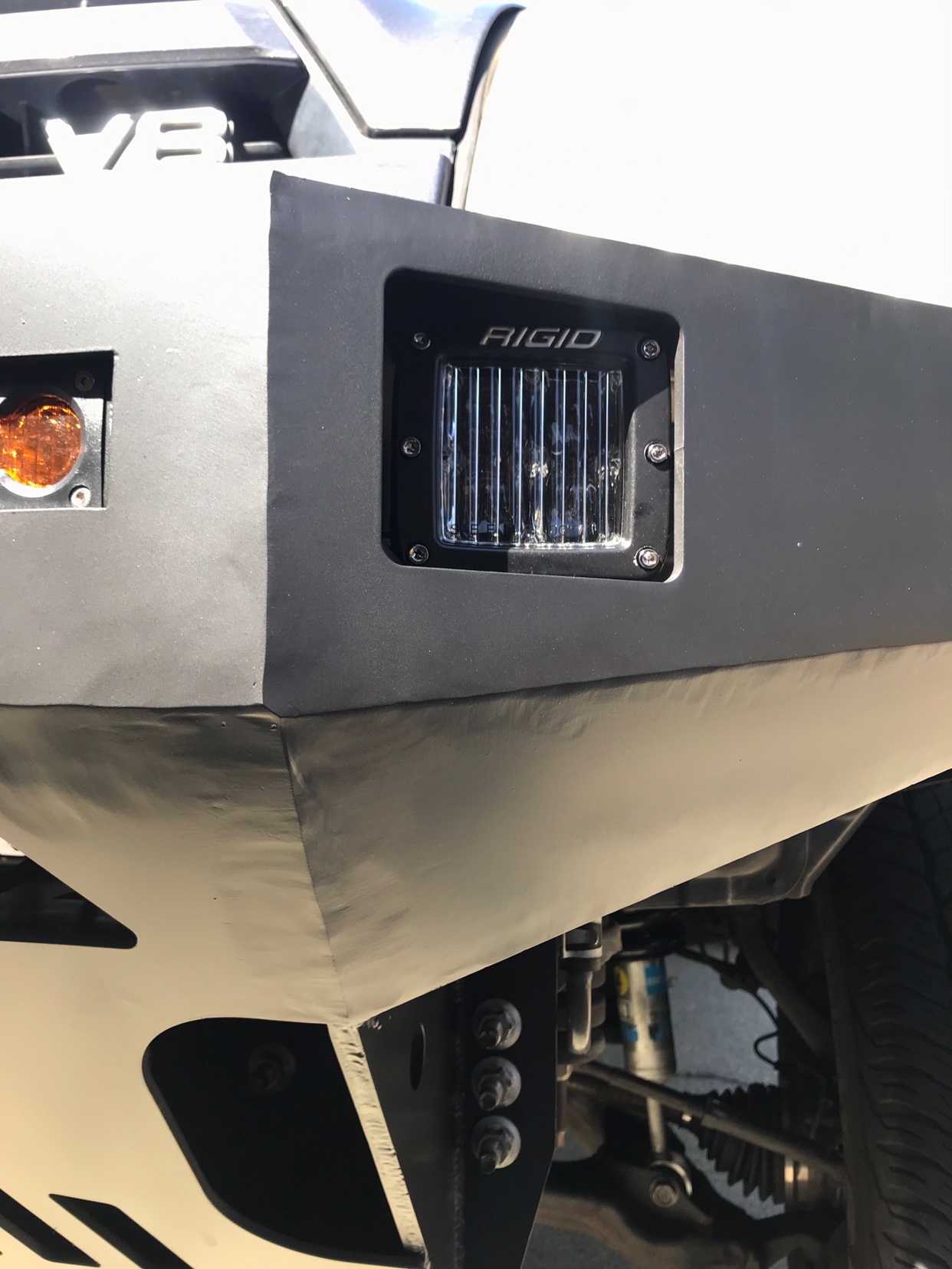

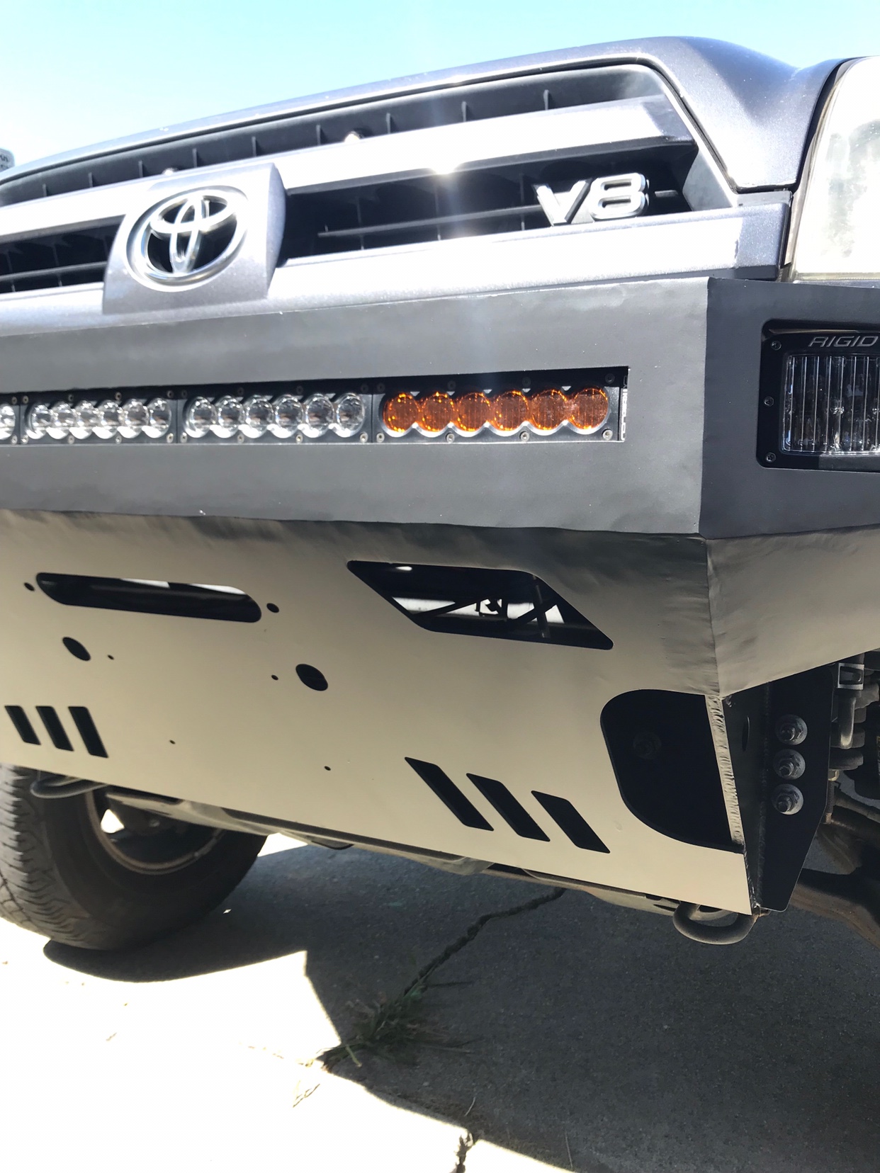

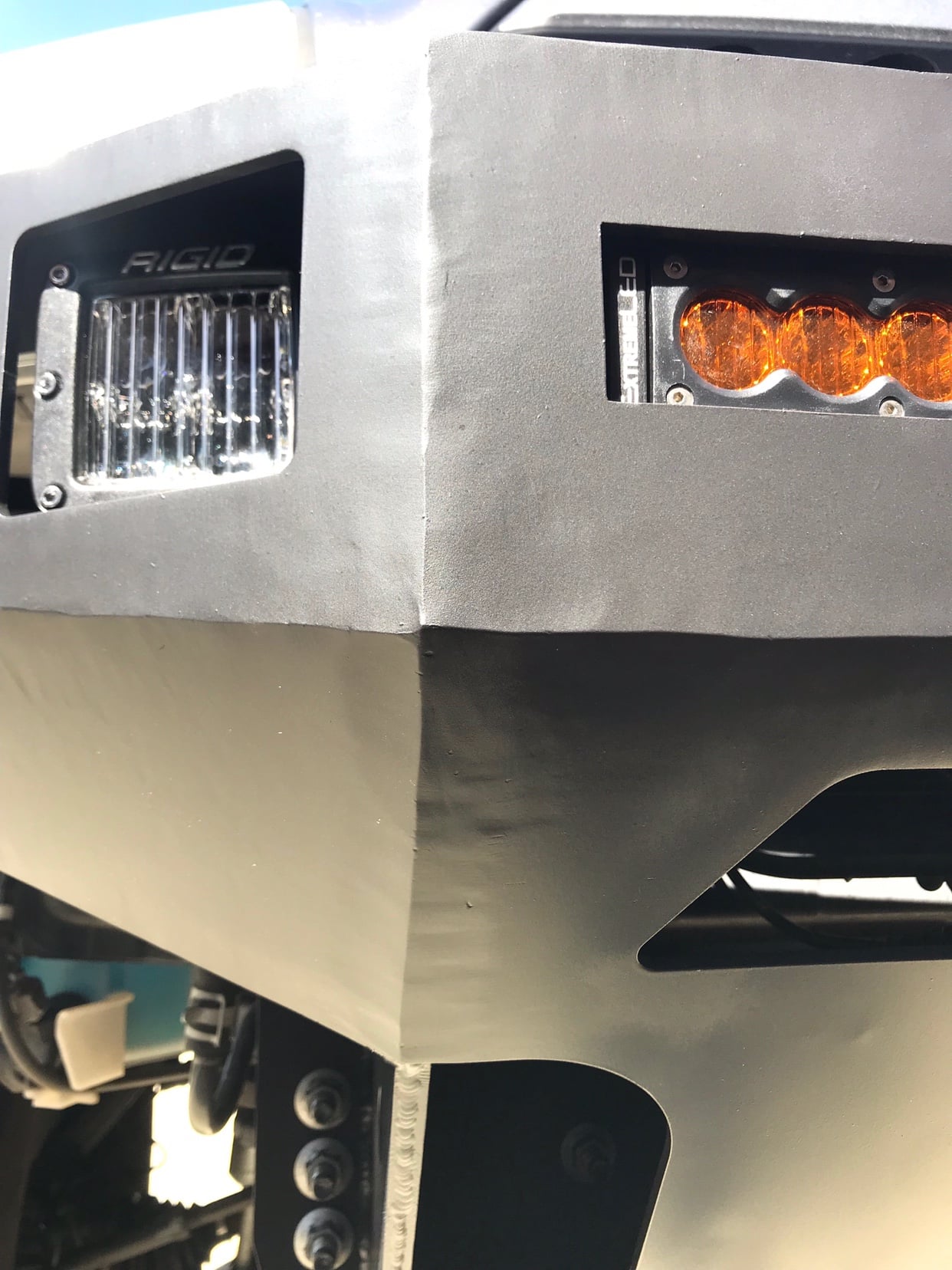

You have close-up pictures? I'm not a huge fan of the textured look either, so am super interested in that stuff for skids/bumpers/sliders
Ill take some later today. You see every little grind imperfection or weld spatter. If you make sure to clean up the piece well even imperfections will look fine.
I went with Steel-It because it was cheaper than powder coat and you can weld right through it. If it gets a bunch of heat it bubbles but touch up is easy.
The product is solid. It is super tough and withstands rocks pelting it at highway speeds. As mentioned before you can see every imperfection of my grind job. I'm not unhappy with the result as it's my first plate bumper but if I took more time it could have been a bit better.

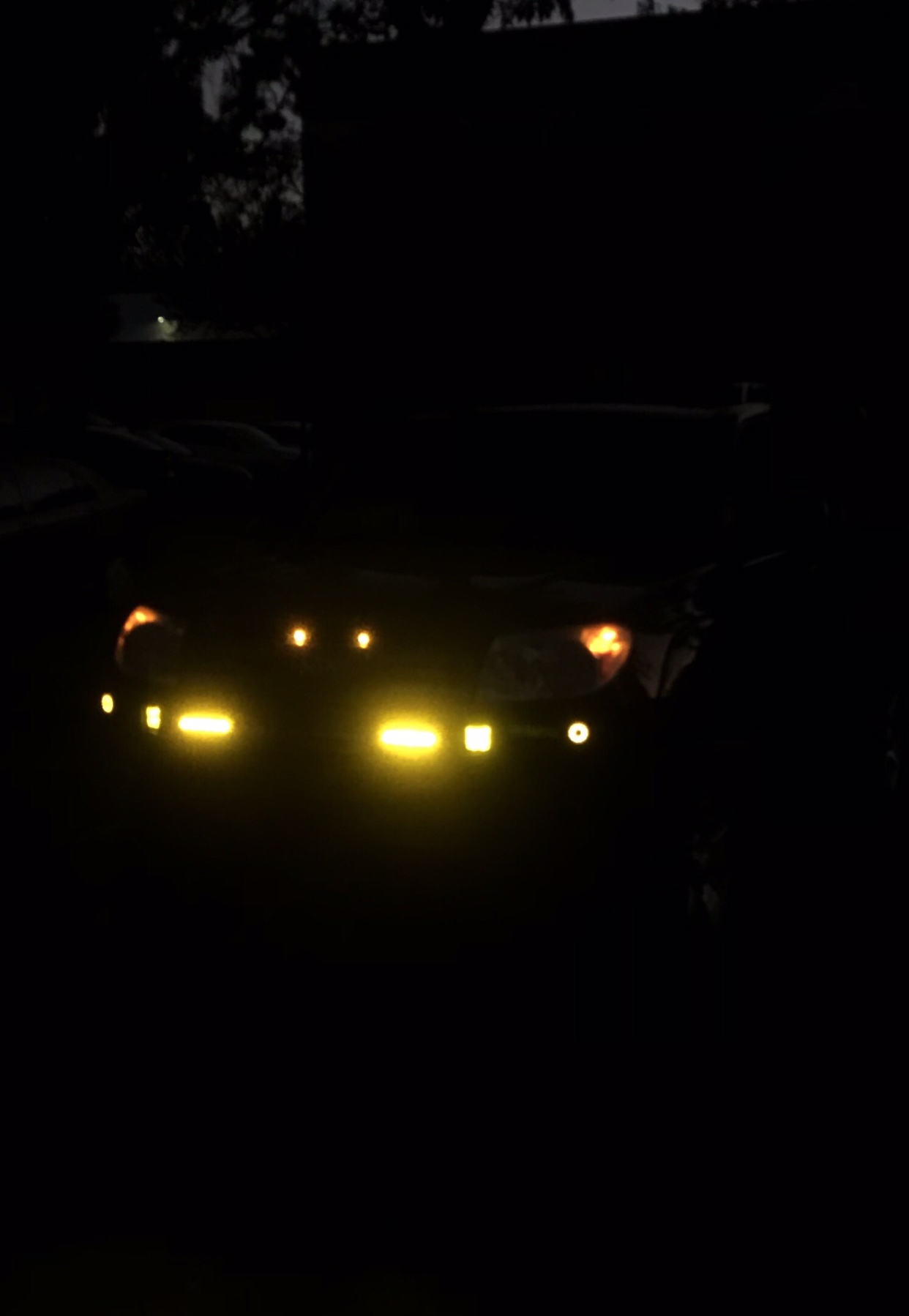

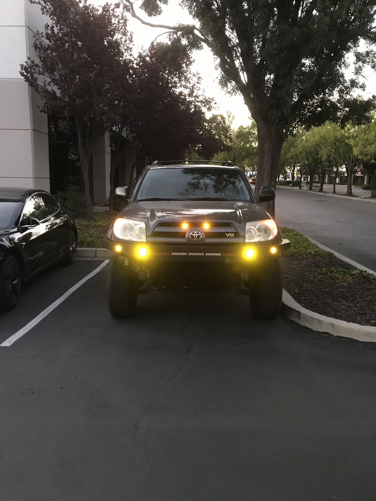

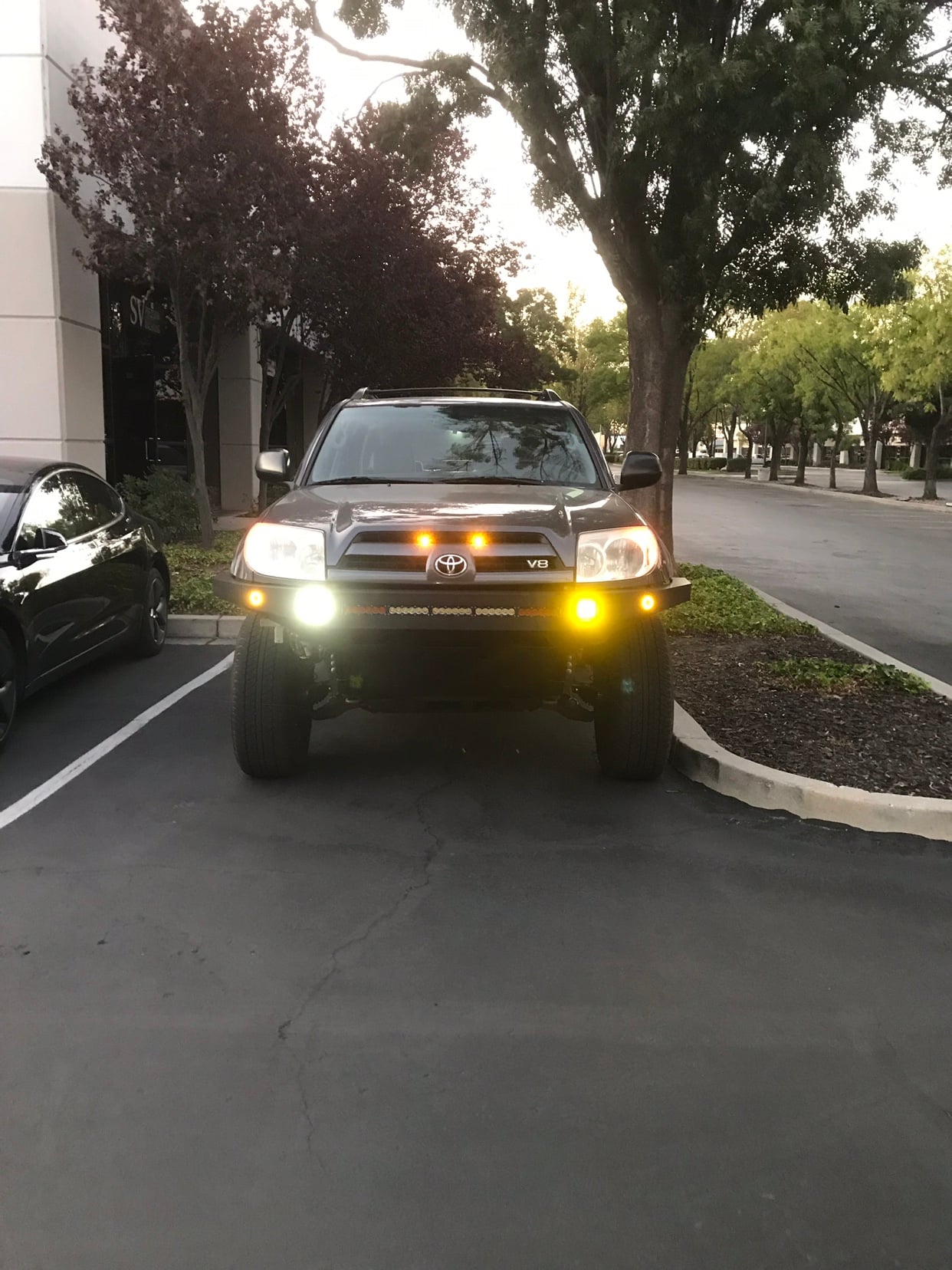

Played around with Amber light covers and did the fog light mod.
I broke the tab off on accident but soldered it on.

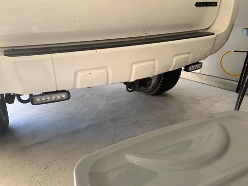

Added auxiliary reverse lighting, I feel like I can never see back there even with upgraded LED’s. This should work.
what brand is that? im using the hella brand with the flood pattern, it works really nice.
Generic ones I bought from a guy on TW, they seem pretty bright and I got a good deal. I figure I’ll likely smash them on a trail so no need to get expensive ones until I try it out.
