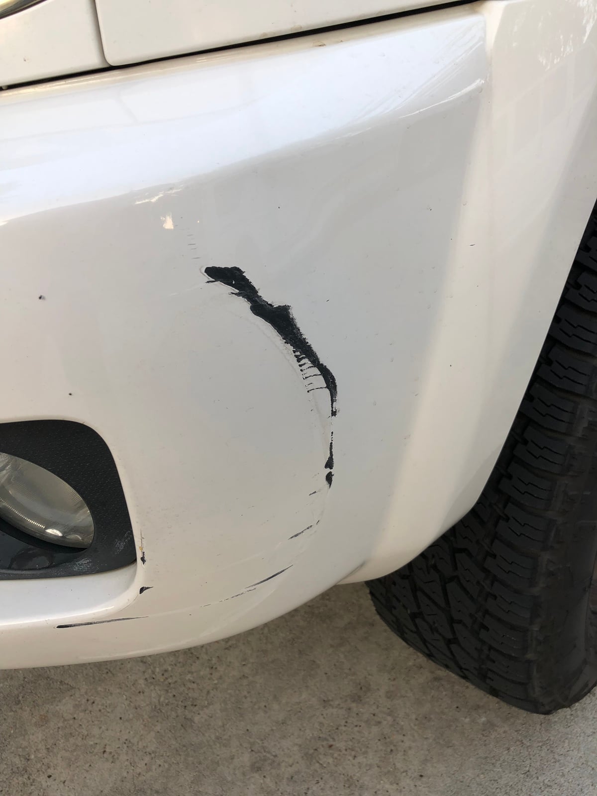

I picked up a few things over the past couple weeks that'll make it into my build thread eventually. I did get a scar on my front bumper this past Saturday morning though. What a story too, I was headed back to my parents house early morning and this dude comes out of the gas station headed the wrong way into traffic. I had to come to a stop and he's stopped right in front of my 4Runner. I couldn't reverse because there were cars behind me and he just proceeds to turn and drive his entire side of his car against my front bumper and just drives away like nothing happened. My mind was so blown from what was going on that I didn't even had the reflex to pull out my phone to record the incident. I still have to file the police report on the incident. My friend says that he can repair the damage with light sanding and spot paint fix.

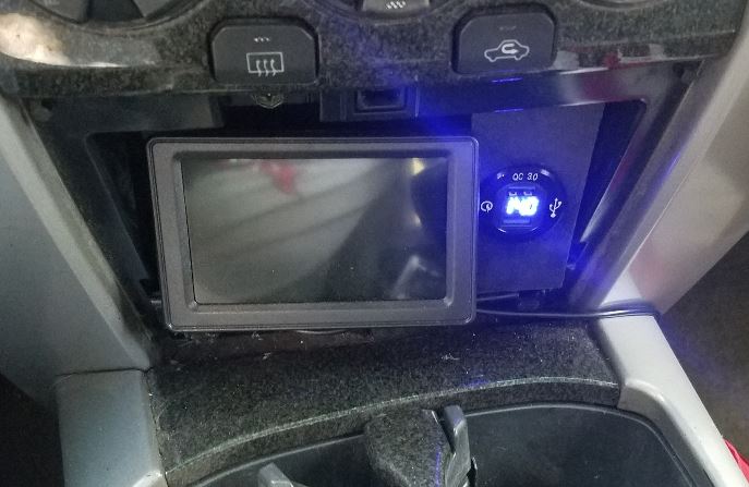

Got my LED flasher relay tonight and figured I would quickly put it in after dinner...oooh boy that was more of a knucklebuster than I thought, 45 min later I replaced the relay and tested it with my new LED Amber rear turn signals and it works! No more hyperblinking!
Now I gotta do the deep socket trick to replace the front turn signals on the driver side(passenger side is easy) but I'll do that this weekend when I do my rear diff oil.

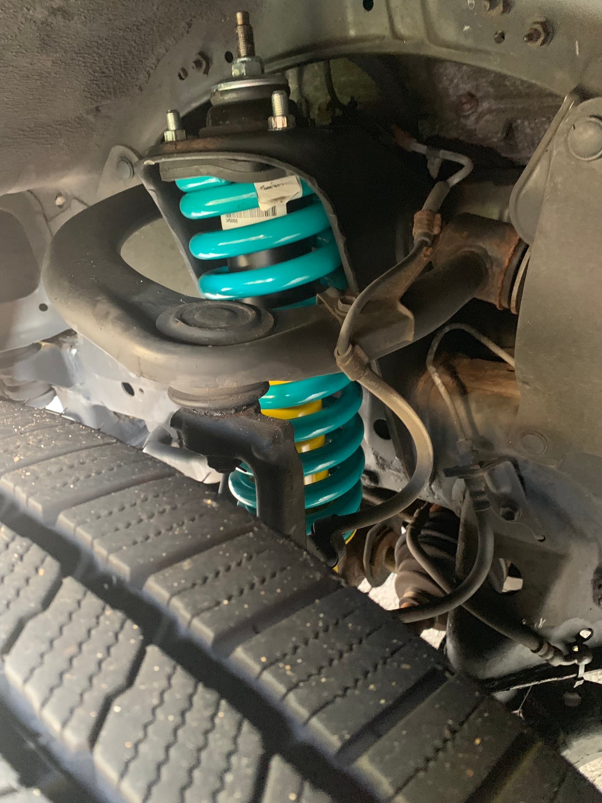

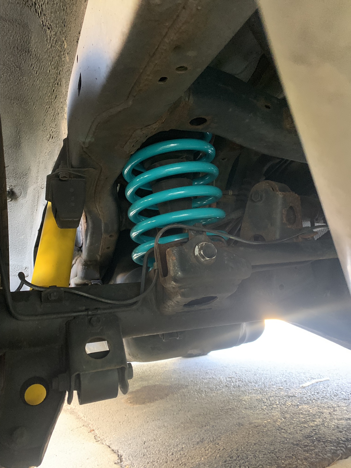

Got my Dobinsons suspension kit installed and alignment done! Total lift is about 1.5” with rake. Drives better than new! This is how it should have come from the factory.
Coils: C59-300/C59-599 w/FL 5mm spacer
Shocks: GS59-221/GS59-705
Measurements after lift:
FL: 35.4 FR: 35.5
RL: 37.0 RR 36.75
Total cost(parts/labor/alignment): $1349

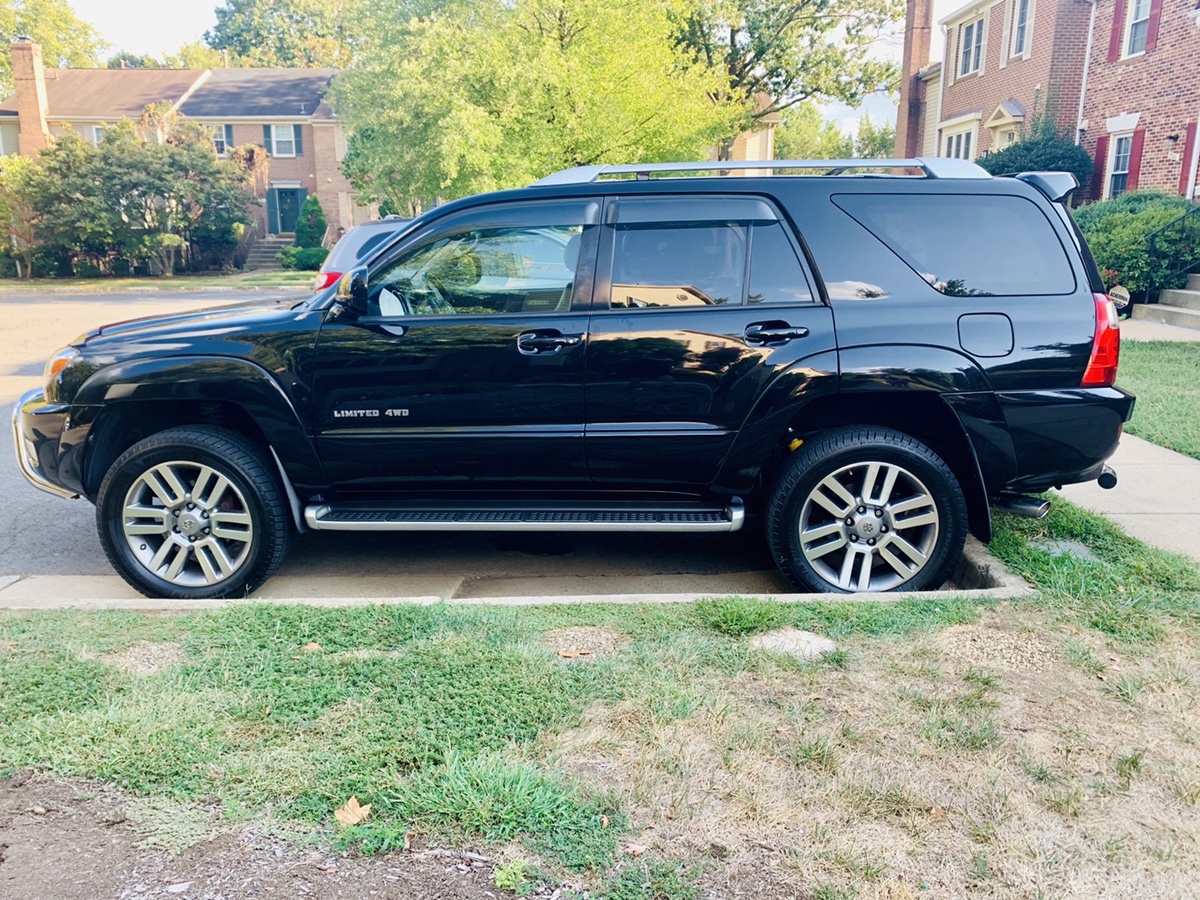

2003 4Runner Limited 4WD V8, Black

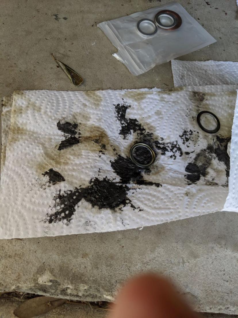

Coolant flush and filled with Toyota super long life pink fluid. Noticed car was pulling a bit to the right(even though I got a 4 wheel alignment and new tires) after doing a test drive with the tech, they simply crossed the front wheels and that fixed it. Both were done at the Toyota dealership.
Today:
Diff service with Mobil 1 full synthetic gear oil. It was obvious that the fluid was probably never changed, it was very dark and there was a lot of fine deposits on the drain plug. No shinies in the oil or chunks of metal however. Had to use a lot of PB Blaster and a cheater bar to get the damn fill plug off. Next up is replacing my front turn signals and HVAC bulbs with LEDs, those should be in today!
