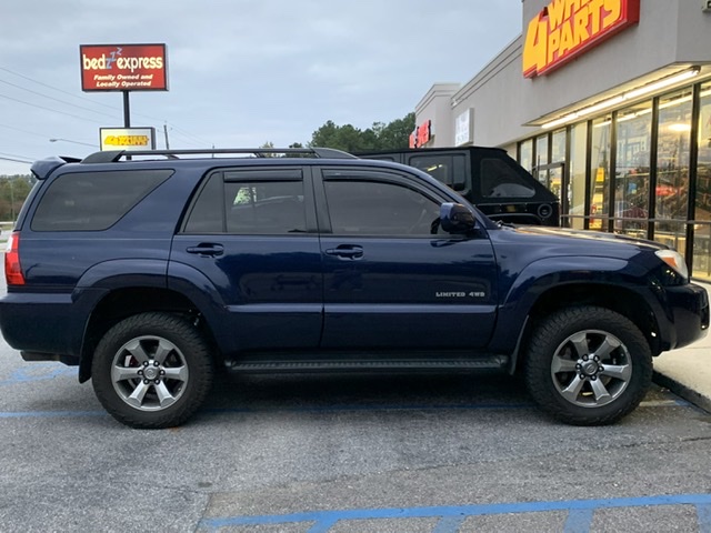

I am finally completing my planned “upgrades” to my 2006 4WD Limited that I purchased with 200K miles!!!
I have put right at 20k since purchase and in that time I replaced one O2 sensor on the drivers side to clear the infamous “Cat not operating efficiently” code and haven’t seen it since ;-). Next I replaced the worn out street tires with a set of Falken Wildpeak AT3W 265/60R18’s. (Since then I have put these on my other 2 4Runners and I love these tires!!! Then I got industrious and replaced my front and rear rotors with the PowerStop Z23 kits and new shoes on the parking brake too.
That gets us to today and my afternoon at 4WParts ;-).
Finally my 5100’s were installed with the fronts set on the top ring 2.5” and the B12 1.5” lift springs from Bilstein. At the same time I had them install a set of Toyota remanufactured front axels from Cardone via Rock Auto. Shafts cost $124 delivered to my door and arrived in only 3 days!! Let’s hear it for Rock Auto!!!
For now I am still running the original front springs but that may eventually ;-) Prior to installation I measured from the ground to the bottom of the fender openings and front was 33” and rear 35”. With the 5100’s and rear springs it is now 36.25” front and 37” rear. FWIW measuring from pavement to top side of the running board is right at 16” front and rear. Exactly what I was expecting to see. It drives incredibly! I doubt it felt this good brand new ;-)

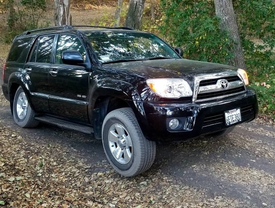

I got it six days ago and it's bone stock. No reason not to take it out, so it saw dirt for probably the first time. Are the traction aids and DAC supposed to be that loud? Whoa.

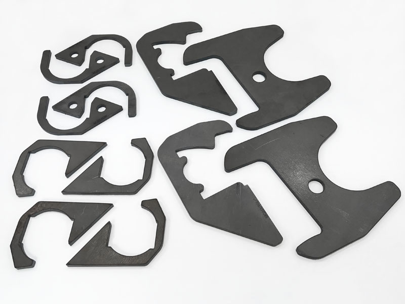

The alignment cam could be moved around easily and the bolt was loose. The cam tab seems to have been flattened by something, so I beat on it a bit to try to get it back to where it'd at least hold the cam. Any suggestions??
There are these now too.
HD LCA Frame Brace, 2003-2009 4Runner | Marlin Crawler, Inc.

Goodness either your rear suspension is shot or the photo was taken at a weird angle.... would be surprised if the rear shocks didn't blow on stock bump stops. I don't have DAC on my SR5 but my VSC and ABS will beep loudly if I get into sticky situations or if I loose too much traction.
It was at a weird angle with two opposing corners on mounds. I was trying to get it stuck to see how well the traction aids work. Aside from the beeping, there is a fairly loud banging type sound as the systems pulsate the brake. A holy crap that's loud level. I've got experience with newer electronic locking diffs and tractiin control and they seem silent by comparison.
