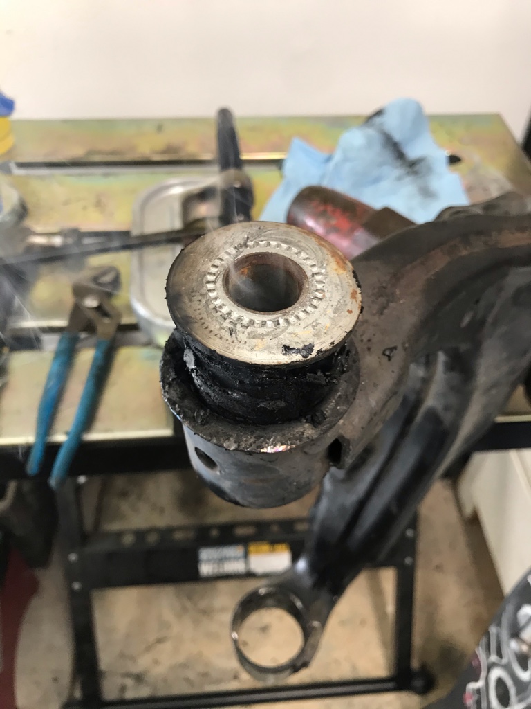

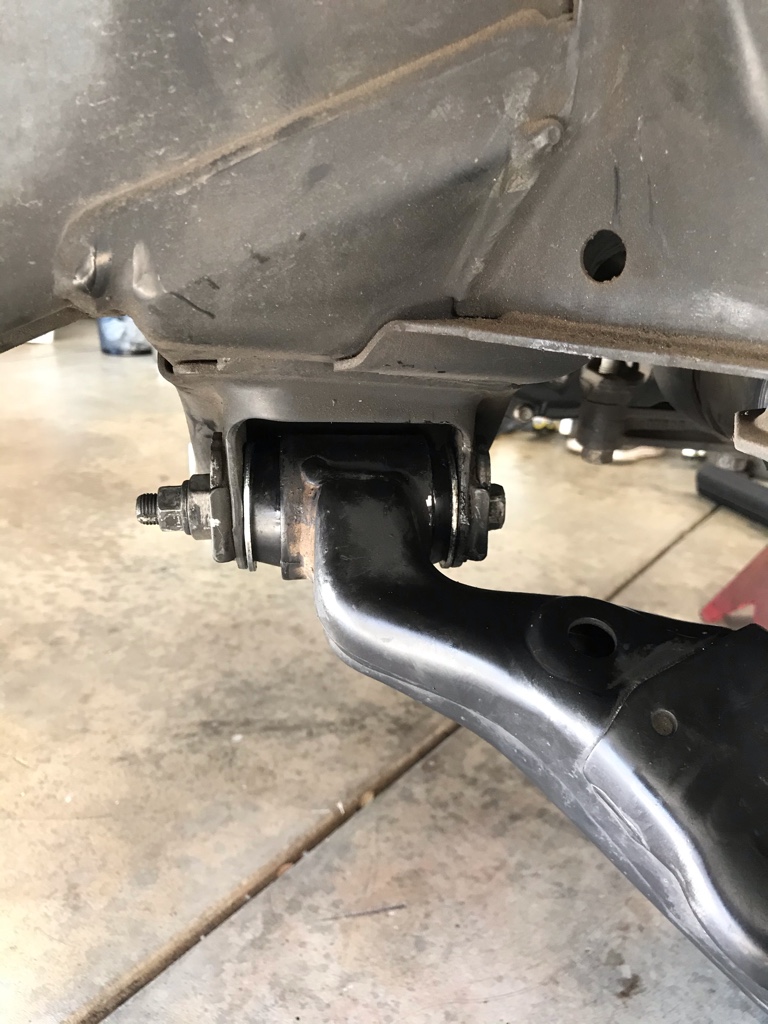

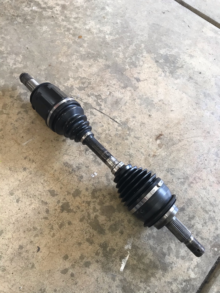

Re-booted the CVs with OEM boots. Feels good to have that done! Doing Whiteline LCA bushings tomorrow

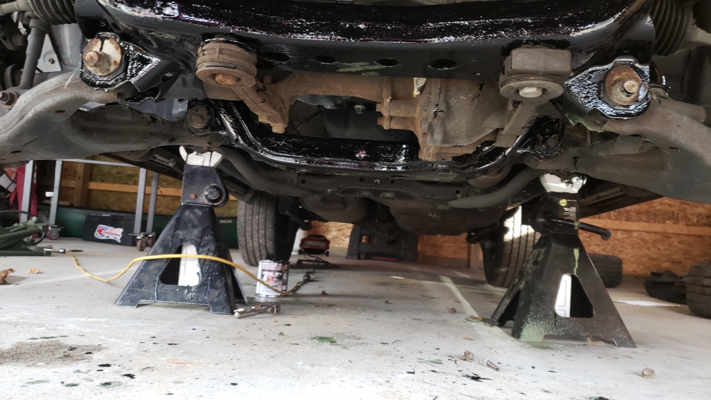

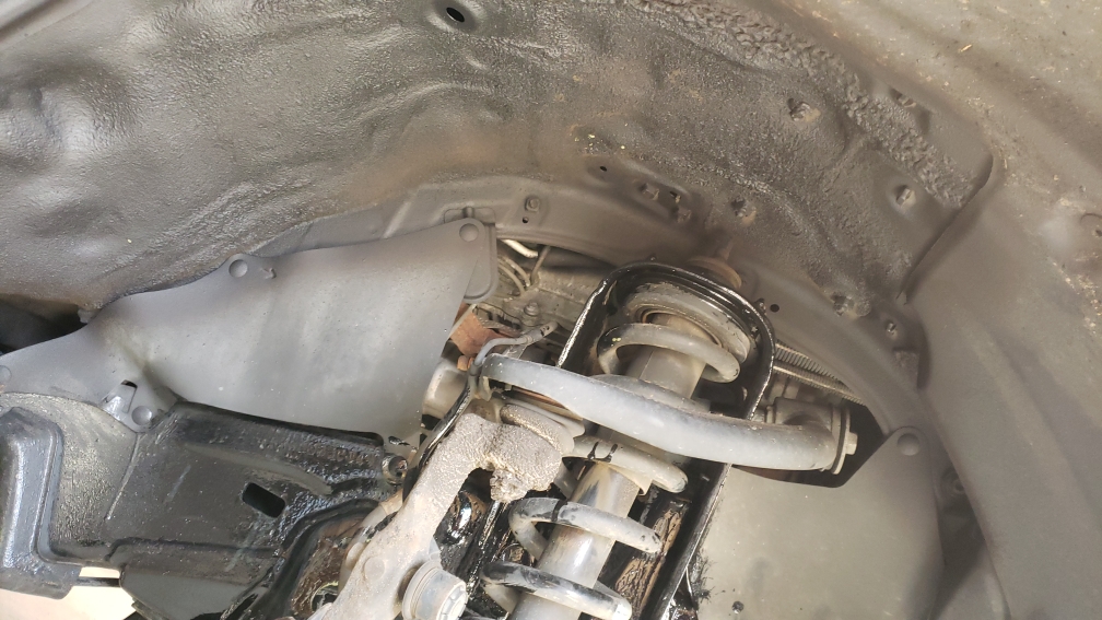

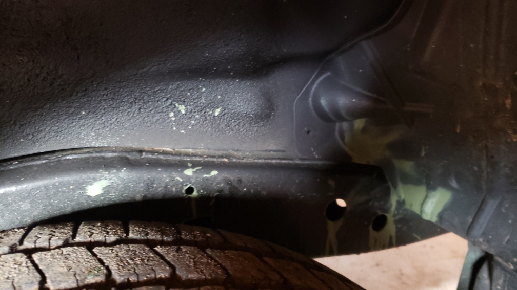

Sealed up the frame and wheel wells. Won't go into how messy and a pita this is but well worth it. I did the rear a few weeks ago.

What method are you using to replace the bushings? Any good write ups?
The only pointer I read that helped was heating up the metal around the bushing and heating/prying on them until the rubber is completely out of the sleeve. Then I took an air body saw and cut the metal sleeves in half length wise and pounded them out with a hammer and punch. Could do it quicker next time around now that I have all the tools necessary. I used my 20 ton press to install the bushings but could have made some kind of press out of all thread and some metal sleeves but the press was way easier once I figured out all the pieces to make it work.

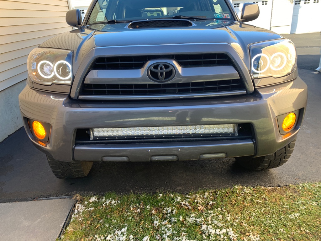

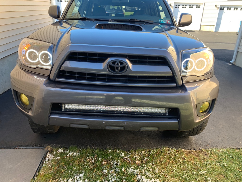

Third time, hoping, but doubtful they won’t leak-again. Love the look but the aftermarket headlights go to crap so easy. Warrantee replaces them though.
Try laying a bead of silicon all the way around where the lens meets the housing. Went through two leaking passenger sides, did that on the third, and it's finally been good for a few months.
Already tried. They don’t start leaking till a year in. So hopefully yours has success, but you’re still early into the testing. That’s why I switched brands from the second on. Same lights but a longer warrantee.

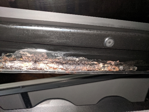

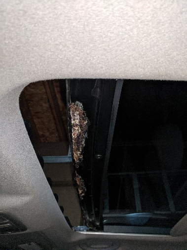

My rusty sunroof started to leak. Checked drain lines and they were clear. I concluded that the frame was rusted to the point that it wouldn't seal. We located a used roof panel and I had it installed at an interior shop. Not something I was confident in tackling. $375 out the door roof and labor.

price seems reasonable all considering and how critical it is

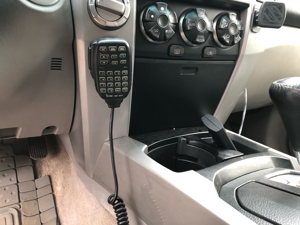

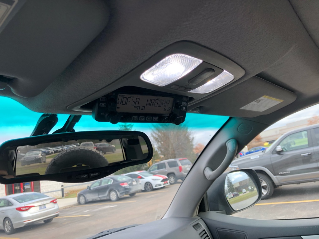

Installed my new ham radio in the “taco-holder” slot.
Mag mount for the mic.

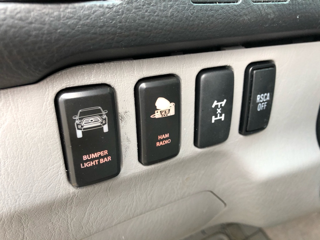

CH4x4 custom switch. Powered off ignition or this switch.

Where did you get that bumper light bar switch? Looks awesome

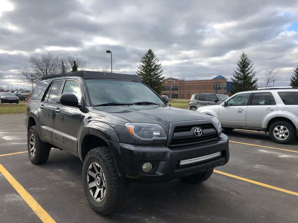

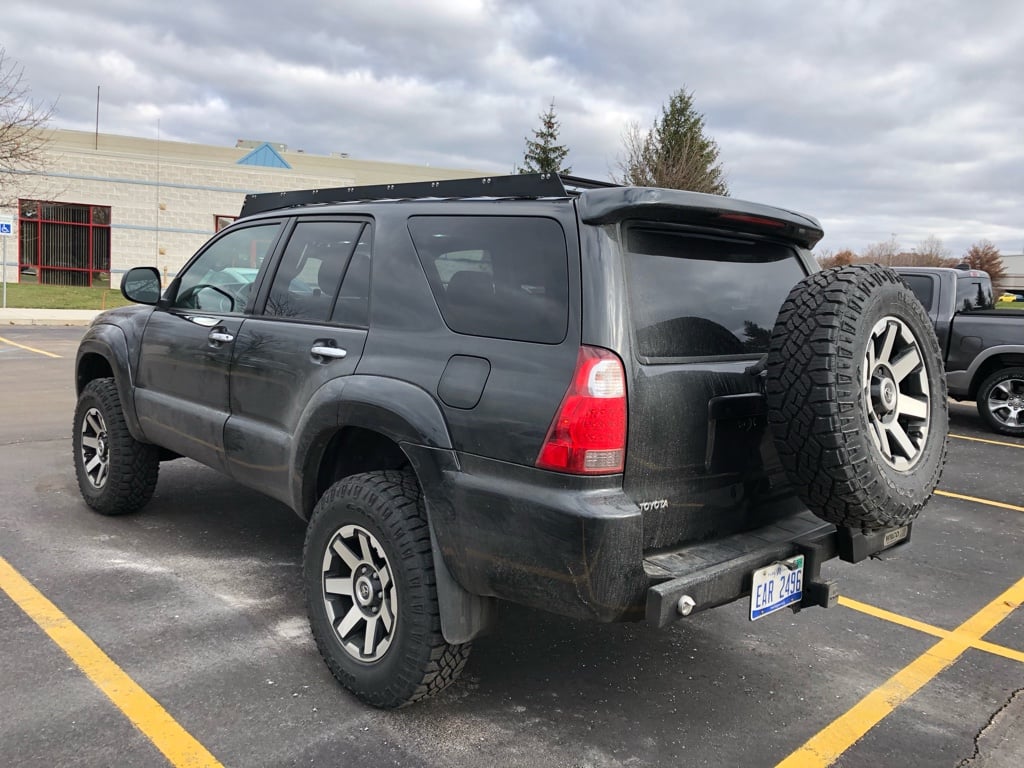

I haven't neglected the 4runner, but haven't done many changes. Did a quick interior clean and added new wipers.
I'm in need of window trim at bottom of window on driver side door and rear lift gate struts. The rear gate is slow to rise and only goes half way :(
