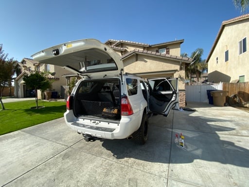

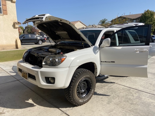

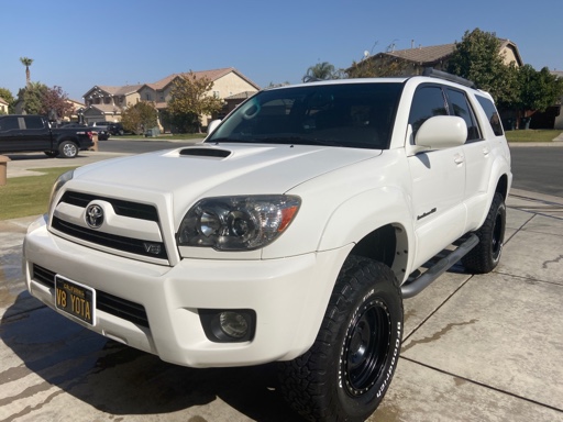

A quick wash turned into a 2 hour detailing session.Lol

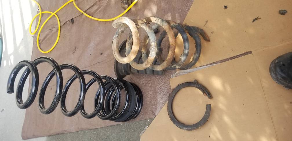

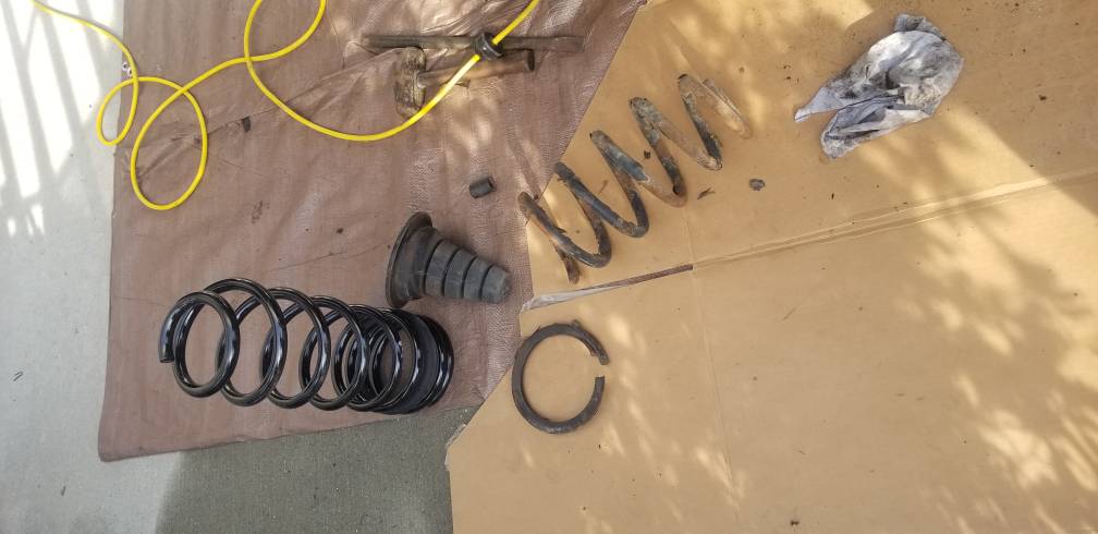

4-5 year old icon overland springs
Shot already

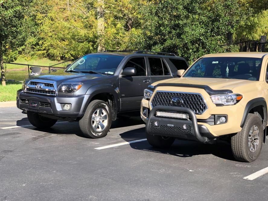

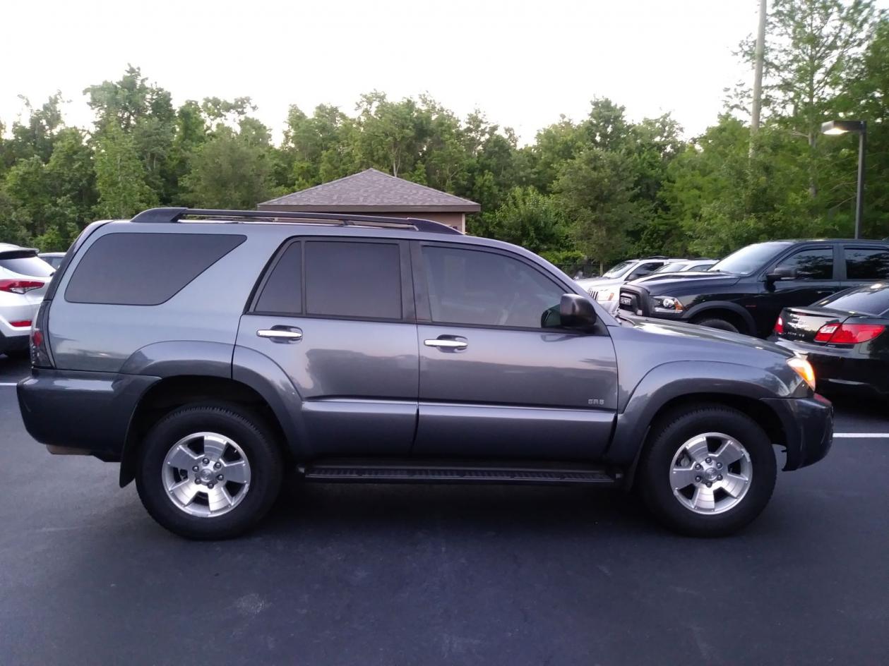

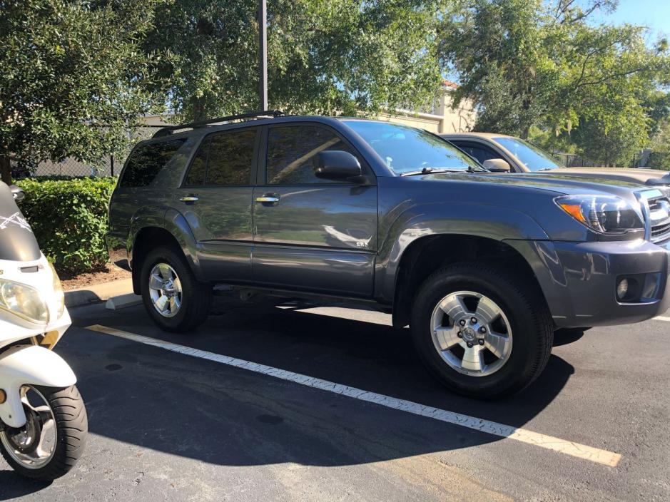

So a buddy and I installed 2016 Tacoma TRD suspension in the front of my 2006 2wd V6 today, finally! My 4Runner has almost 170k miles so I am pretty sure the stock stuff was sagging a bit, but with that being said I got right about 3.25" of lift from where it was, which gives it just a slight front rake. I have the rear Bilsteins from the Tacoma also, so I'm thinking some springs to lift it about 1" in rear would be perfect. Any suggestions? I'm thinking Bilstein B12's or Eibachs.
Here is a pic of the 4Runner originally, and now (the rake seems a bit exaggerated due to the slope of the parking spot), and now next to a neighbor's 3rd gen Tacoma TRD. Rubs a little at full-lock, and you can see some slight positive camber, so definitely needs an alignment soon, but it drives straight and smooth down the road.

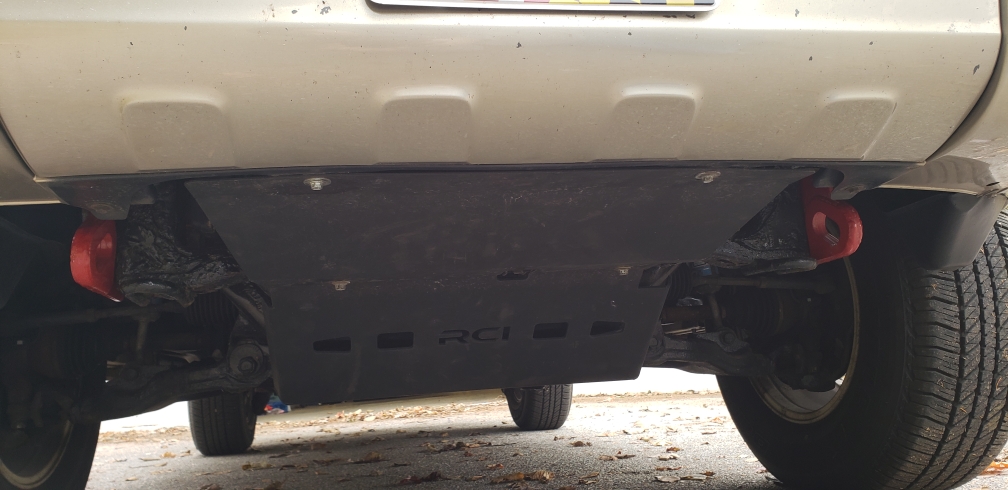

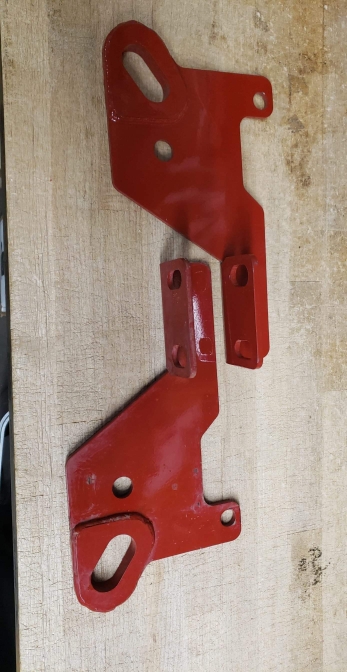

Long day.. I installed a Fumoto valve, changed the oil, installed my RCI steel skid plate, pulled off my sidesteps, replaced my leaking axle seals, extended my rear diff breather to the gas door area (stock was plugged as well), hardwired my Valentine1, pulled the second filter off the airbox, and finally installed Slyfox's SAP bypass kit (super easy, well put together), and finally dropped the spare, aired it up and lubed the pulley for it
