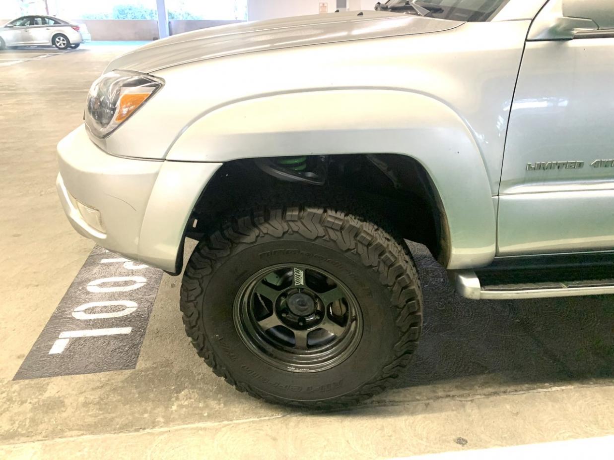

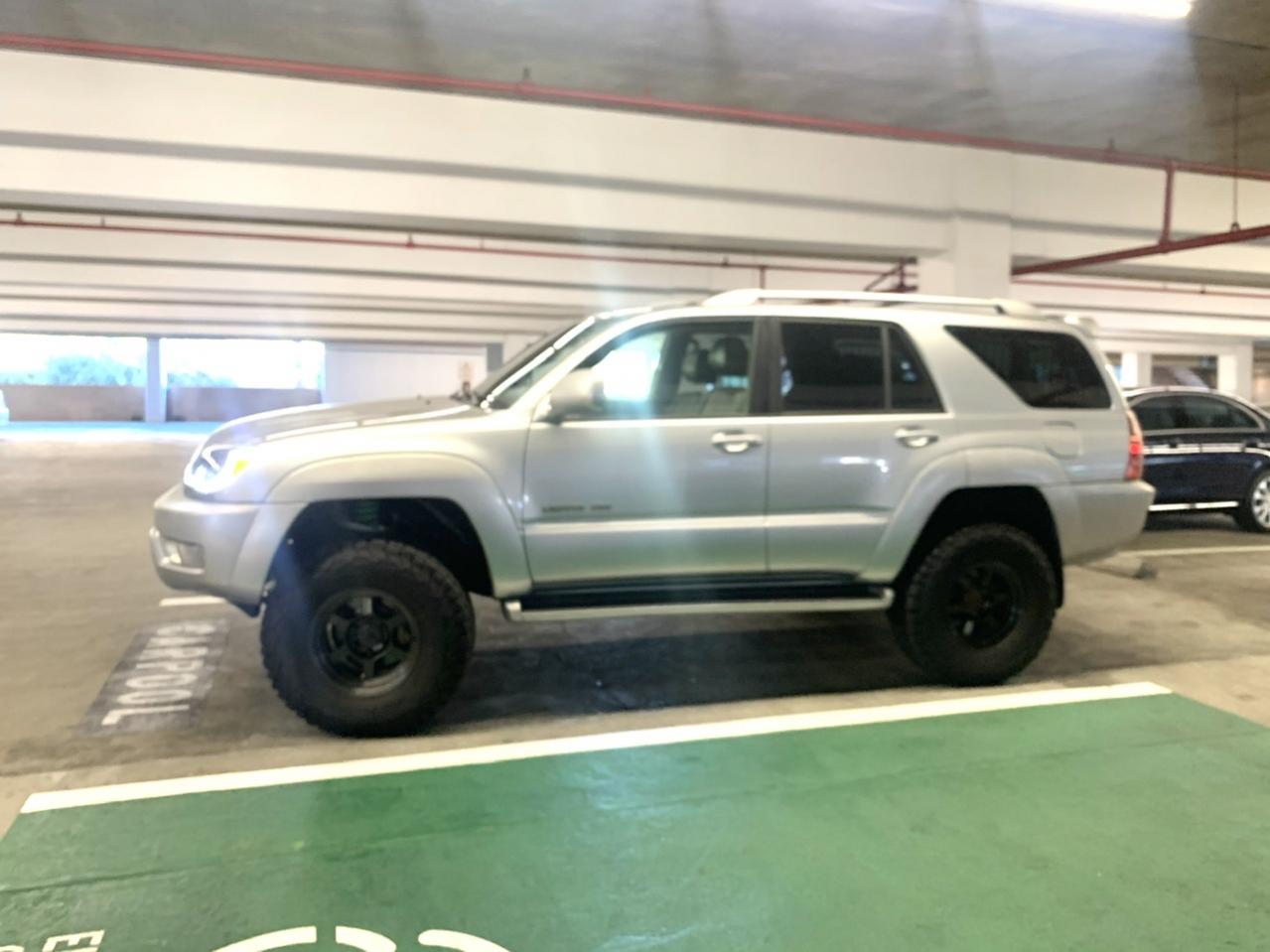

Changed out the wheels finally. I picked up a set of 2003 Sequoia wheels off Craigslist for $150. They aren't perfect, a little rash on one and some chipped paint but they are much better than the fugly stock rims IMO. Little better offset too, they stick out a little further then the other ones.
Fugly wheels.
Much better with Sequoia wheels.

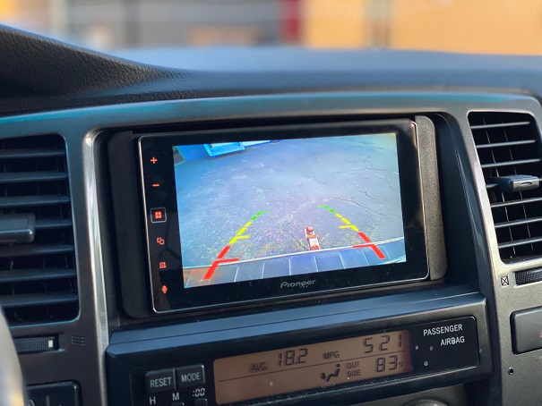

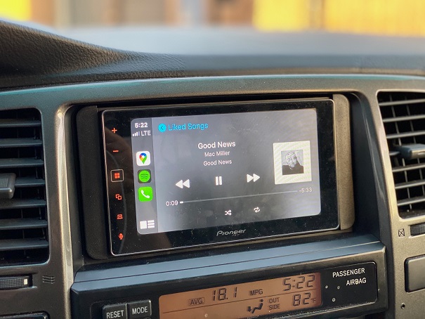

Finally got around to putting something more modern in the T4R with the following:
Pioneer MVH-1400NEX
Metra 95-8202
CRUX SWRTY-61S

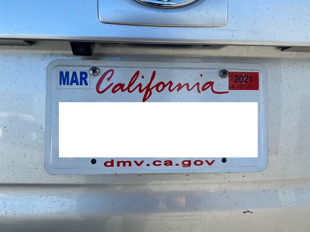

CCD Backup camera in place of the license plate light
Fugly wheels.
[MENTION=459231]xtremewlr[/MENTION], I like those wheels. Limiteds have the same larger front rotors as the Sport Edition, right? Want to be sure those wheels will work on my SE.
