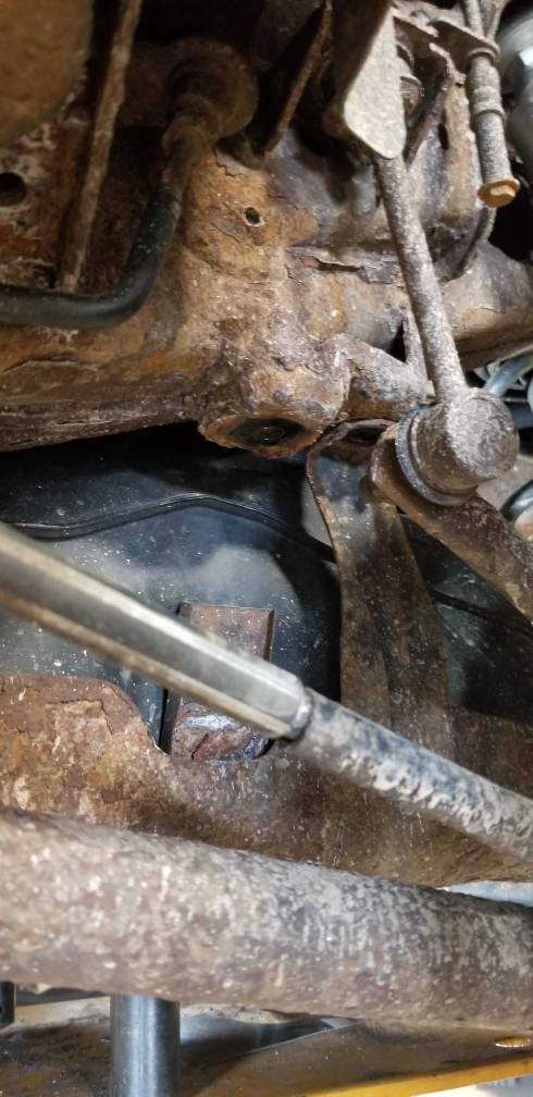

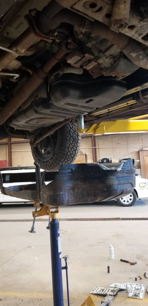

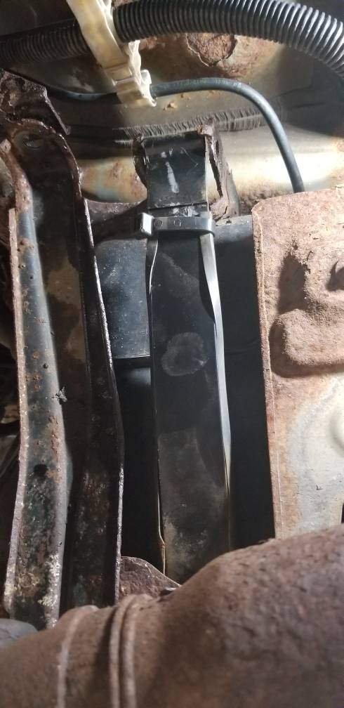

Replaced my gas tank straps. Rear was separated into 2 pieces due to rust. I was able to loosen the skid plate and snake it in. Then I dropped the skid entirely and replaced the front strap which was still intact but rusty. 20200301_114101.jpg20200301_120008.jpg20200301_125034.jpg
