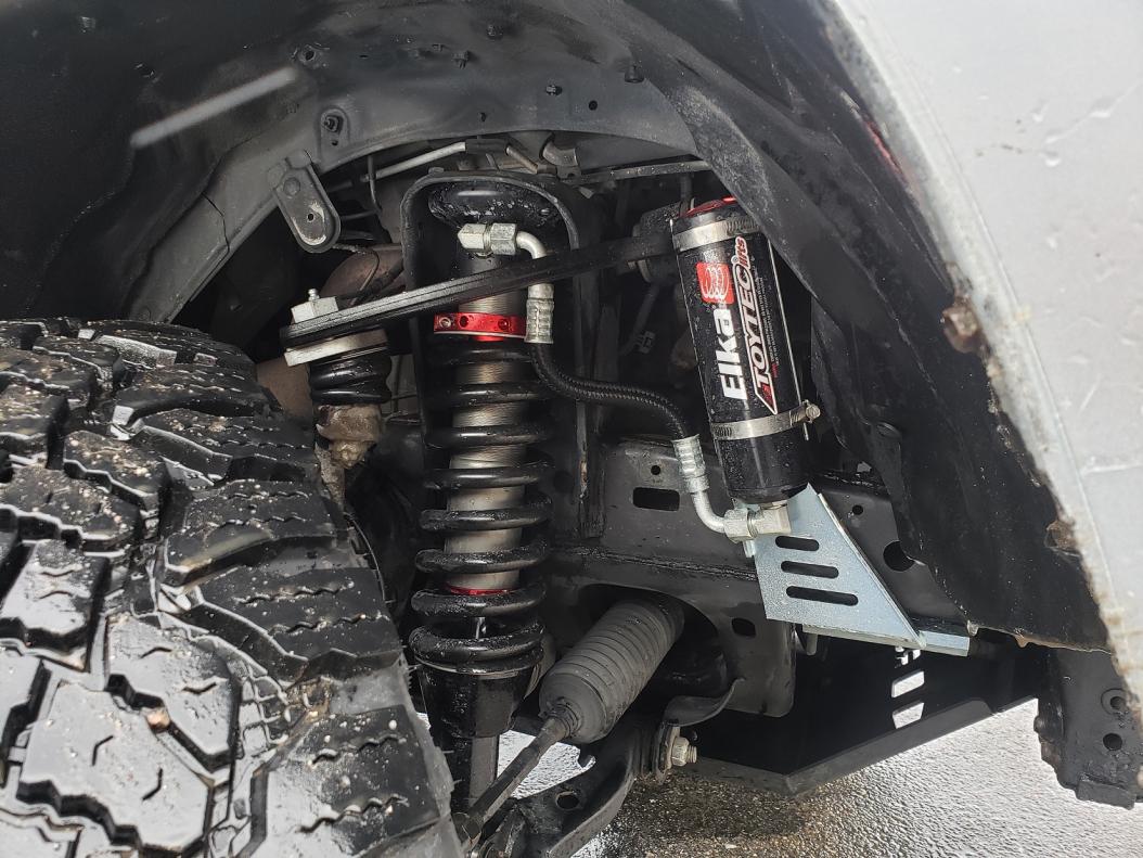

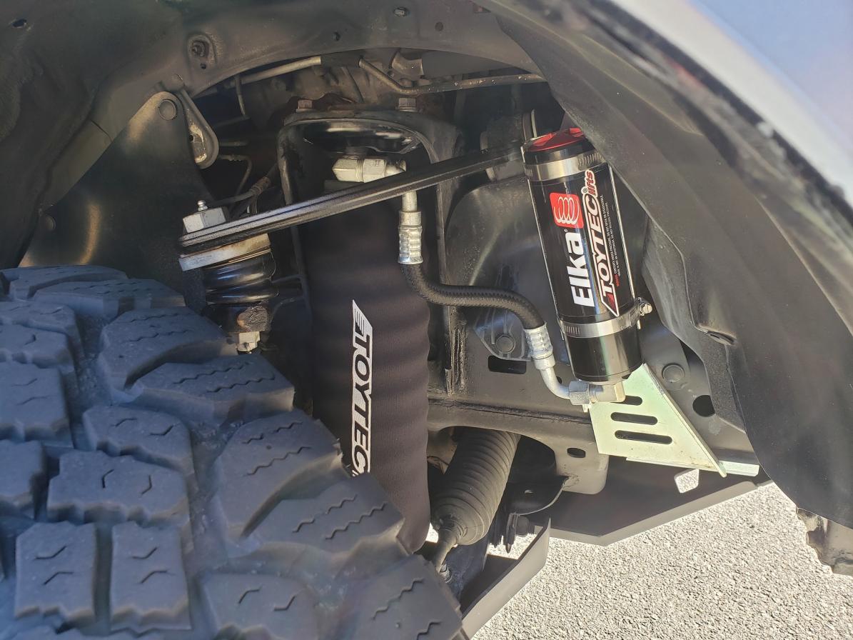

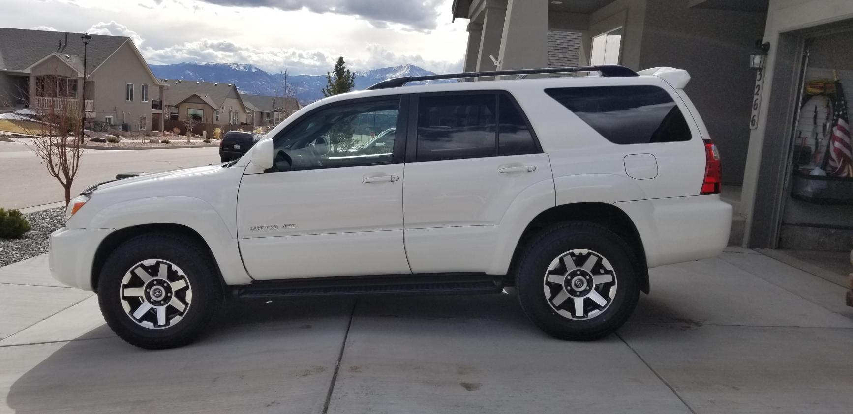

New wheels/tires
I needed new tires (soon) so I couldn't pass up this good deal on wheels and tires from a local seller.
