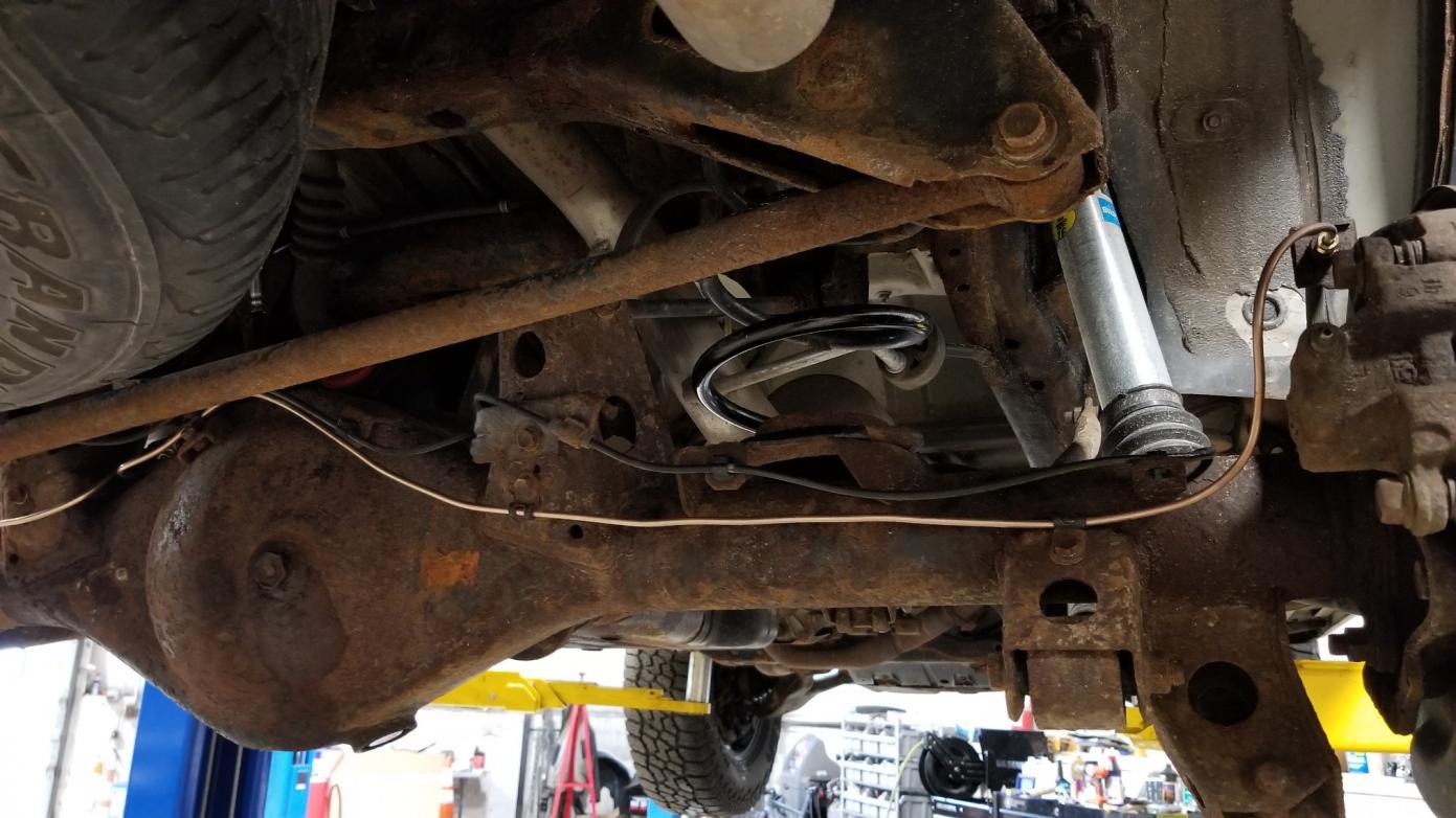

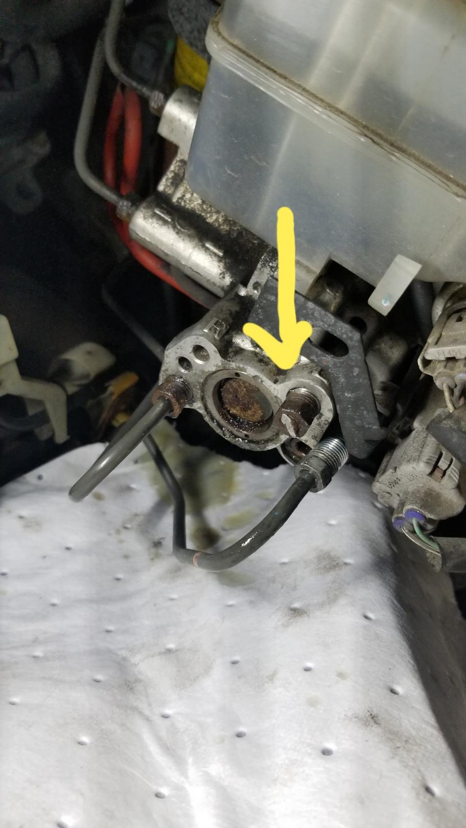

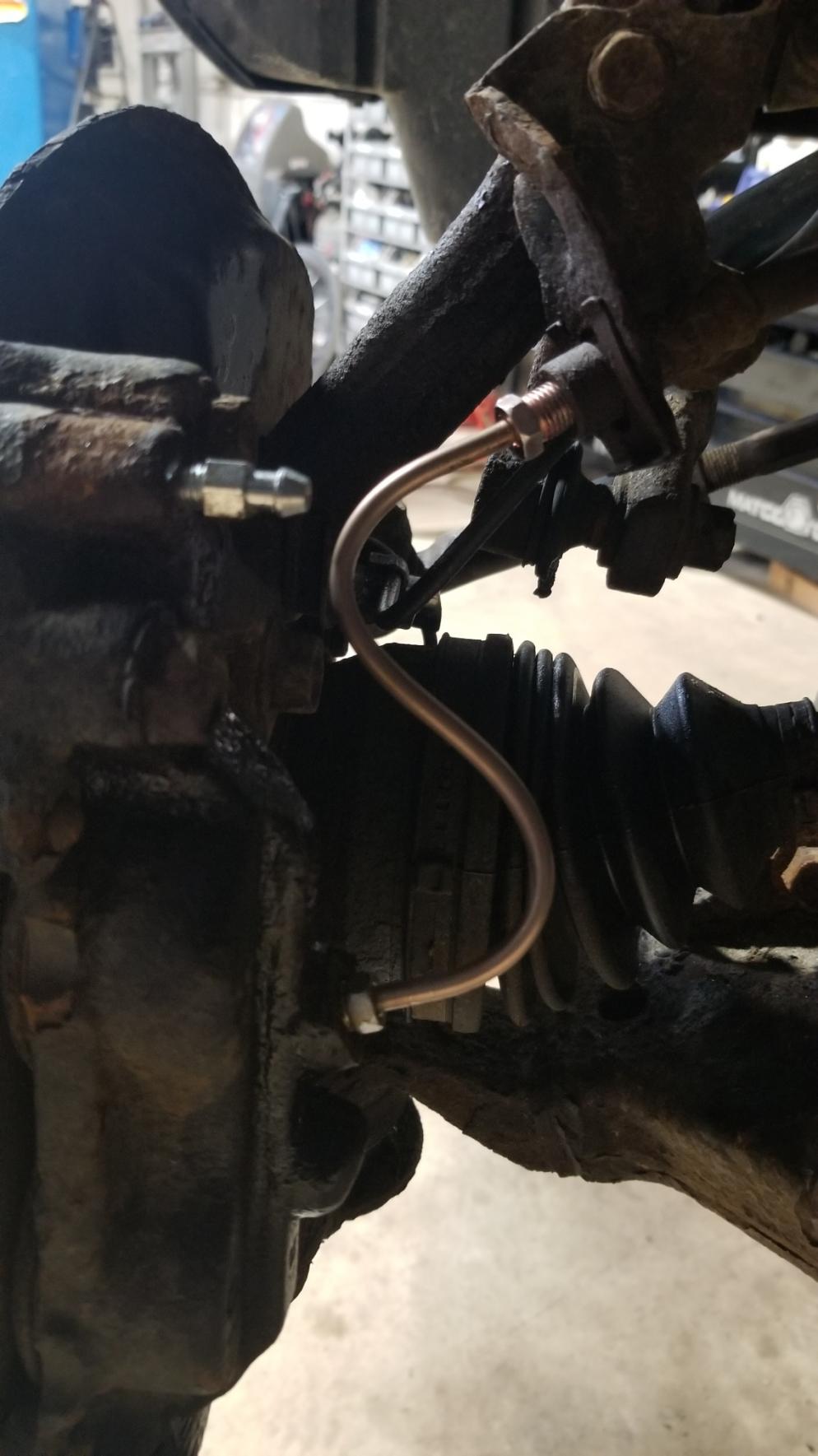

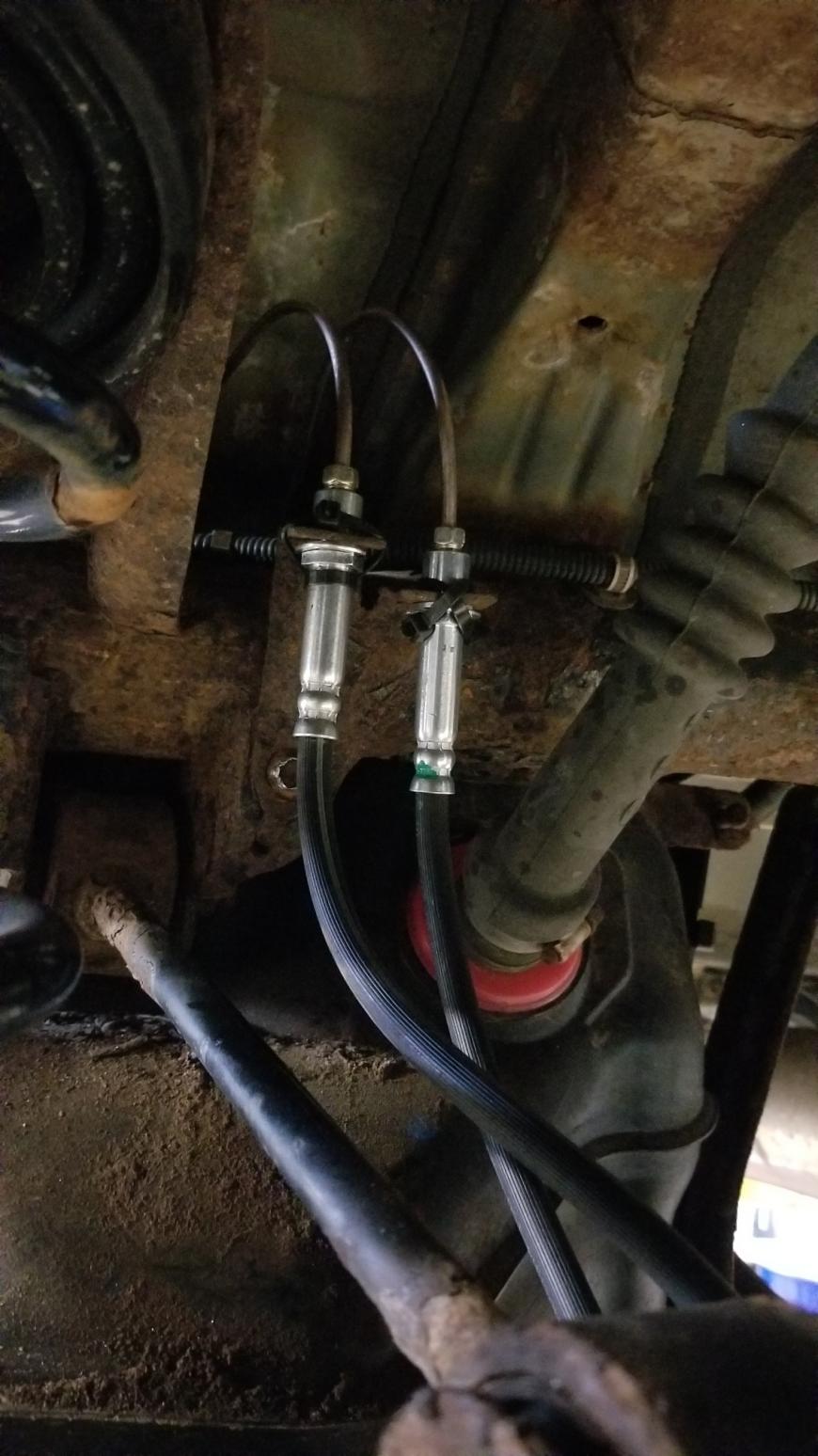

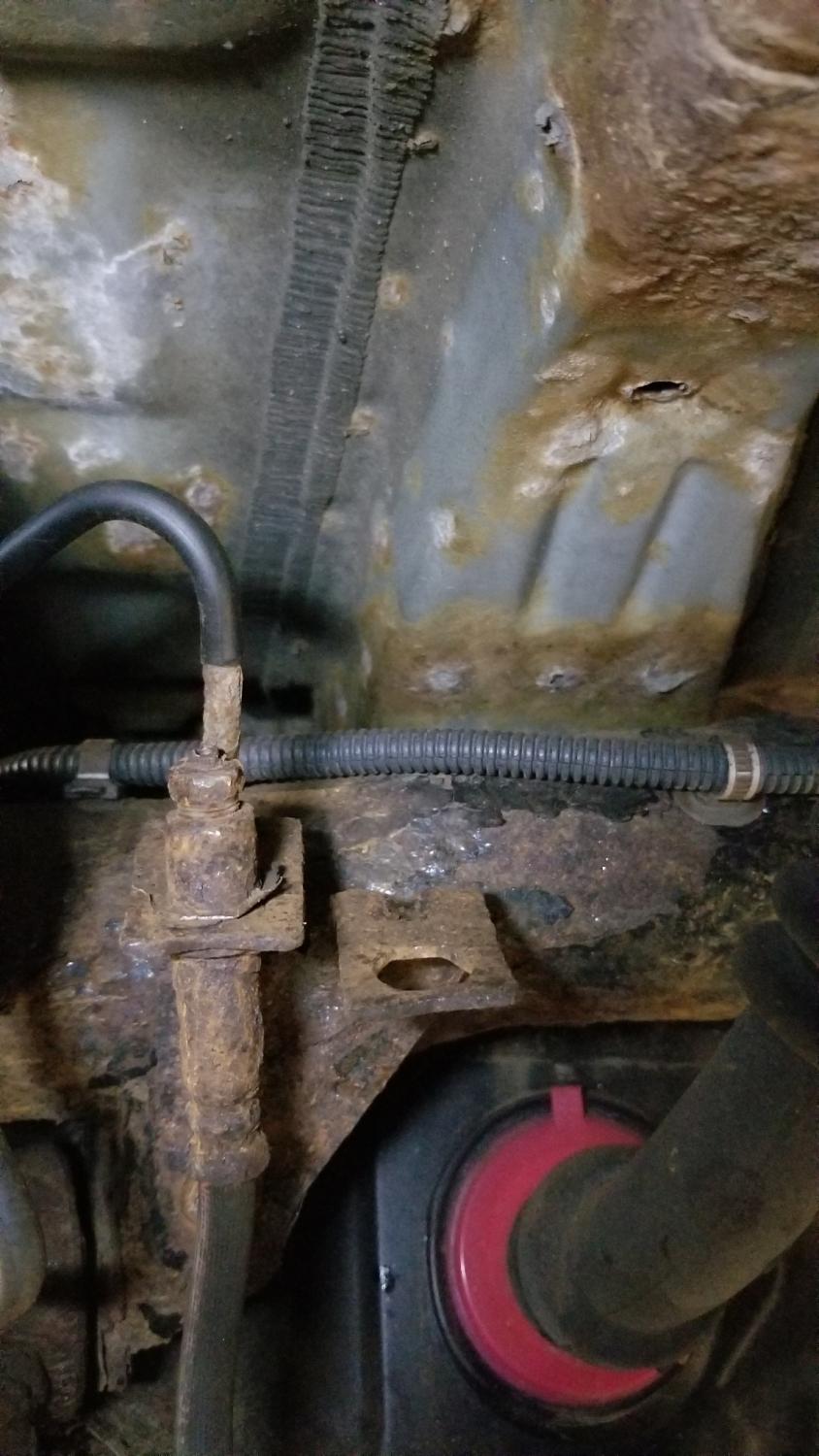

Well I am self quarantined at my shop. Yesterday I decided it was time to do all the brake lines and rear inner hoses. The job went well. I used about 30 feet of copper nickel line. The only really difficult part was getting the rear inner hoses replaced. The upper bracket bolt was toast and I couldn't get it out. I was forced to get the hoses out of the brackets with it up in the car. The clips were rusted in such a way that it was all basically one fused piece. I was able to get them out eventually with some cursing, wiggling, and prying with a flathead screwdriver. I am so happy to have this job done and now I don't have to worry about a brake line going out!
Tips for those considering doing this job.
1) Make a plug out of one of the old fittings to plug the master cylinder when you need to disconnect the line. This will keep the master from going low on fluid while you work.
2) The master cylinder is labeled. The line coming out of the front are for the front brakes and are labeled L and R. The lines coming out of the side are for the rear and are labeled L and R as well. (I didn't see this right away and was working on one line at a time to ensure I didn't make a mistake which would mess up ABS etc...)
3) make sure you're able to crack your bleeder screws before you start. To make this a one man job like I did get speed bleeders and replace them before you begin to make sure you are able to bleed the brakes when you're done. If you can't you're going to need to replaced the calipers or drill and tap new bleeders.
4) If you're replacing the hoses get new clips, my hoses did not come with them and I had to improvise for now with cable ties.
I replaced all of mine last year because they were all toast. Love that copper nickel line, so easy to work with. I'll never go back to the ones you buy at the parts store. Wish I knew about #2 above. :-)
The new lines look good!
