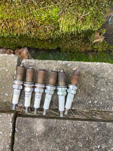

Changed the spark plugs. Apparently the previous owners thought it was optional or something[emoji58]
‘07 with 187,000 miles and what would appear to be original plugs

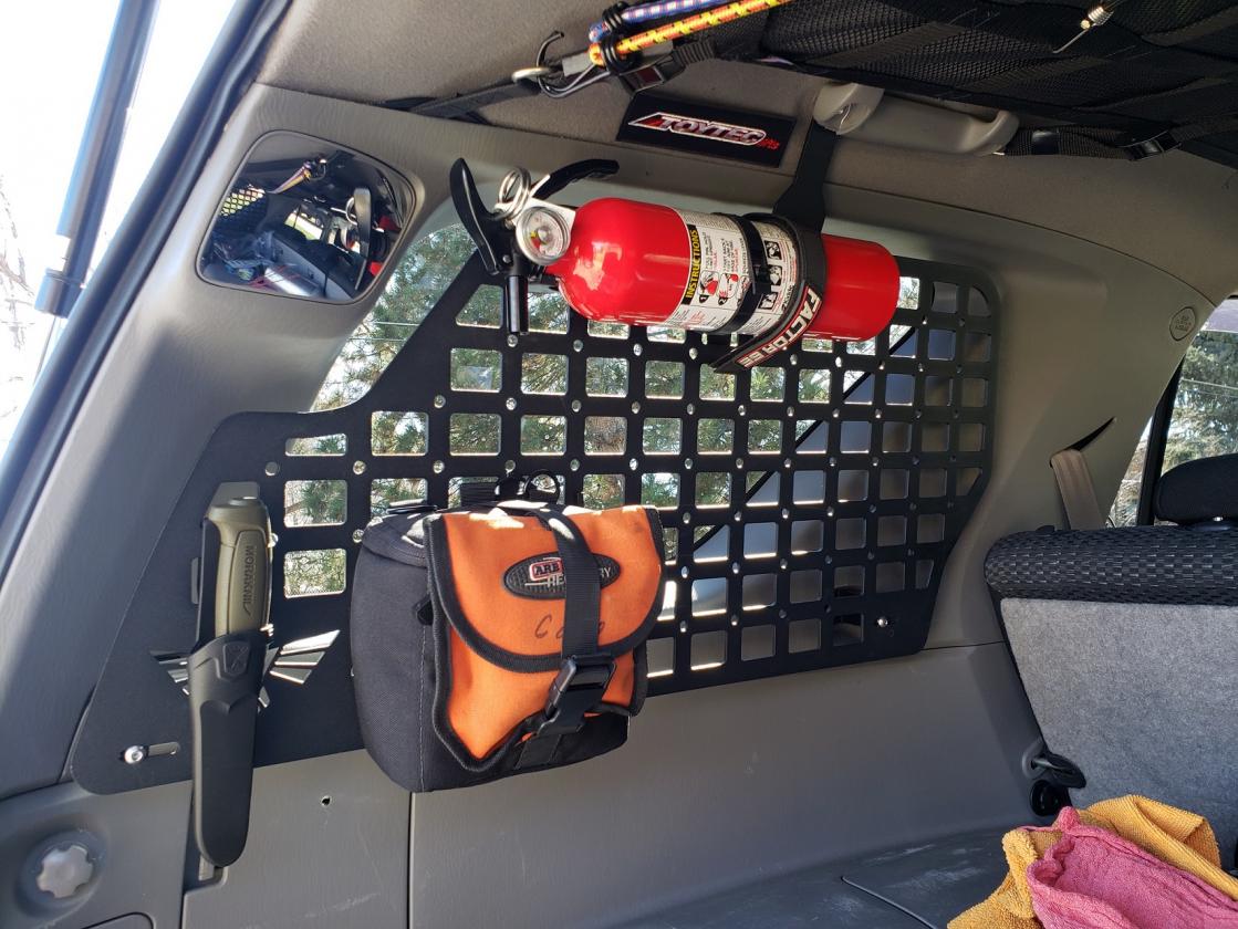

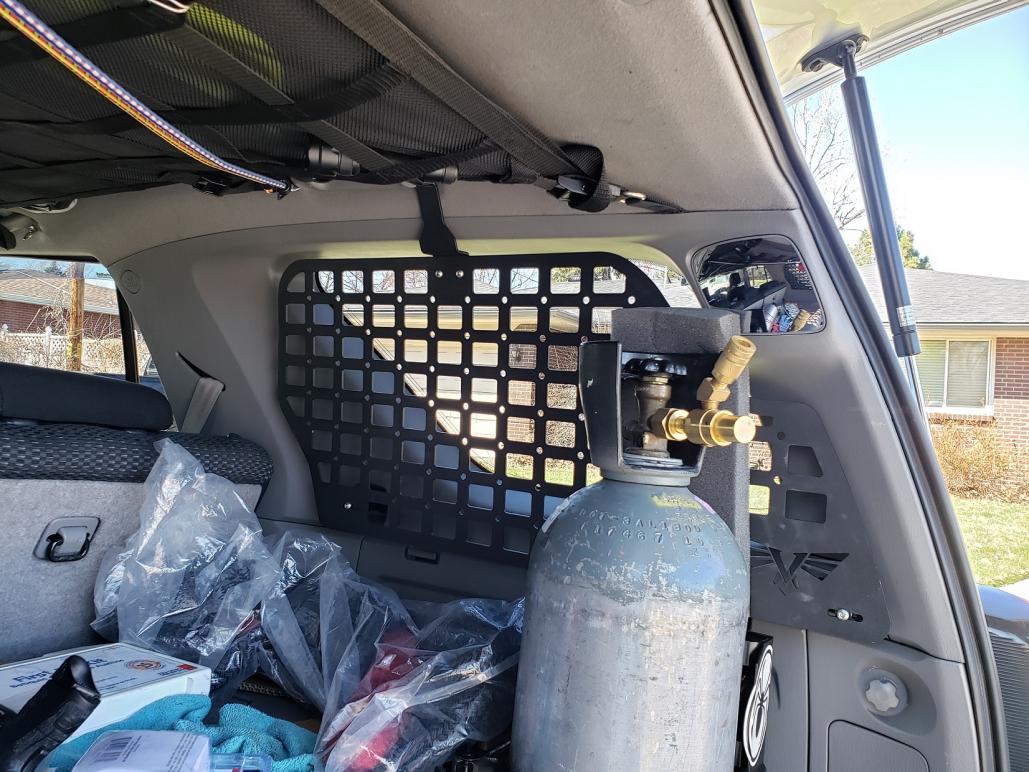

Finished installing my [MENTION=41439]victory[/MENTION]4x4 molle panels

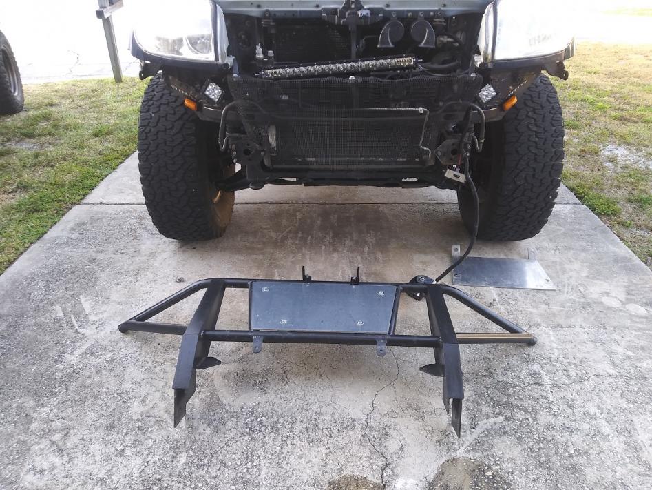

Took the bumper off to repaint some spots I missed and scratches are starting to rust. Might re torque the header bolts while the paints drying.

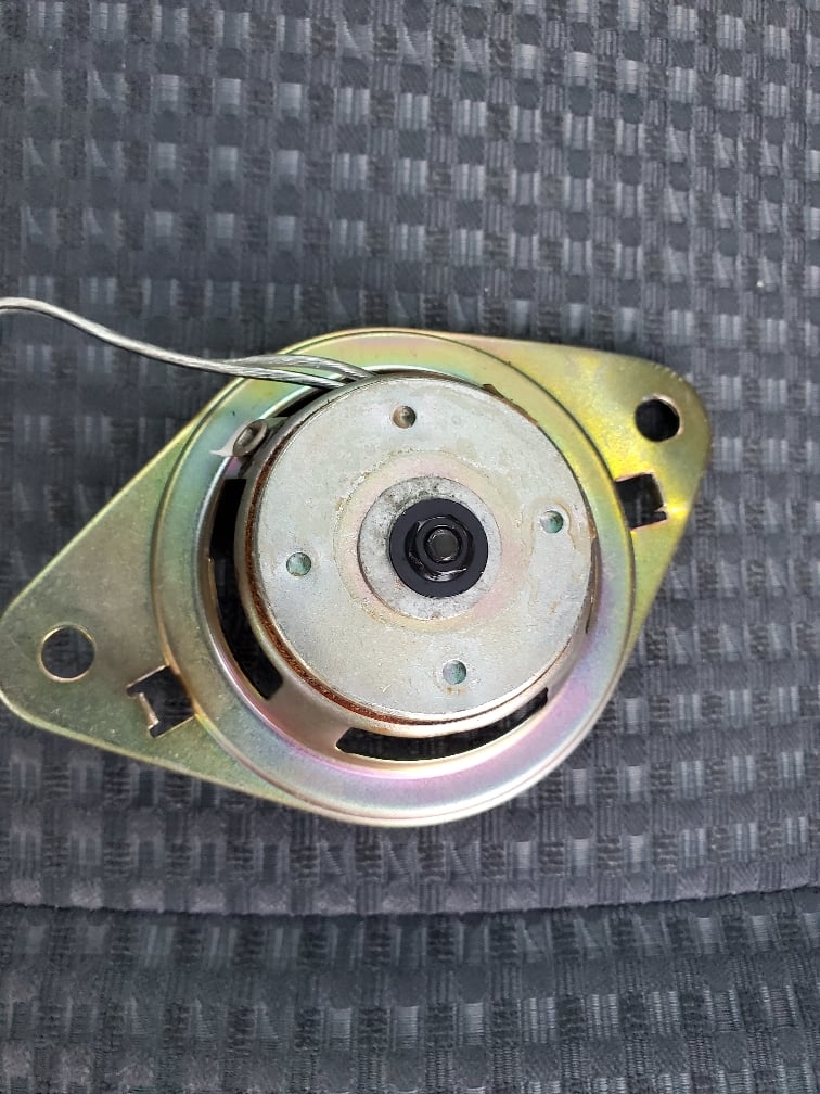

Got the driver side speakers tweeters replaced on friday and the passenger done yesterday. I'm happy with how I mounted the tweeters. After researching on here I had a plan then when took the stock tweeter out I just pulled it all apart and used that. Easy enough, just had to wait for the metal to cool down after I melted the glue to get the magnet off

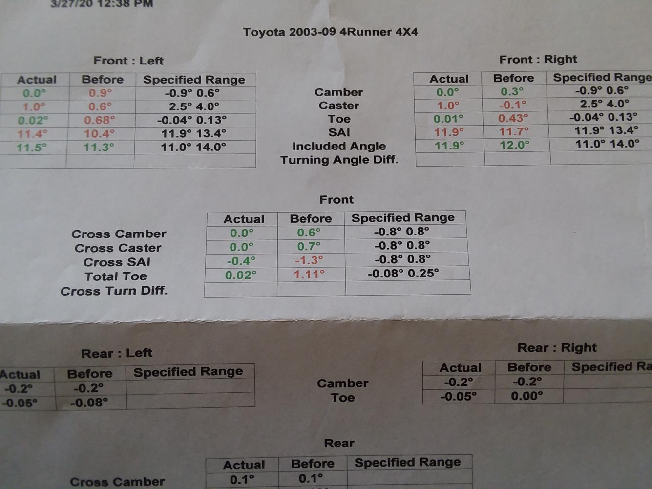

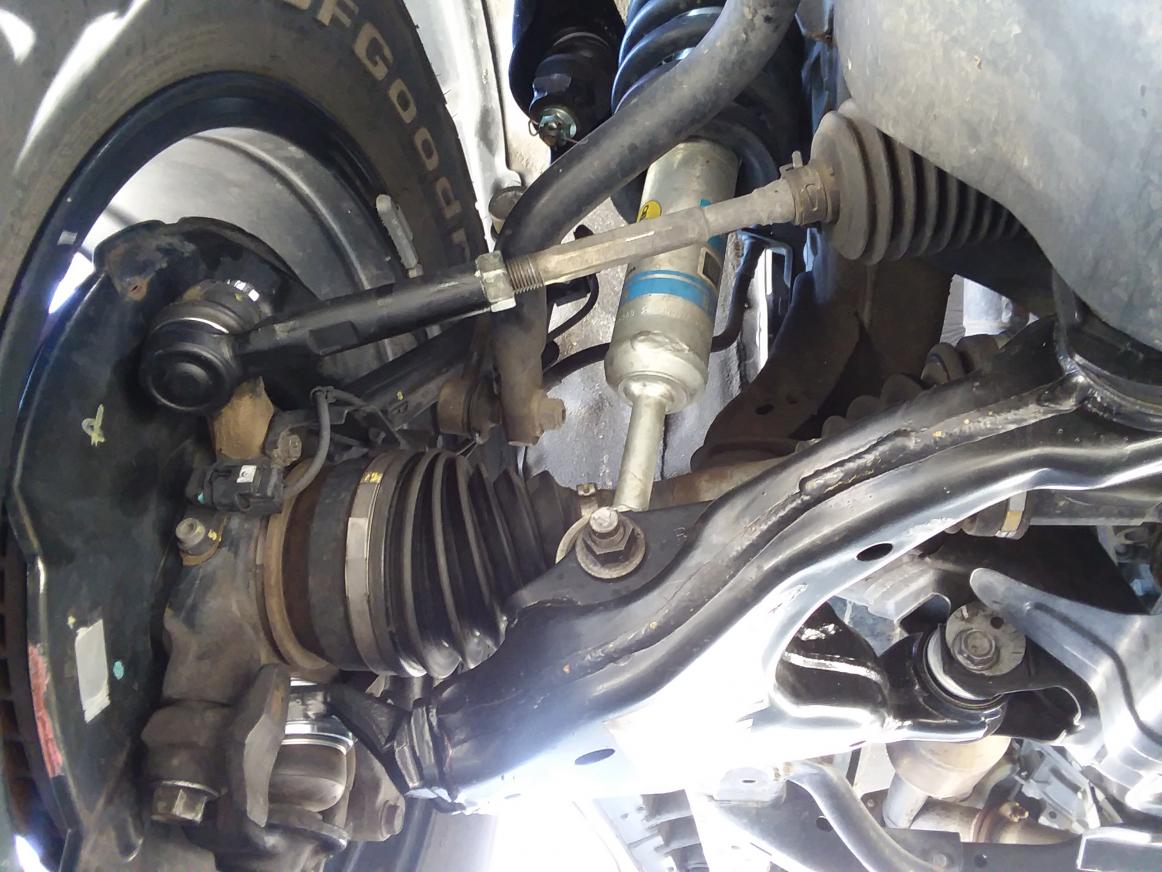

2006 SR5 4Runner 219,000 miles W/ 3" lift up front.
Installed new upper & lower Control Arm Assemblies, and new Tie rod ends.
Then had an alignment done. I cant decipher the alignment paper so im not sure if its ok or not....
