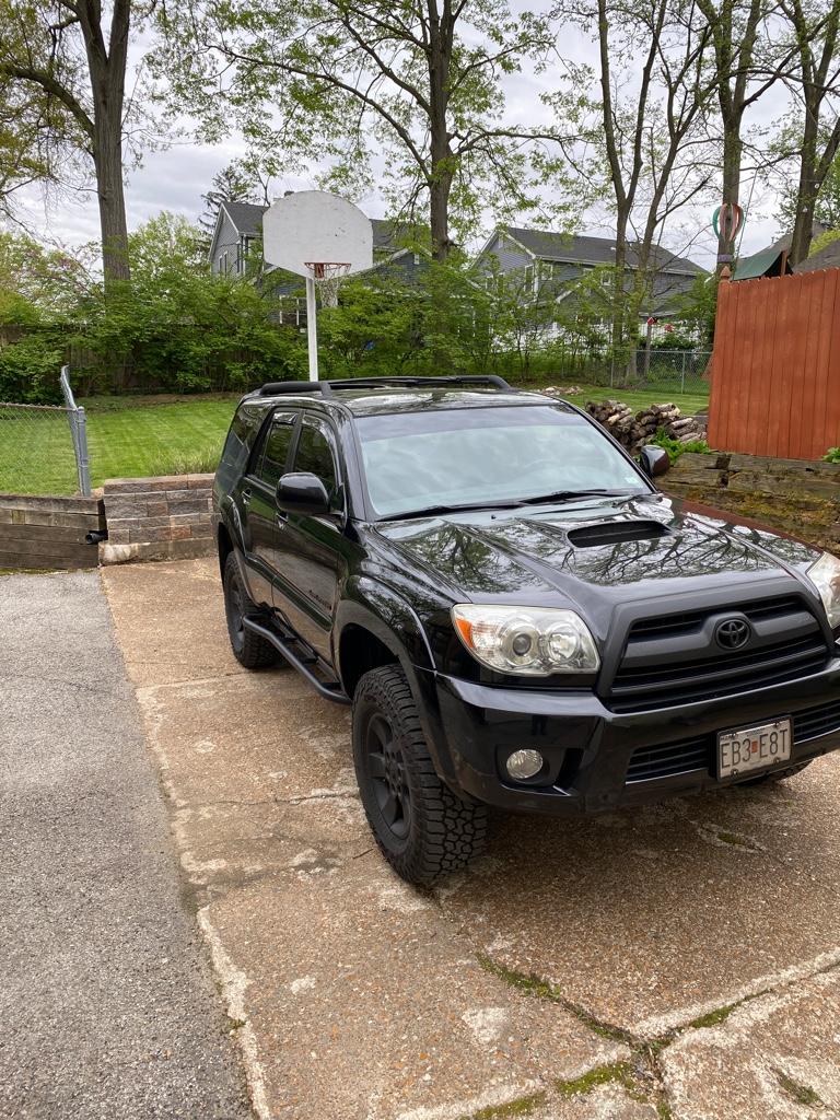

Replaced the drivers headlamp today. Passenger was replaced over a year ago, and it’s been bugging me having one foggy/yellow headlight. Ordered a TYC from RockAuto. As addressed, first 3 screws were a breeze, and that 4th is a b!tch. Ended up removing the screws and pulling the fender liner all the way back to gain access. Once removed the 10mm fit right up in there, just barely. I did not replace that bolt as it’s a tight fit and the other 3 screws plus the corner that snaps in holds it in TIGHT! also, replaced the marker lights while it was out.

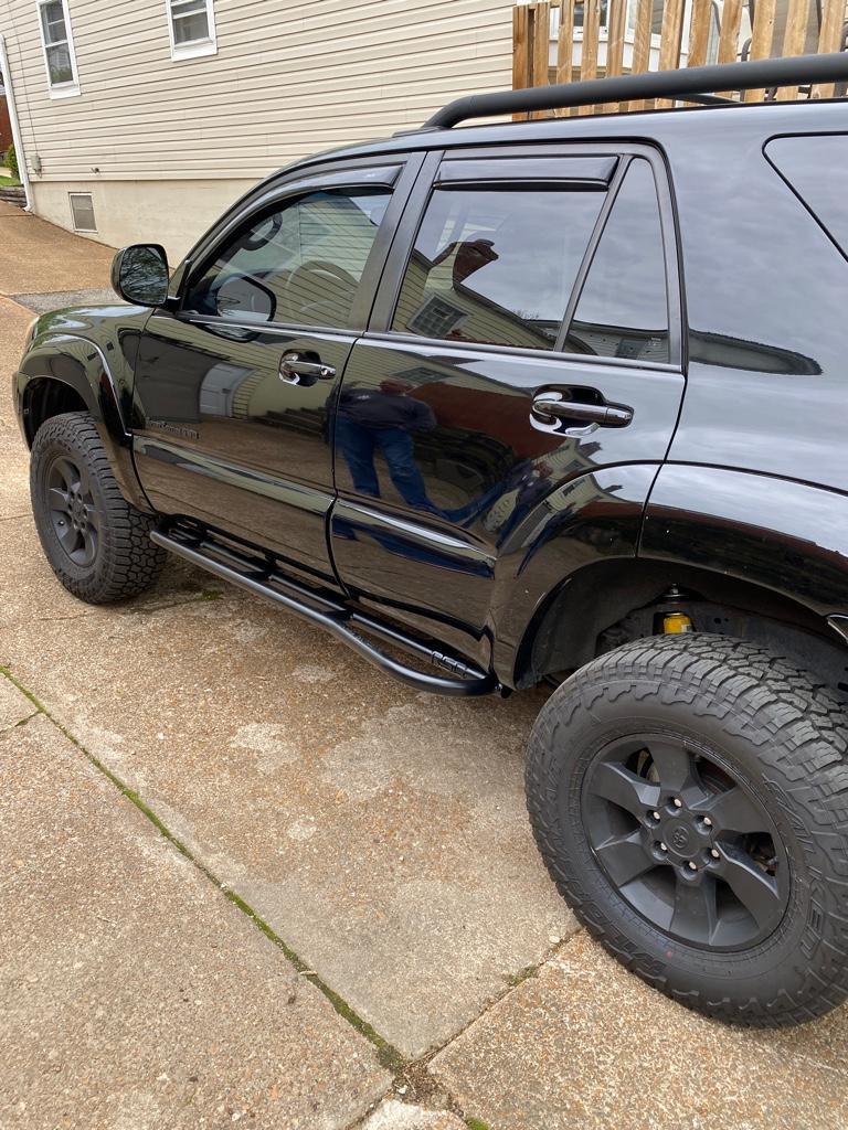

So back apart she went and I STACKED the 15mm INSIDE the 1.5" and placed it on top of the isolator. This worked perfectly, I'm now finally level in the rear lol.
It was tons of run trying to create enough clearance to shove that monstrosity in. :bash:
Man I envy how rust free it is under there.

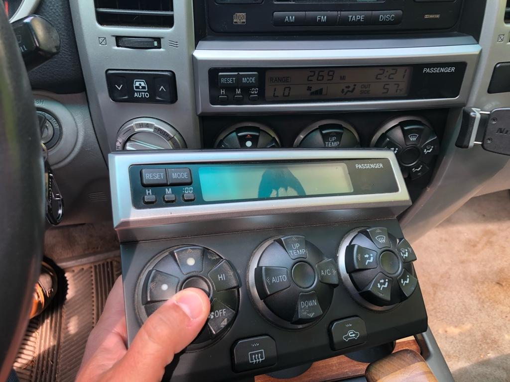

First post here. Today I replaced my damaged climate control module with a fresh one.
I replaced the climate control bulbs with T3 neowedge, also did the glove box (didn’t know there was bulb in there) cup holder (didn’t know there was one there either) and gear selector with #74 from VLEDs.com and then I learned about all the other lights that are burnt out so I ordered a bunch more T3 and a T4 for the 4WD selector. Ordered the T4 for the 4WD selector from VLEDs.com and the two T4 for the climate control display from autoluminarion.com to get everything back to working.
Lastly, I installed some 7440s from @Lasfit and HOLY COW. Those things are really really bright. No one will ever be able to say they didn’t see my blinker. Even distracted drivers will see it. Haha
I have a question regarding this. Do the dials have lights on them, other than when they are activated? Meaning, when the fan is not on, is that "dial" supposed to be illuminated in some way? because mine are not, unless you actually have it on.
Thanks,
Thanks,
Are you talking about the white letter back ground or the orange triangle indicator? When your headlights are on, the knobs should be (stock) orange. and triangle indicators light up when that mode is selected. Your bulbs are probably blown
Thanks,
Hi Pedro, Sparky has this right. With the headlights on, the text on the push button 'dials' should be back lit. The little arrow indicator lights are independent of the back light on the buttons. Hope this helps.
