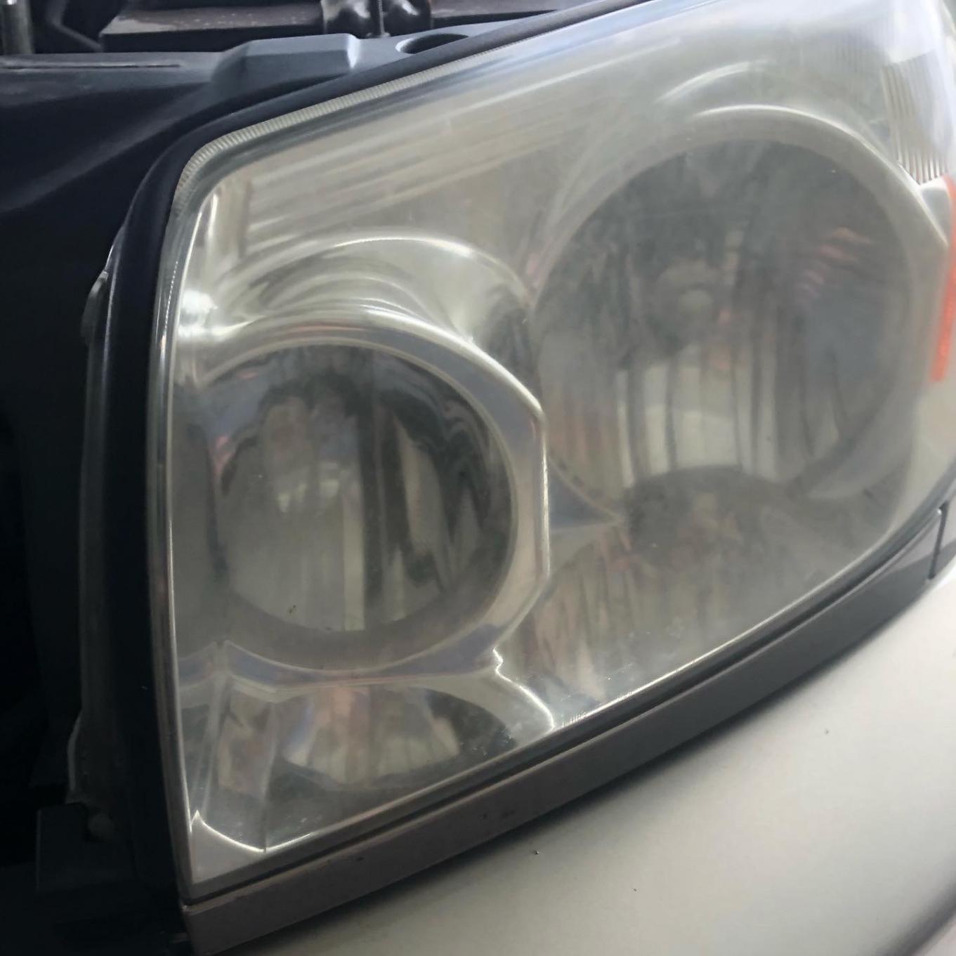

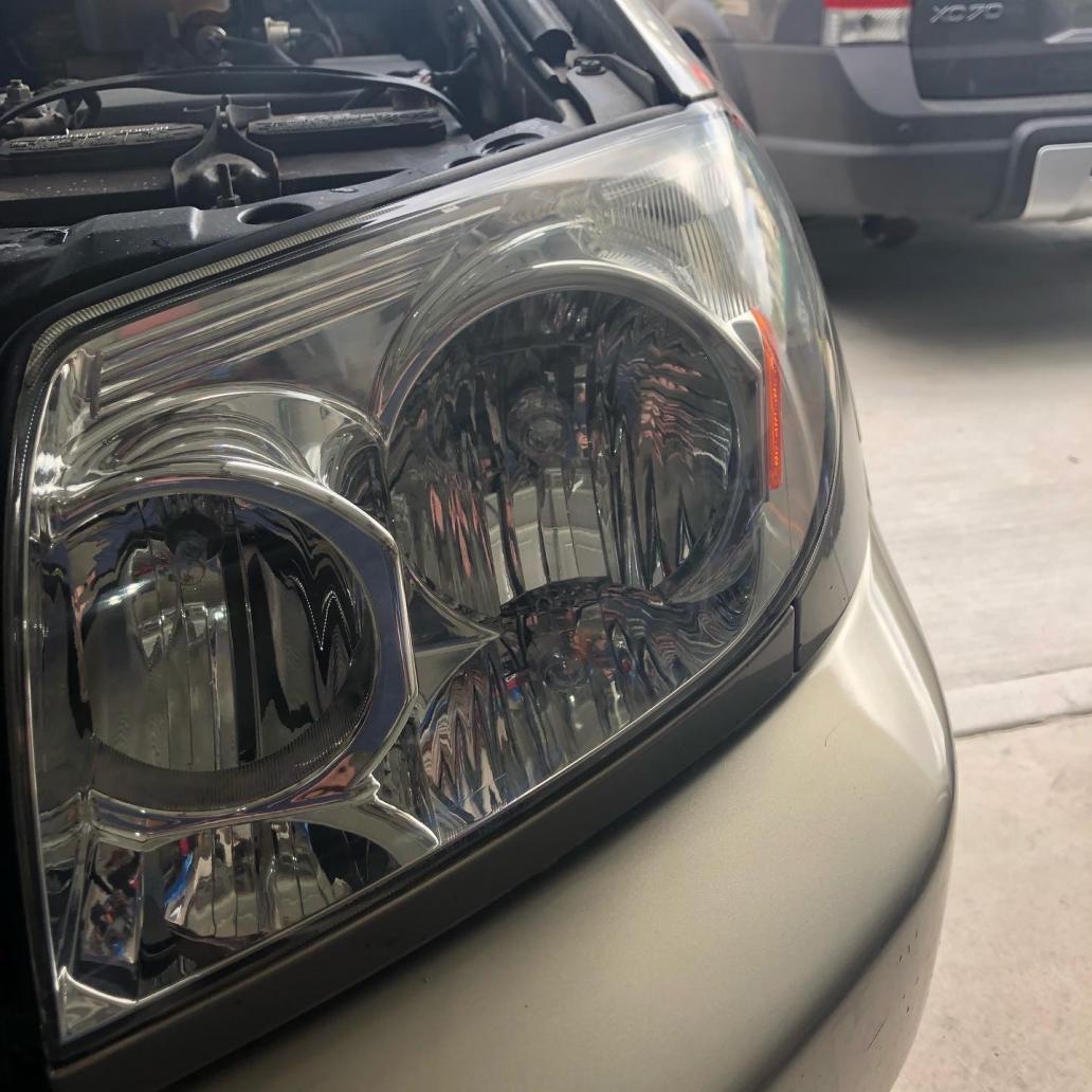

Restored headlights!
Before and after!

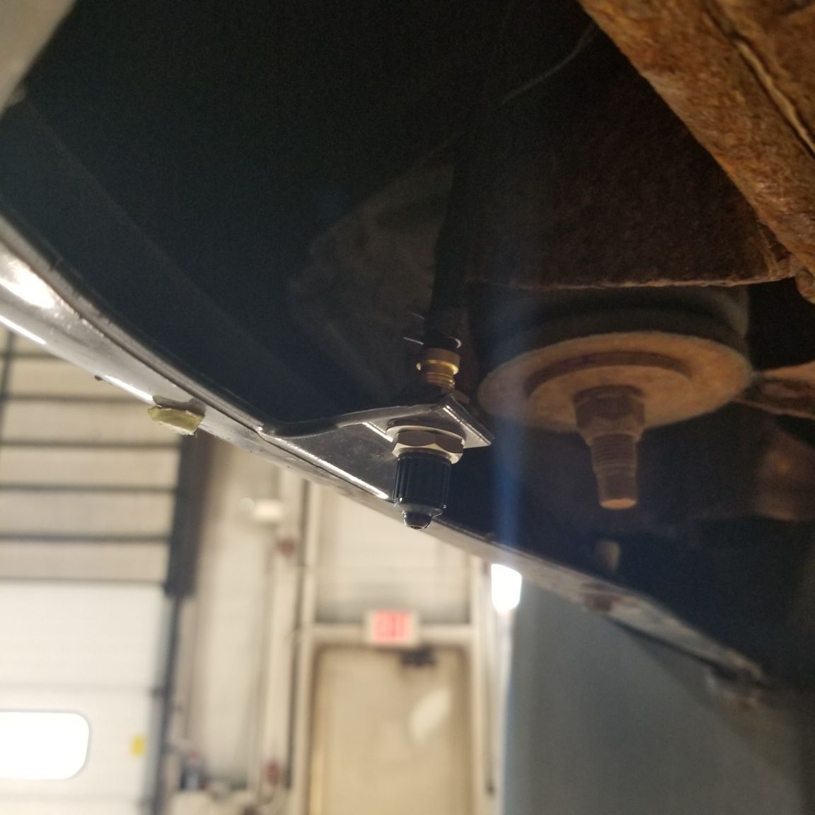

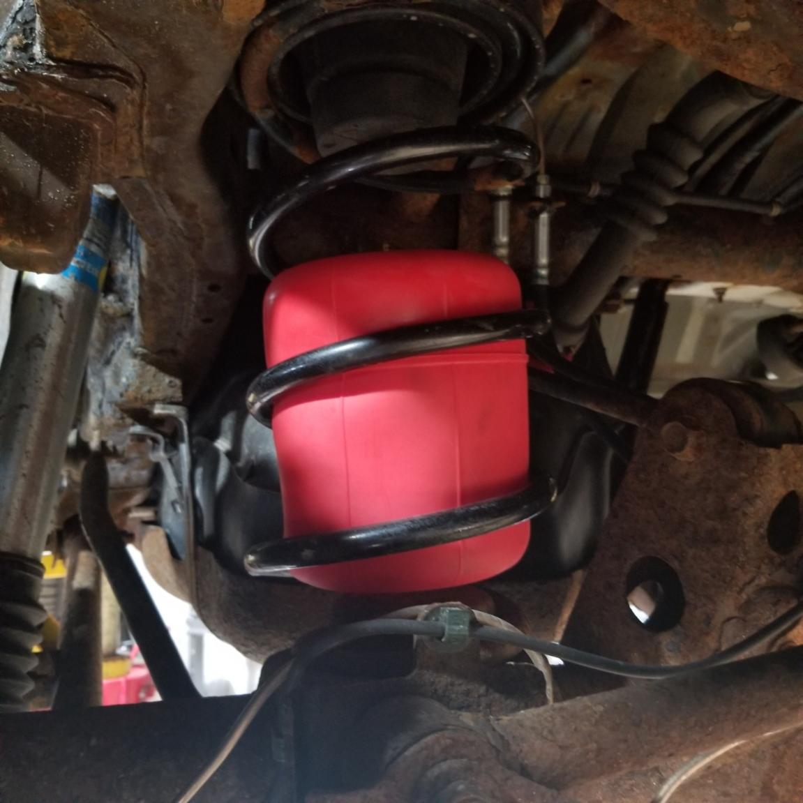

Installed airlift1000 springs. Anxiously getting ready for boating season in Maine...
Wasnt sure how much bump stop to cut woth a spacer lift so I did 2/3 of the recommended. Hopefully that doesn't screw me. I also installed the airlines on the top like many others have. Only issue was trying to keep the airline 8" away from the exhaust as recommended. I will probably wrap the passenger side airline in plastic loom.
I ran the fill valves in unused bumper tabs for easy access. They're undetectable when the vehcile is on the ground.

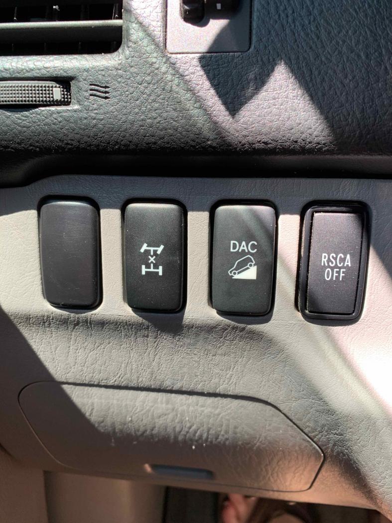

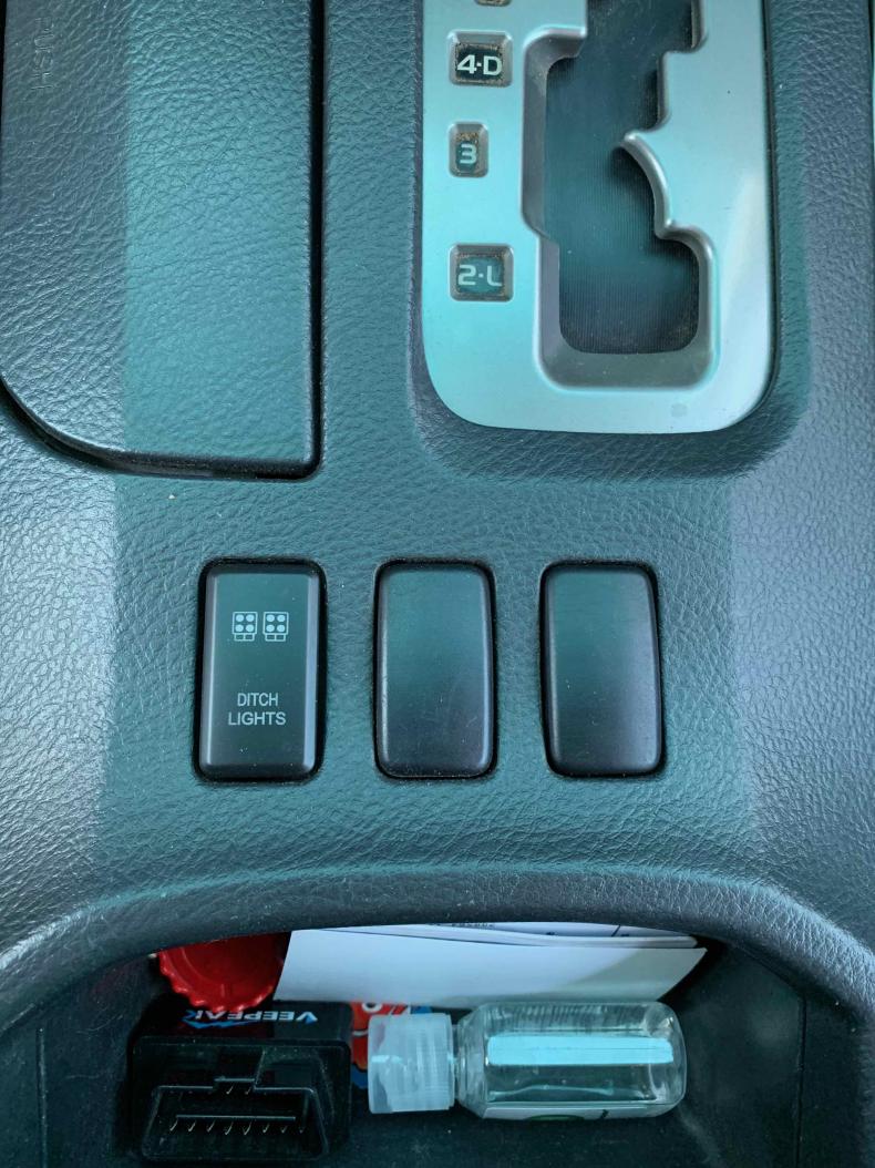

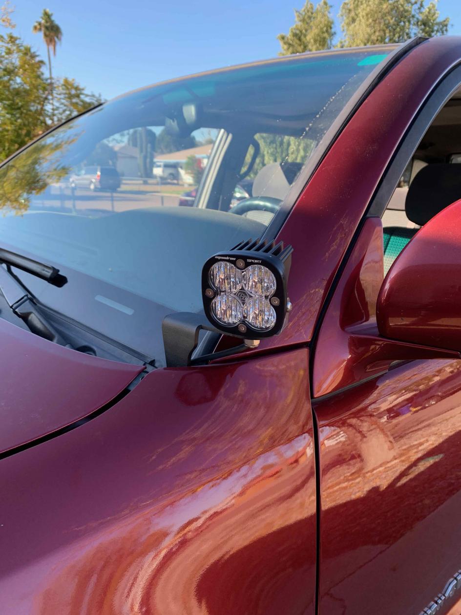

Installed the Baja Designs Squadron Sport ditch lights some time ago. Used the CBI ditch lights bracket, very happy with all of it!
This past weekend I installed a Cali Raised amber lit switch, and moved the DAC switch to the dash to make room for future light switch additions!
nice! I used the CBI ditchlight bracket for my CB antenna but I think I'll get the pass side and put in some ditch lights.
Nice job on the DAC button relocation. How was that? PITA? I hate that the DAC button is where it is. My dog constantly hits it when jumping around or my kids hit it when playing in the front seat :P
Another option is to just remove it and replace with a blank switch. That's what I did to mine, I'll never use it anyway.
Nice, I added those to a van I used to tow a camper with. Huge difference. I put the valves behind the fuel door so I wouldn't have to crawl around looking for them.
Funnily enough I've had the same issue with a dog hitting it, haha. It really wasn't too bad! I bought 5ft of 18 gauge 4 bundled wire, used some heat shrink solder connectors, and ran it through the center console and then under the steering wheel. Works perfectly, and took around 45 minutes, taking my time.
