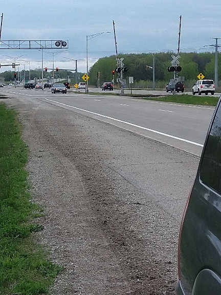

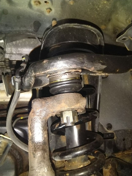

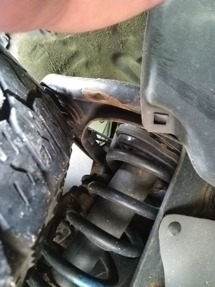

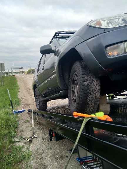

Busted a ball joint on a railroad xing today...
Sent from my Nokia 6.1 using Tapatalk
You're lucky that happened at a RR crossing instead of doing 70 down the interstate, even slower around crowded other traffic or God forbid kids walking on the side of the street!
Time to inspect your entire front suspension and replace all the worn parts, if one part failed like that other parts are close to failing as well!
I agree. I had just gotten off the interstate, too.
I'll take a look at the others. I may have damaged this one when I put in my spacer lift ~2 years and 95k miles ago.

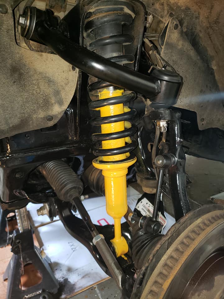

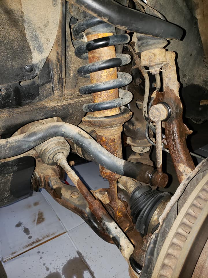

New LCA, UCA, inner and outer tie rods and swaybar endlinks and while I was in there knocked on the Minnesota rust and repainted that area of the frame.
I love the ride of my OME kit but the MN winters conditions are terrible for their appearance.
Whew that is a long day...or two.
God bless, it's like a whole new truck!

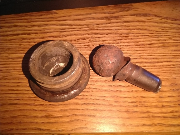

Fixed it today. I waited too long to get it checked. Learned my lesson, got off easy, I guess.
Ended up having to grind off the castle nut to get it off...
Also, pic of new joint taken before inserting cottering pin.
I can't imagine what I would have done without free tool rental - the ball joint press kit is $230 at advance auto!

How hard/easy was it to replace the ball joint with the loaner tool?
Got out camping for the first time in far too long! Love how easy it is to just set up a pad/sleeping bag in these and be comfy.
And yeah, I need to reseal my fog lights :(
Getting the cup out took about 30 minutes, no problem at all. Awesome how-to video here: Long How-to
Shorter one: YouTube
I spend 2 hours on the taper joint. Had to grind the nut off, couldn't get my ball joint splitter tool (harbor freight) to get the ball out, so I rented a pickle fork set. The pickle fork was too small (not a big enough wedge) but I finally managed with the ball joint splitter clamped on and wedging the pickle fork on top of it, still took 2+ minutes of hard swings with a 4lb hammer.
I cheated putting the joint back in, kinda used an unorthodox method to press the new one in, since you can't bend the control arm down far enough to get the press screw in above it. So I found a combination of tubes & stuff that let me screw from underneath and "pull" it in, which worked great. Took an impressive amount of force but went in just fine! Be sure to use the 23 pc loaner from Advance Auto, apparently there are smaller ones with much fewer tube options.
