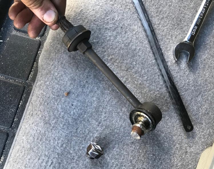

did a couple things today... nothing too ambitious. spent a good bit of time sawing through the rear endlink bolt as I stripped the washer and couldn't get enough grip to get the last few threads off.
https://www.toyota-4runner.org/attachment.php?attachmentid=363848&stc=1&d=1592619011
didn't have the right tools I guess. I had to take the hacksaw blade off the frame and saw with both hands for what felt like an hour to cut the bolt. I replaced the original OEM ones with Whiteline endlinks.

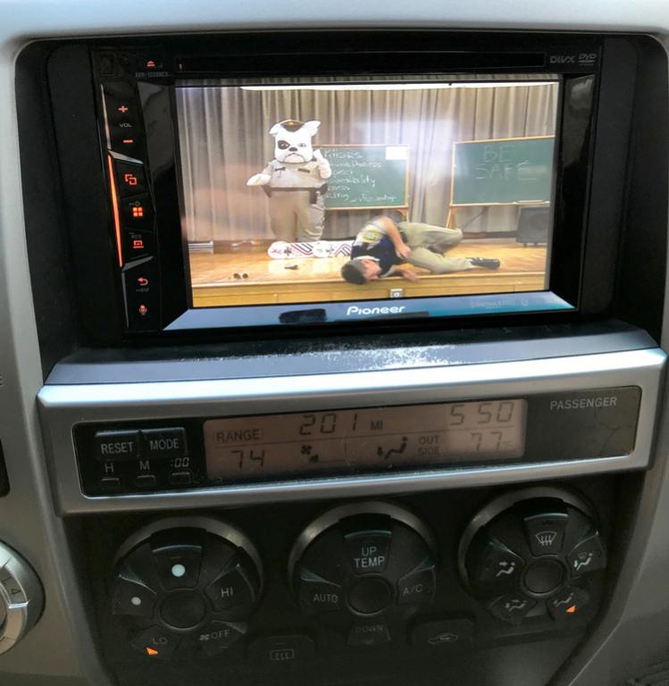

Then I replaced the headunit:
https://www.toyota-4runner.org/attachment.php?attachmentid=363849&stc=1&d=1592619155

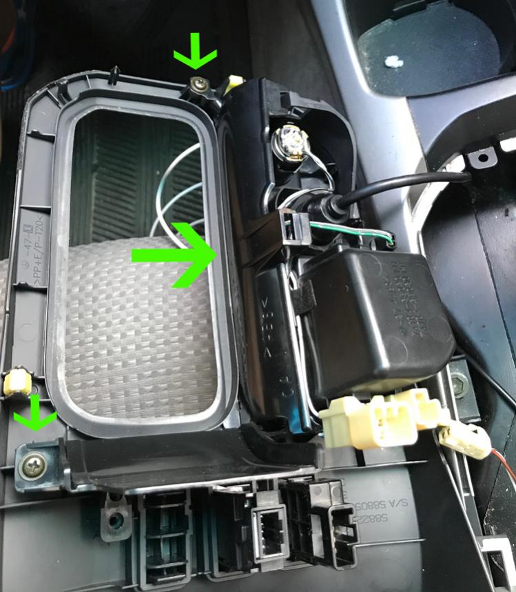

Just a Pioneer AVH1550NEX. Going to miss the cassette option believe it or not. That Rivers Edge soundtrack was a real staple. I did the same USB mod to the smokers kit that [MENTION=293182]LinuxHack3r[/MENTION] did found here. I installed a Micro Bypass even though I don't think I'll ever watch movies while driving, but I wanted that option while everything was apart.
Speaking of which, just in case anyone else is a moron and buttoned up everything only to find they forgot to thread the USB cord from the smokers kit through the console trim, I found you can remove part of the underside of the trim (big arrow) by unscrewing three screws (2 seen here with the smaller arrows) and slide the kit through and not have to completely undo all the trim removal to fix a dumb mistake.
https://www.toyota-4runner.org/attachment.php?attachmentid=363850&stc=1&d=1592619488

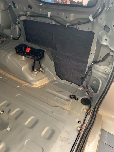

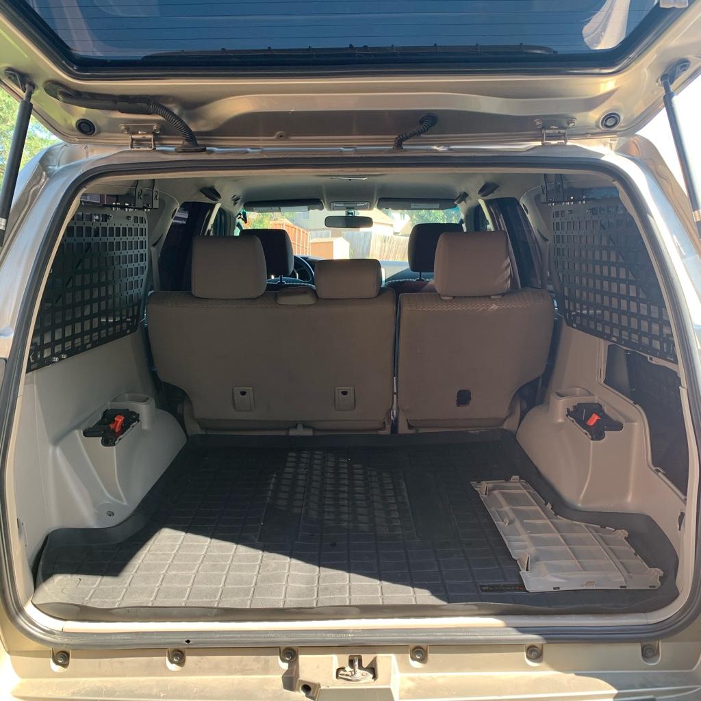

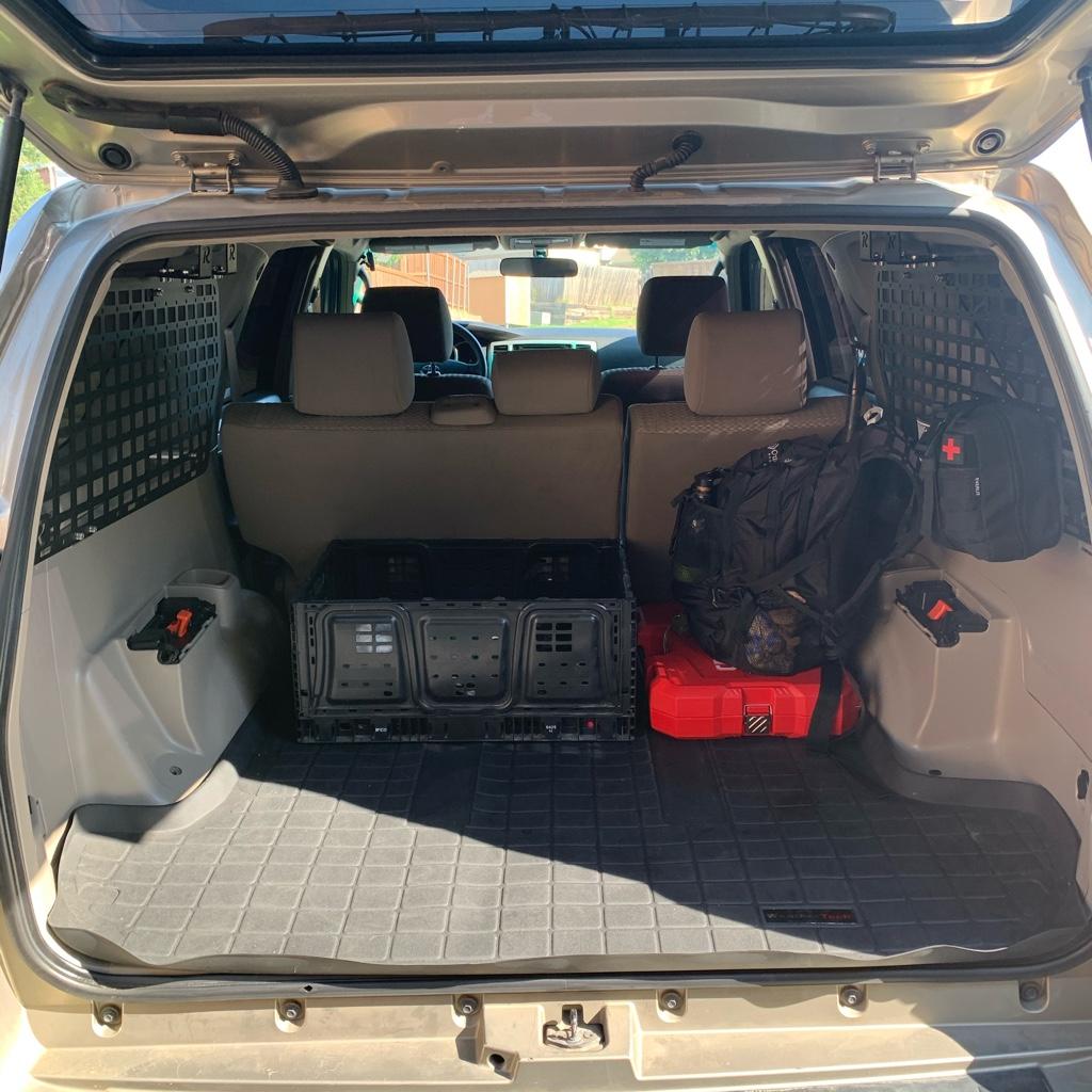

I finally finished my Modular Storage Panel install on my ‘08. I installed the Rago Fabrication panels in the cargo area, which did not go in as easily as I thought they would but they are very sturdy.

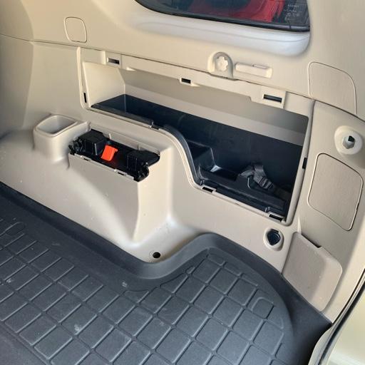

The longest part of this install was a custom install that I added to my cargo area- inside the passenger side compartment intended for fire extinguishers.
The biggest challenge was getting the right panel and getting it in there nice and sturdy so that I don’t have to listen to it rattle. Long term, I want to reinforce the hatch and make it a low-key safe.

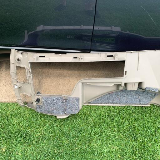

Heat barrier to protect anything stored inside. When it comes to installing this. I had to remove both the lower and upper panels so that I could take off the seatbelt. I was drilling and securing right behind it.
I had to trim the lower panel of the original compartment shape so that it would fit back on. Then I cleaned it of any plastic debris.
You can see the panel behind there. It was tricky figuring out the holes, bolts, bushings, and lengths for the spacers to make an even and sturdy frame but it came out! The black “bucket” part of the original compartment was not put back in because they would have collided. I would have had to trim a fair amount off and I like the possibility of having space down on the right to stash or install something else (outlet?).
All panels installed. The passenger side compartment hatch is my next step of the project. I have a special lock picked out for it and I am going to reinforce it and put hinges on it so that it can be pried from the bottom when locked. More to come!

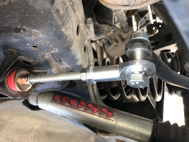

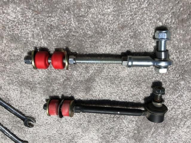

Started to give my 07 a bath until my pressure washer broke. Vacuumed the inside. Finished and installed my adjustable rear sway bar end links.

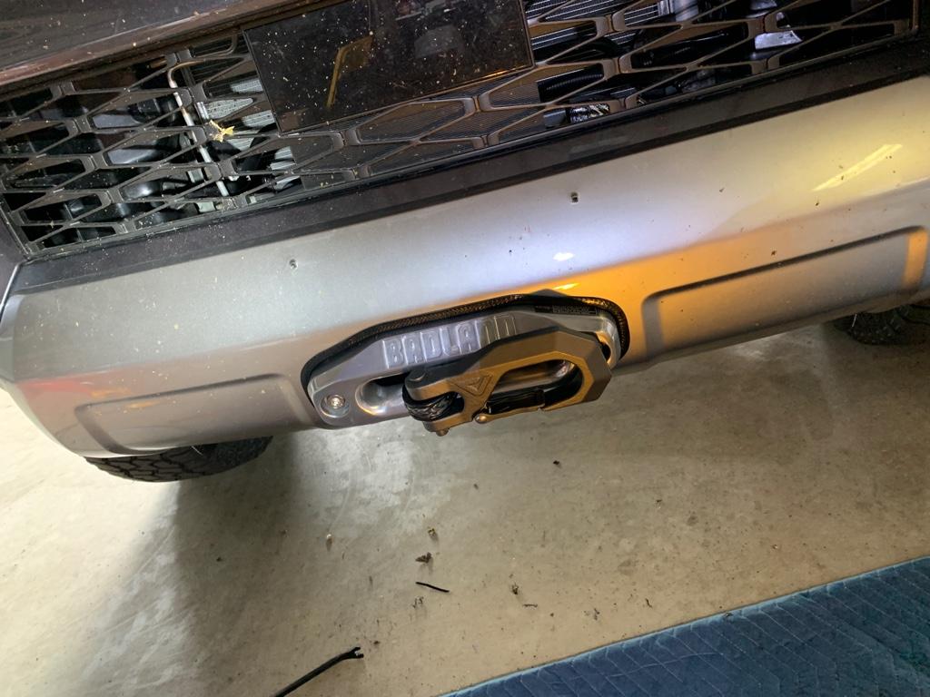

Installed Rago Fabrication Hidden Winch mount and Badlands Apex winch.
Very tight fit but the local Toyota dealership moved my hydraulic hardline out of the way for me. (Wanted them to do it just in case warranty issues, no charge)
