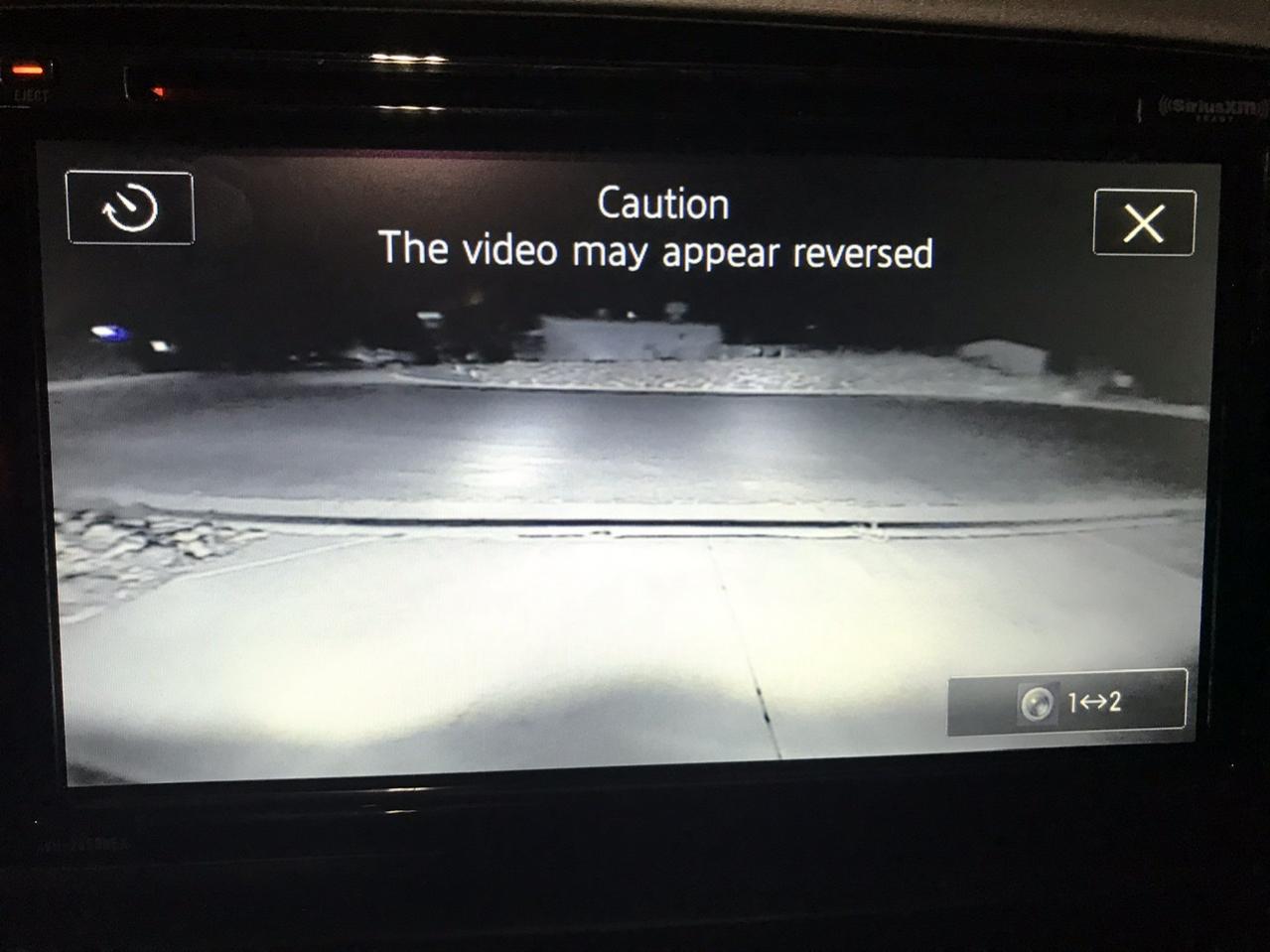

Installed my front camera this evening on my bull bar. I am able to view at any time and can toggle back and forth between the rear and front camera. Plus it goes in to the rear view mode when in reverse with parking grid if chosen.
It will be nice to finally see in real time what’s on the other side of that hill as it’s crested while off-road.

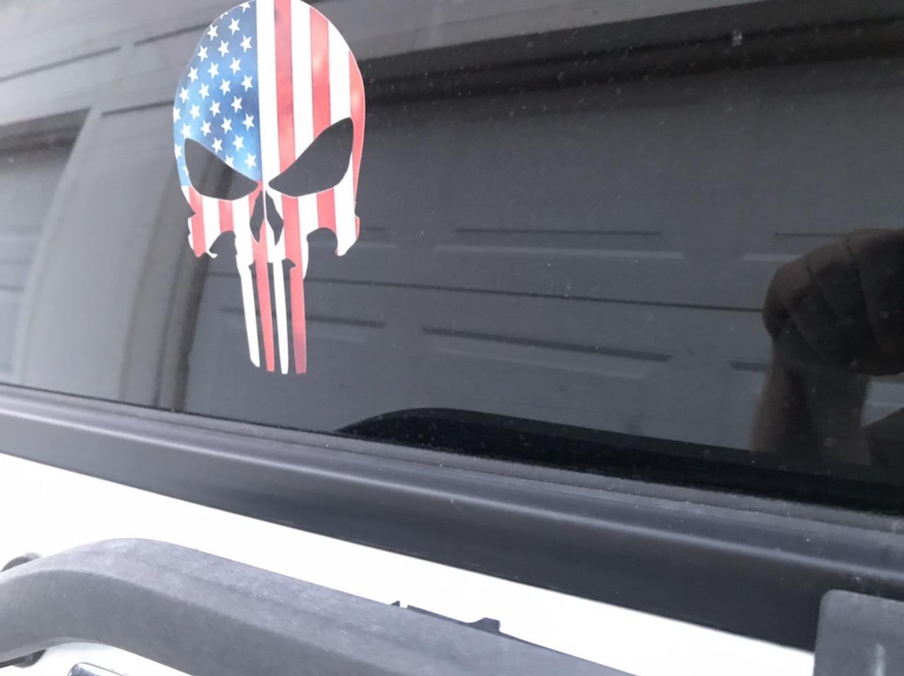

Today I got in my OEM rear window exterior weatherstrip and got it installed. I knew it wasn’t in the best shape, it worse than I thought lol. Sits nice-N-tight against the glass now. It is a TOYOTA Genuine 68290-35031 Door Glass Weatherstrip Assembly

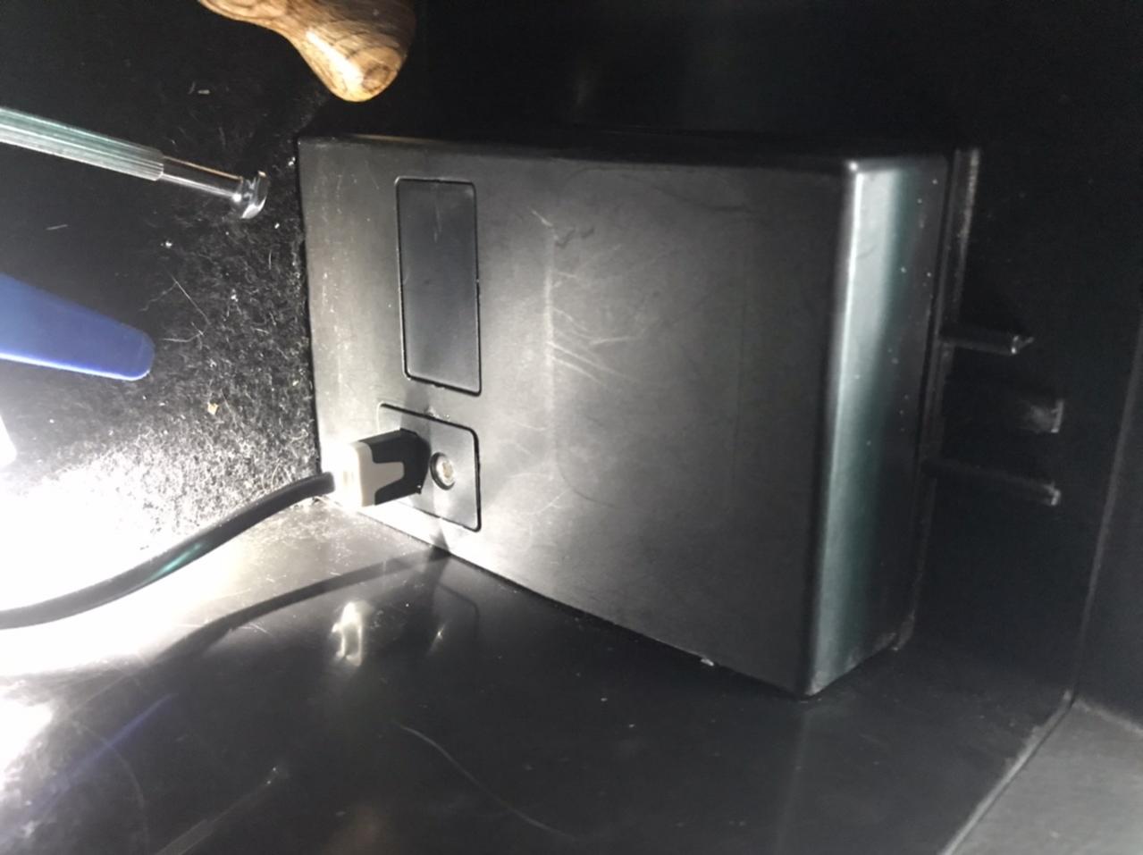

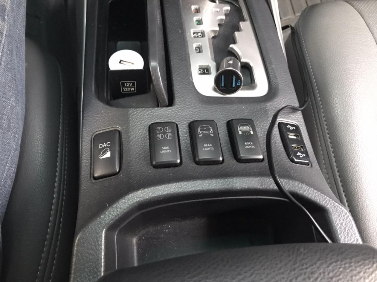

Also got in my auxiliary usb/3.5mm jack connector in. I took a gamble that it would fit into the existing opening inside my console that just has the old school headphone jack and figured I’d make it work whether I had to build it up or trim something. Well it fits perfect! Super pumped about that :clap2:
These don’t have that great of reviews and how they can fail so I was actually able to just use the one that came with my Pioneer HU and put it in the jack body housing assembly. I don’t think it would have reached anyhow. I haven’t tried to plug in headphone jack yet to back of HU but don’t think it will be long enough, didn’t want to remove whole HU and have it not be long enough. I’ll get an extender or just a longer one and figure it out later. Not sure I’ll ever use it though but would rather have it if I do.

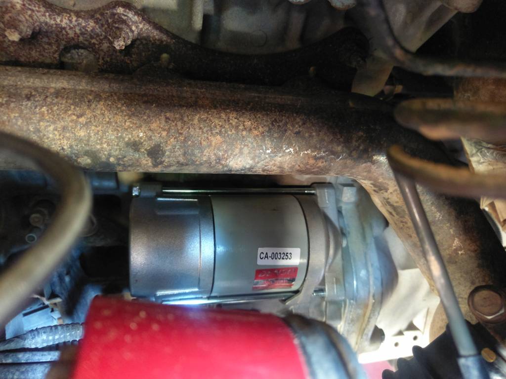

Finally had some time to replace my starter. Old one was still working but every once in a while it would not start (probably bad solenoid contacts). Replaced it with a Denso one from Amazon (Amazon.com: REMAN STARTER: Automotive). Followed the video below. As long as you get the break line out of the way you can get the starter out through the side. Tight to work in there but doable. Took me 30-45 min. Glad I have the V6!
YouTube -2003 Toyota 4runner starter removal

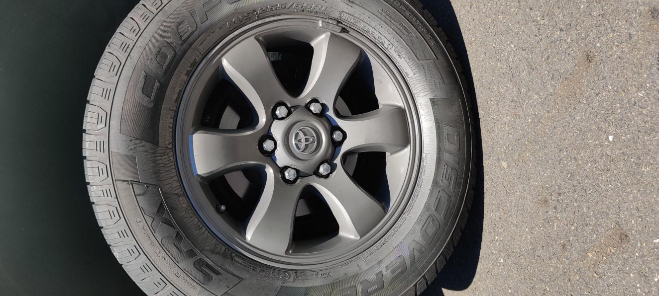

Finally got around to spray painting my wheels, gunmetal gray. put tire shine on the tires before painting so it didn't stick. Really love the look of these.
