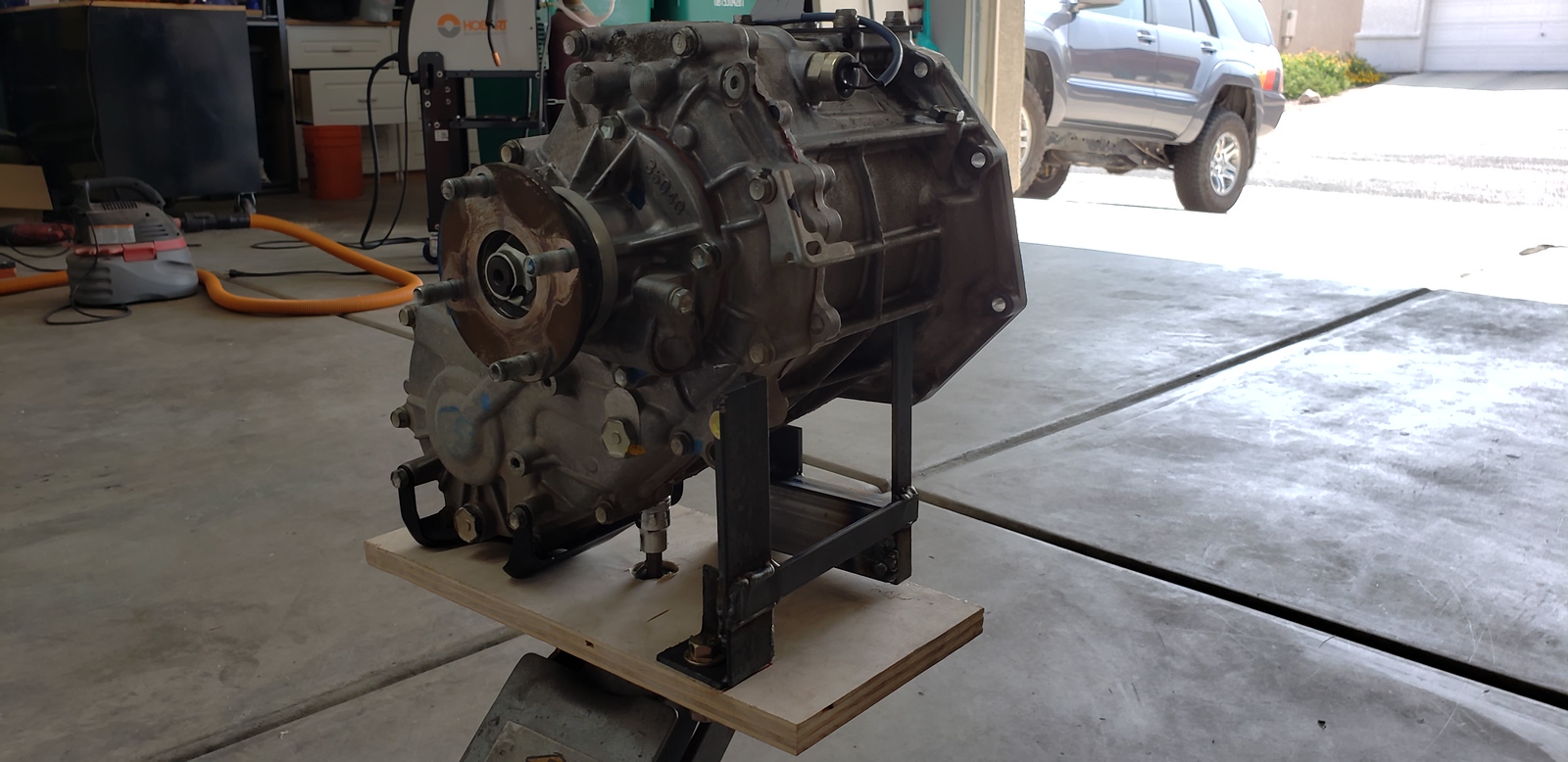

Yesterday, I made a cradle for the FJ t-case in preparation for the swap next weekend. Sits great on the floor jack and won't fall off. Also fits the stock t-case.

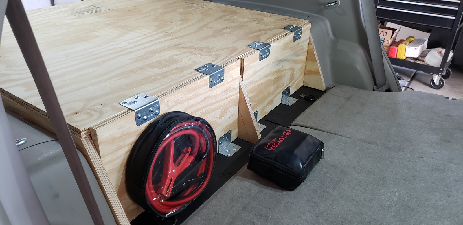

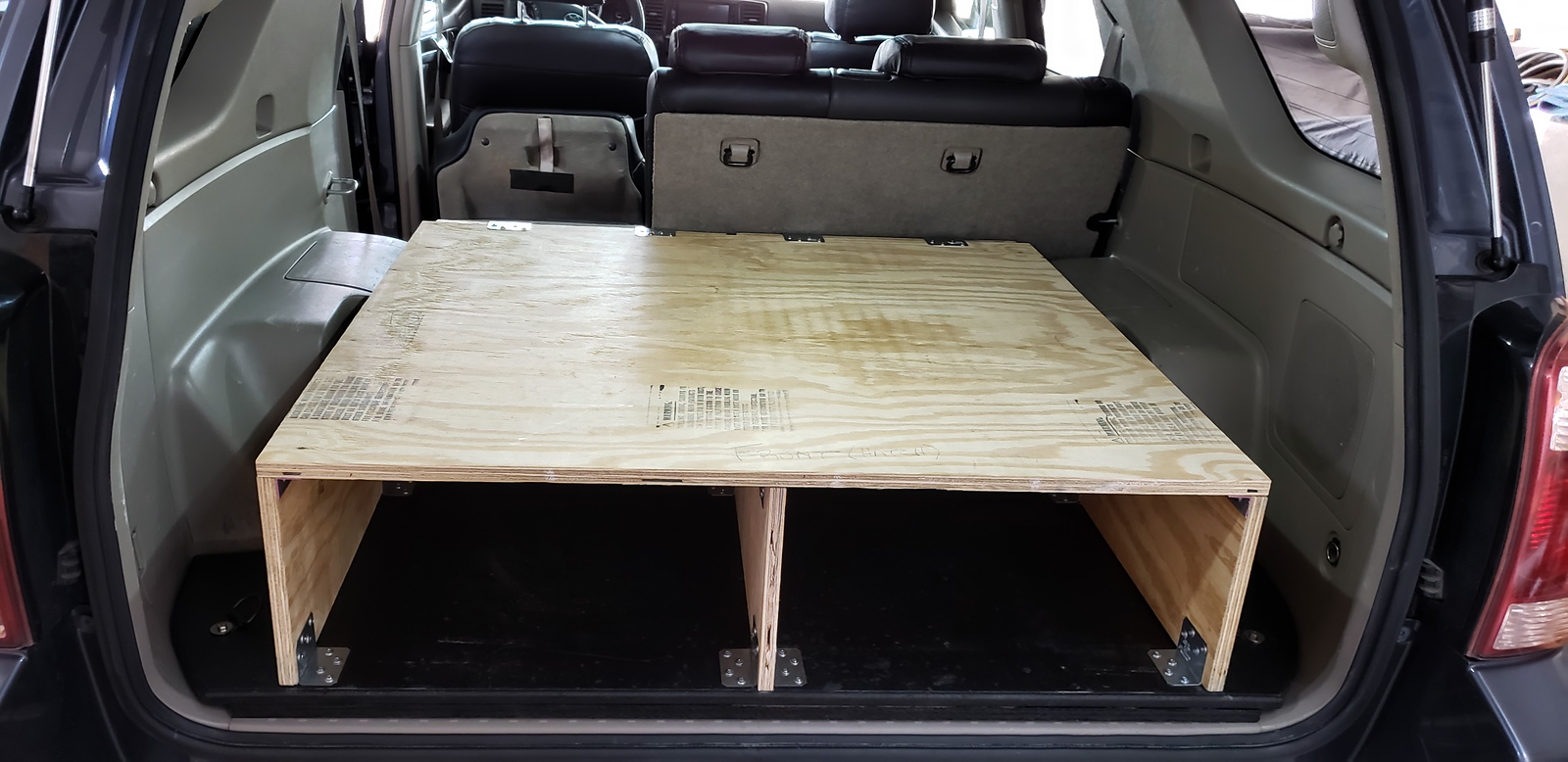

Today, I started building my storage drawers.
I really like the looks of that drawer box. I'm planning on doing something similar over the winter. One thing I want to mention that I'm going to account for, is I want to leave just enough room to get to the small access panel on the rear hatch. If your gate opener fails that's the only way to get the hatch open. I probably wouldn't even have thought about this but mine failed temporarily yesterday, (for the second time in 2 months). It's pretty common so I think it's important to be able to get in there. Just thought I'd share that. Looks good though. Gives me ideas. Thanks
Didn't know that. Haven't had any issues with mine yet thankfully. I'll have to look into that.
There are several threads on here about it. When you have time look through this 12 page one. https://www.toyota-4runner.org/4th-gen-t4rs/87913-help-rear-hatch-wont-open.html?highlight=hatch
I was just looking at how your box is built and it doesn't look like you would be able to get to the release lever and you sure wouldn't be able to move the box, lol. It would be a major PIA if that hatch failed. I wish we just had a manual hatch mechanism. Just thought I'd mention it in case you wanted to see if there's a way to factor that into your build. Good luck with it. It really looks good.
Awesome, thanks for the link. Easy enough to cut access to the release lever if needed right now.
I have drawers in the back of my Runner as well, and have always wondered "what the hell am I going to do if my hatch fails?"
I need to get to cutting a hole for this finally haha. Does anyone have a view of what to cut without digging in to find out?
I don't have a pic but you need to be able to get to, and put your hand into the hole behind the small square access cover on rear gate interior panel. You pop the cover off then there's a small white cover on the lock that comes off and you pull up the small lever and it releases your hatch. I know that's more than you asked but I got started and couldn't stop.:lol:

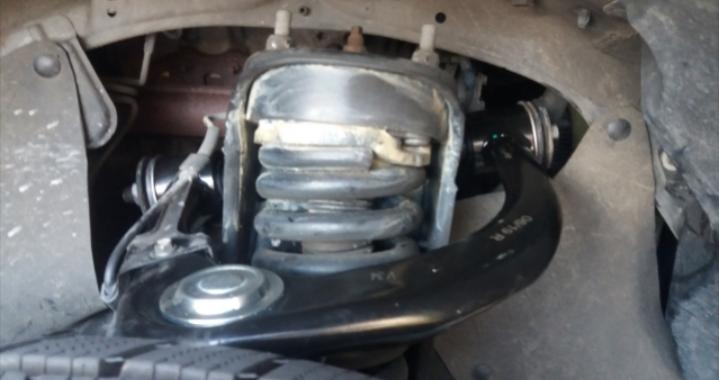

$30 UCA from rock auto.
Stock was shot at 190k and ready to fall apart on one big pothole.
1 hour job.
I figure for the price, I can replace it three times compared to the next higher priced one and it can't be that much worse. One more rattle to fix and I already have the steering shaft ready to go for that.

While I see the logic, things get a lot more expensive than a good UCA if this one fails suddenly, rather than gradually like the OEM did.

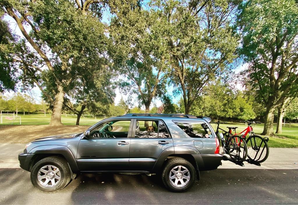

Finally acquired all the necessary parts to test out the new (to me) bike rack. The madden voyage around the block was a success!

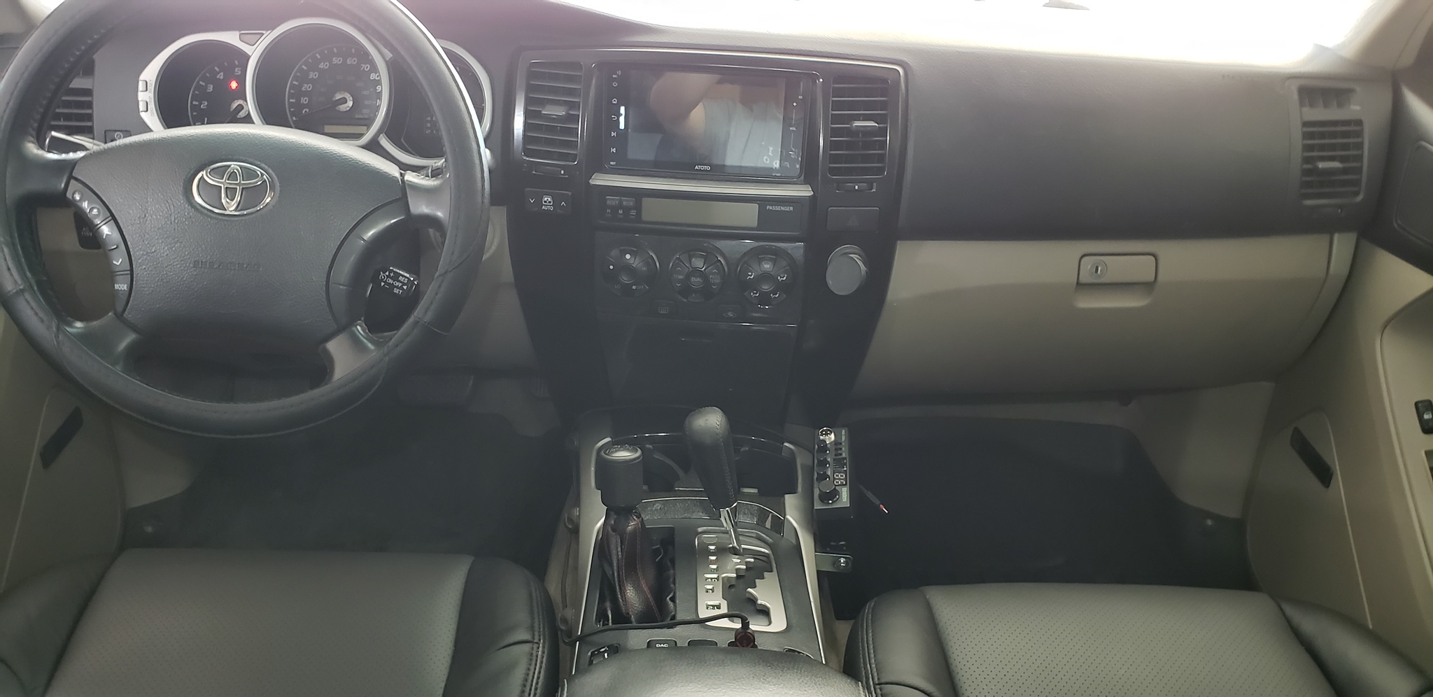

Is that functional?! I have excite
Of course. Why would I go thru all that work and not have a functional transfer case?
Finally got it done? What's your experience so far?
Sent from my SM-G986U using Tapatalk
Waiting on the driveshafts still, they won't be done until Thursday or Friday. Front shortened and rear lengthened for the FJ tcase. I just finished it up today, except for doing the wiring to get the 4WD and 4LO dash light to turn on. Worry about that later.
The tcase is a direct bolt-in. The "hard" part is cutting the hole in the trans tunnel and modifying the stick to come out where I have it. Just takes time and patience. I do have twin sticks for it but wanted to go with the J-shifter for now. Might swap the twins later.

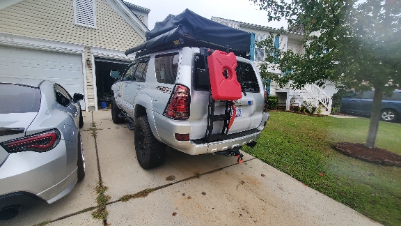

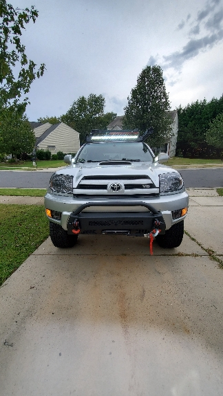

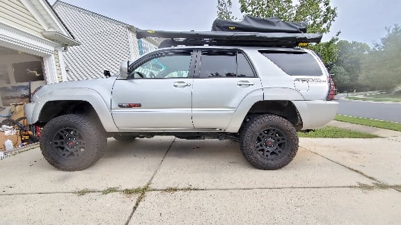

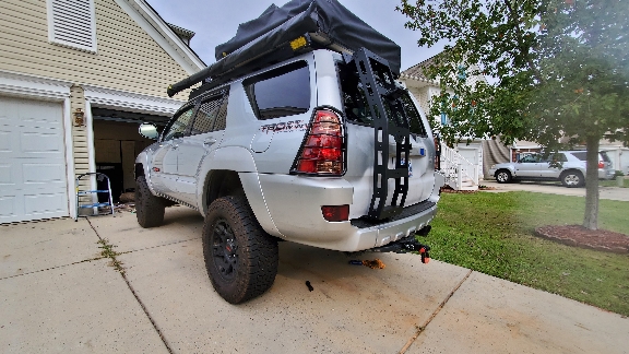

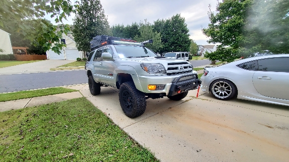

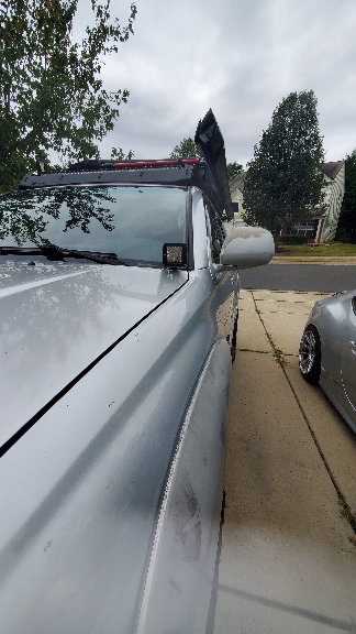

My just-finished look didnt last long..

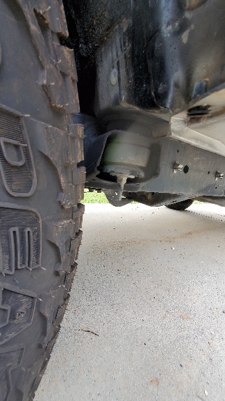

Spent some time last 2 weeks installing the diff drop (surprising difference, my cvs are just about parallel), rebooting both axles, sway bar relocation. Installed the victory 4x4 ladder, gas can, relocated shovel mount, blah blah blah. Then I pulled off my spidetrax spacers and listed wheels for sale. Have a guy coming to get them Friday.

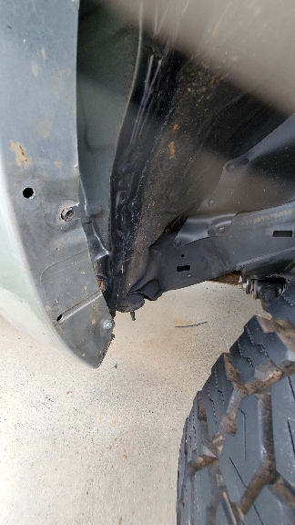

With that said.. i also installed a 1" body lift, pulled off the nfab steps, did an aggressive body mount chop (not welding it in, cant see too much of a point from a structural perspective.. ), cut and beat in the pinch welds in the fender, trimmed the fenders a bit, did the front diff fluid change, installed some ditch light pods, etc.
The tires have delivered and wheels should be here tomorrow.. pretty excited to go to 35s... but it was a late night wishful decision when I couldn't sleep...and well...35s...here I come... lol
