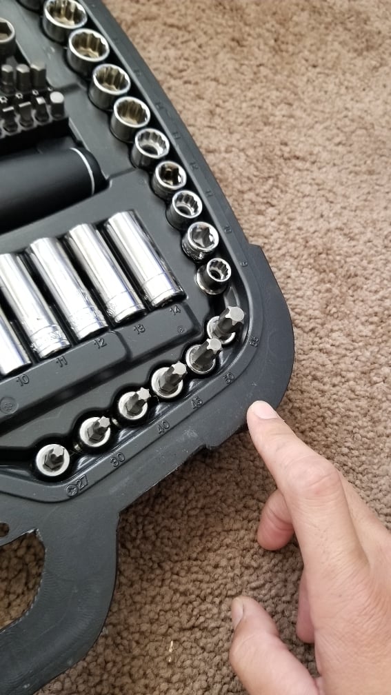

Although a torx bit will fit, its technically a 10mm allen key/male hex socket. Awesome that you were able to get yours out, California rust free must be nice lol. Me not so much, had to weld a nut on mine. Posted a pic a few replies up
Ah I got lucky then, glad I didn't strip it. Thanks for the correction.
Yes, luckily I don't have to deal with rust. I feel for you guys in the snowy areas.
Sent from my SM-G955U using Tapatalk
You need one of these. Not sure of the name. But it came right off with ease.
I am using a 10mm hex socket. Soaked it in PB Plaster, hit it with some heat, hit it with a hammer while turning it. Still won’t budge.

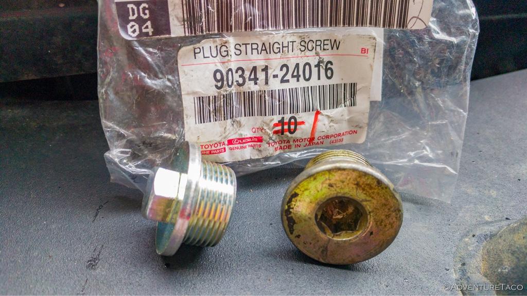

I’m changing mine with 90341-24016 from a Lexus GX. It’s the same size but instead of a 10mm hex it’s a 14mm socket. Not my picture but here’s an example
I gotta get one of those, I warped my plug flange welding to it and it started leaking. I rtv'd the crush washer as an experiment when I had it back apart to replace a CV and it hasn't leaked yet lol
Changed diff and transfer case fluids with Mobil-1. Can’t get the drain plug off the front. Made an appointment with the dealer to take it off. Purchased a Lexus GX diff plug, which uses a socket.
If you don’t already have an impact gun, might consider getting an electric one (unless you have a compressor, in which case you probably have an impact).
Not 100% sure but looks like it would fit to get that plug.
And it will come in real handy for other DIY jobs, especially if you have rust.
Don’t have to spend a bunch if it’s just being used for occasional DIY.

Hit it with my brushless impact. It’s only a Ryobi but it still has decent torque. The plug didn’t budge.

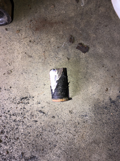

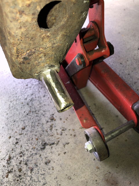

Rear shock mount sleeves on both sides were rusted/seized to the mount.
Tried to pry and beat them off, no luck.
Used a jaw puller to pull them off, but just tore the rubber bushing off and left the sleeve still seized to the frame mount.
Tried for quite a while to beat it, rotary hammer drill w/chisel to the tiny crevice at the back of the sleeve, Kroil, heat, more beating, jammed an impact socket on it (didn’t have an extractor socket that big) and hit it with an impact gun hoping it would break loose.
Would budge a bit.

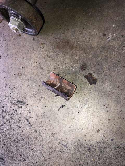

Finally broke out the grinder.
Started at the top and started slowly shaving it off. Didn’t cut straight in as I didn’t want to cut into mount.
Once I ground through the sleeve I could see a line differentiating the metal sleeve from the mount.
Used the line as a guide as I worked my way around shaving/grinding the metal sleeve and not shaving off the mount.
Shaved down on both sides from the top until most of the top half of the sleeve was gone.
At that point I was able to tap the edge of the remaining bottom half of the sleeve and it fell off.

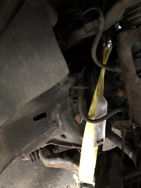

Then on the front struts the top plate of the strut mount was rusted/seized to the housing.
After trying everything I could think with no luck, finally got the idea to use a ratchet strap with one hook around the top of the spring (wedges against the strut housing) and the other hook to the frame.
Cinched it down extremely tight. Got the top of housing nice and hot and a couple whacks with the hammer and it popped right off with the downward pressure from the strap.
What an ordeal, on what normally is pretty straightforward.
