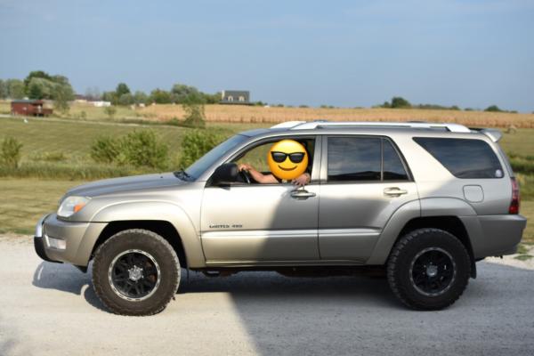

Did the suspension on my wife’s 2007 Limited. KYBs all around with Moog coils in the rear. Lifted the front 2 inches, should settle to about 1” lift. Rotated the tires too. Love it, rides excellent! <a href="https://ibb.co/w770w3c"><img src="https://i.ibb.co/KDD0LRK/45-A40050-BDA3-4-A45-8024-94-A079-CA227-A.jpg" alt="45-A40050-BDA3-4-A45-8024-94-A079-CA227-A" border="0"></a>

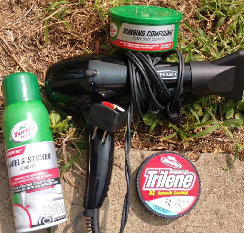

Did the old de-badging of the car today. Not a big fan of fake chrome nor just random badges and old dealership badges that are put on cars. All about the small details for me. Near future ill be getting the rear hatch chrome paint matched as well as the door handles. Don't need to show the process as its super simple. Followed the video on youtube that AMMO NYC put up. Spent maybe $30 total on the compound which I already had, the solvent for removing the glue and fishing wire, borrowed moms hair dryer. Super simple and took maybe an hour.

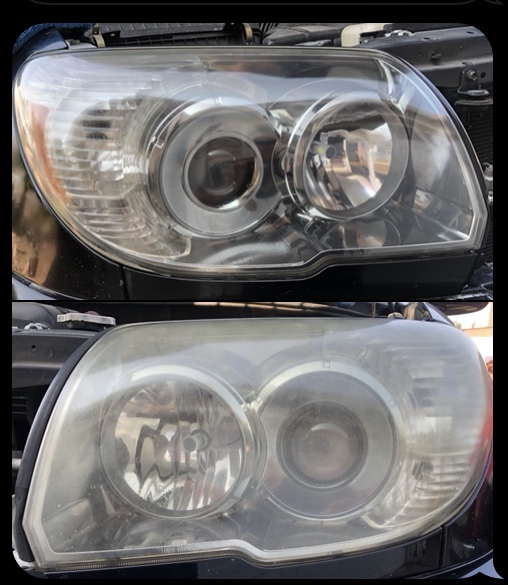

Polished Headlights
They were Not Horrible but it looks way better
