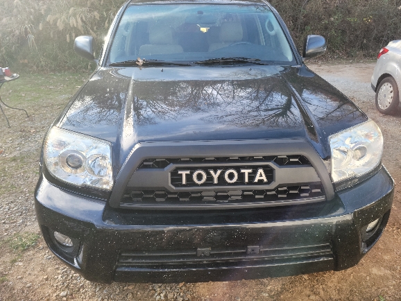

Cut out interior pieces of grille and sanded down the insides. Bought a knockoff tacoma grille off ebay for $70 and cut it up to get it into 4th gen grille "shell". Used some glue and zip ties to hold it in place after. The sanding/cutting of tacoma grille is tedious so you don't take off too much. Also the tacoma grille is straight, while 4th gen has a curve in it so you have to work it a bit. Overall, happy with how it turned out and did it for less than $80 while SRQ sells them for $500+.

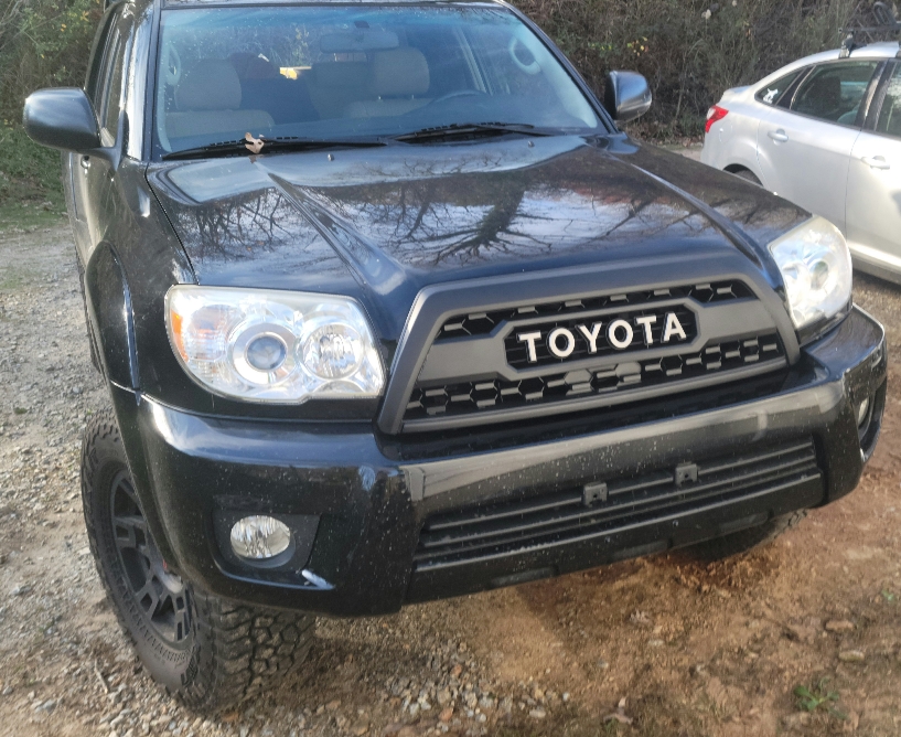

It has been a couple of months but I finally finished up my Satoshi grill. Kinda hard to get a good shot with the black on black so here are a few pics.
That thing is so murkd it appears to absorb light like a black hole!

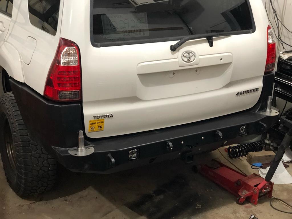

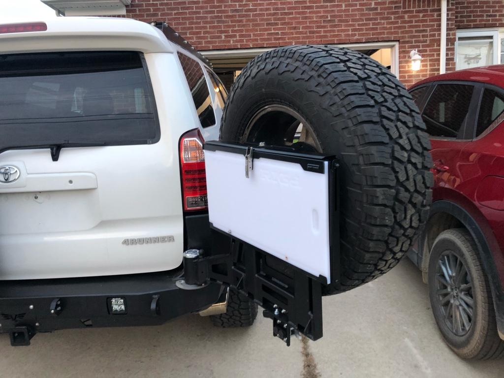

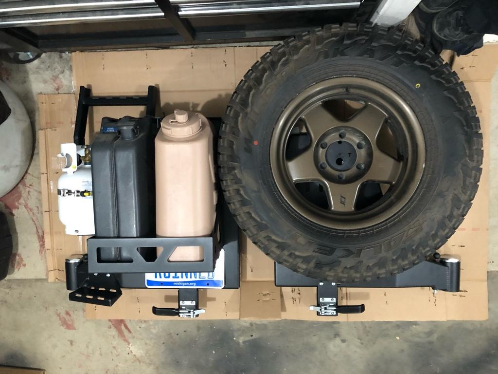

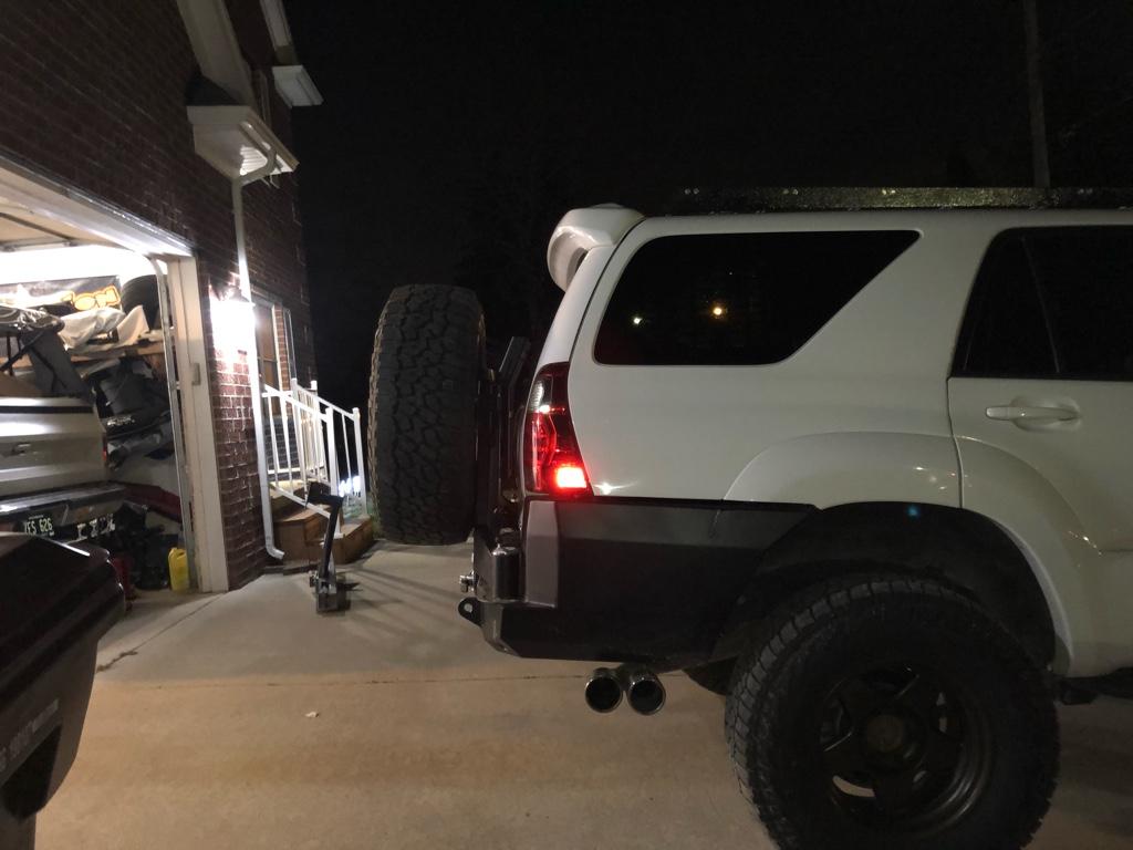

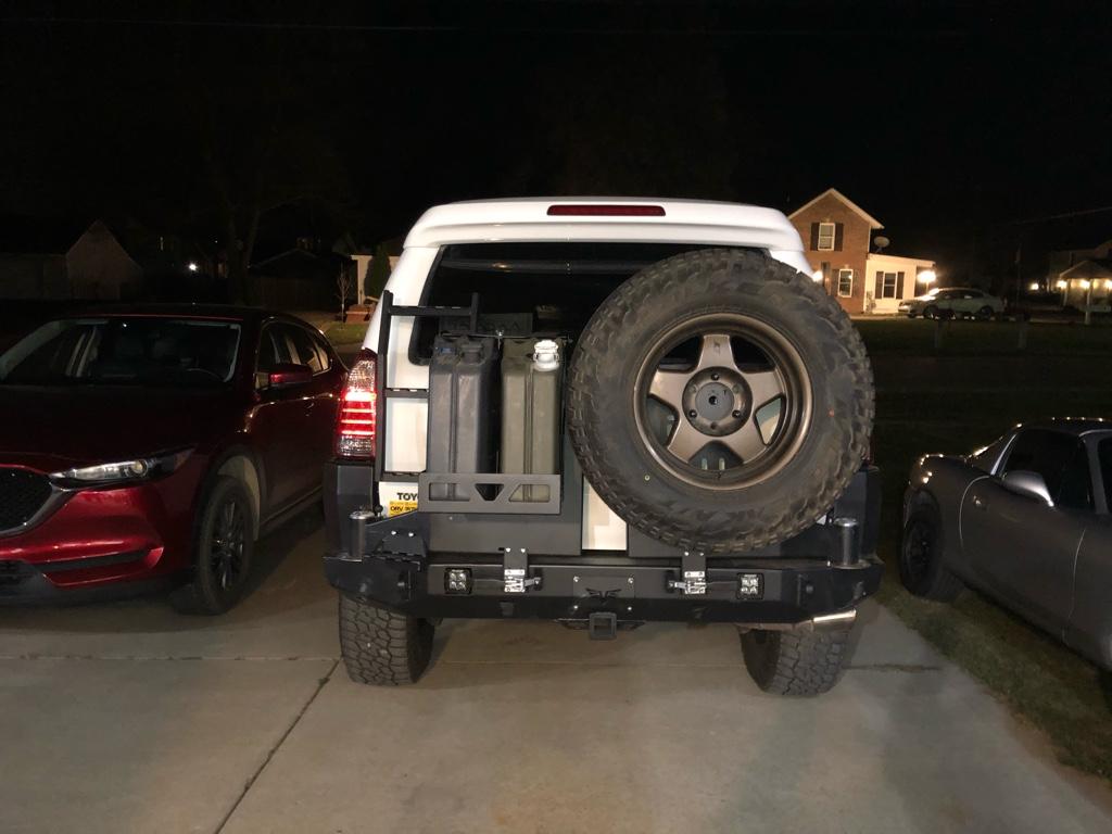

[MENTION=275542]RivMan[/MENTION], how'd the install go?? I have the same bumper coming in the mail!
Pretty good, with a few really frustrating parts!

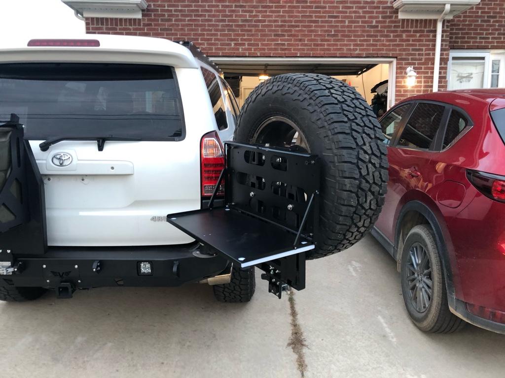

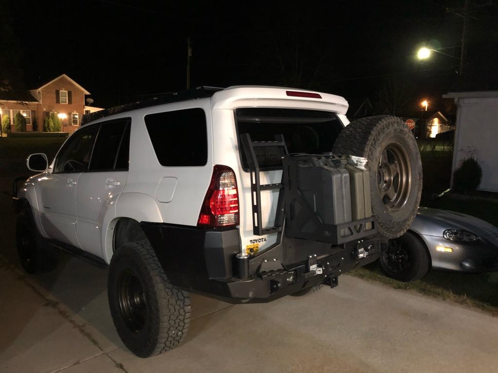

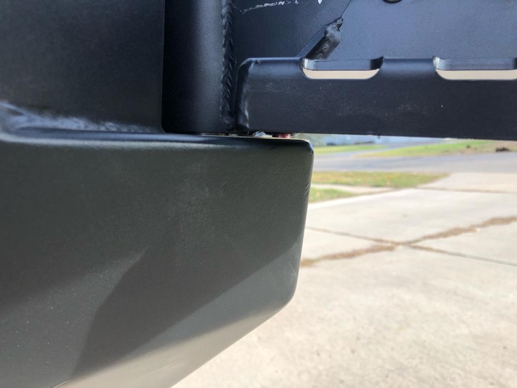

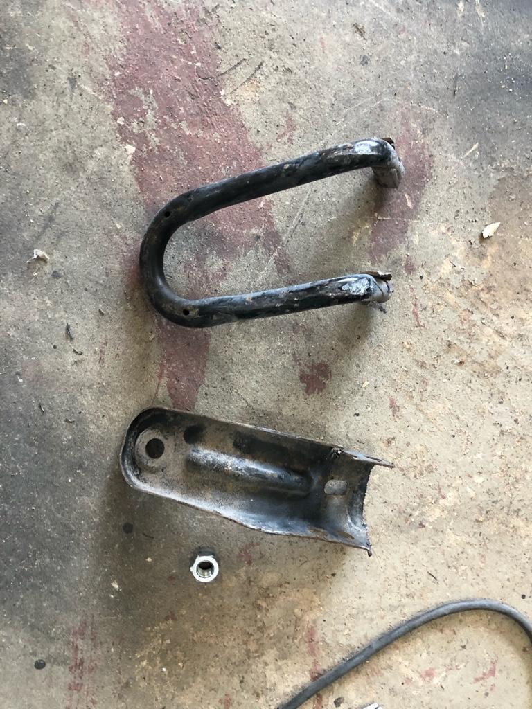

There are a couple brackets on the frame that need to be hacked off before install. Victory’s video didn’t mention them at all. I picked the bumper up at their shop with the plan of throwing a couple bolts in to get it home. Had to tweak the brackets with the BFH in the parking lot to fit it in place.
The fit on the bumper is great, everything seemed to line up perfect for my test fits.
When it came time to install it for good, I could NOT get one side to line up properly. Turns out that one of my pod lights was hitting the frame rail. I ended up forcing it into place, but the light is misaligned, and I’ll have to pull the bumper to hack it up for clearance. The pod light holes aren’t slotted, but they should be for adjustment.

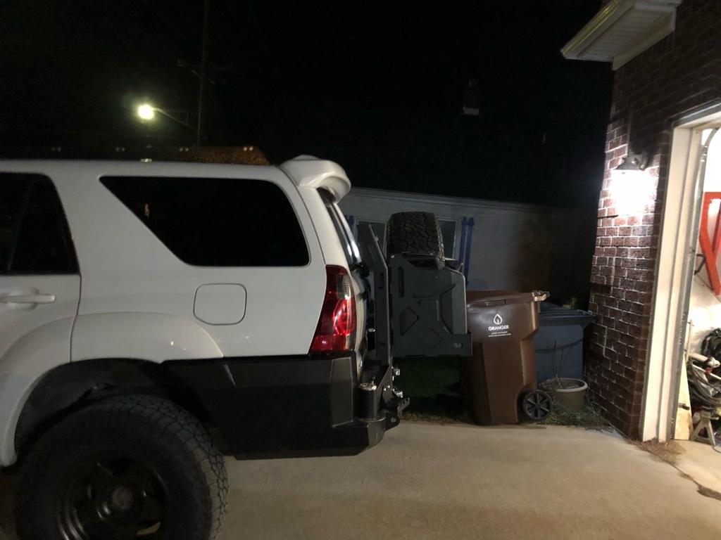

If you have adventure carriers, you have to install the latch catches on the bumper before putting it on the truck. You can’t get to them after it’s installed.
If you have the ladder, the bottom step will hit the bumper when you open the carrier. I bent mine up to clear, but Victory will need to slightly redesign it for better clearance.

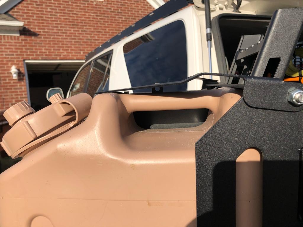

The Jerry can carrier also doesn’t seem to fit the Scepter water jugs, I have a note to Victory asking about that.
The powder coating on my bumper seems a little thin / under cured. It seemed to crack / chip off a lot easier than I’d expect, be careful with it.
I also installed my Front Runner table, this is going to work perfect!
-Rob
Looks awesome.
Thanks! It’s sweet so far, I’m really happy with it.
Another note, the tire carrier uses 1/2-20 lug nuts, and includes a few acorn nuts to match that. Those won’t work with most aftermarket wheels, I had to make a last minute run to the auto parts store and buy a $33 set of spline drive nuts.
