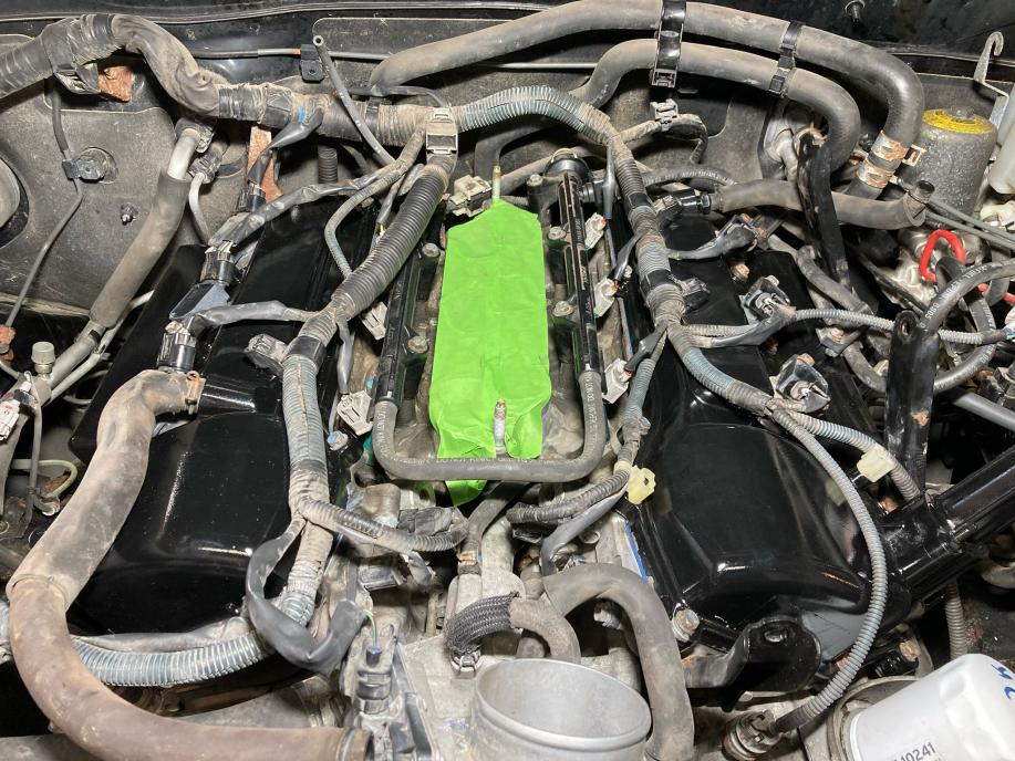

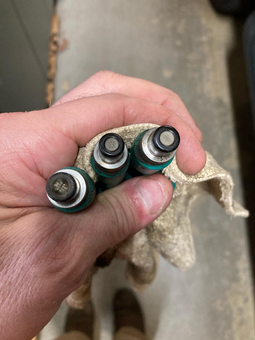

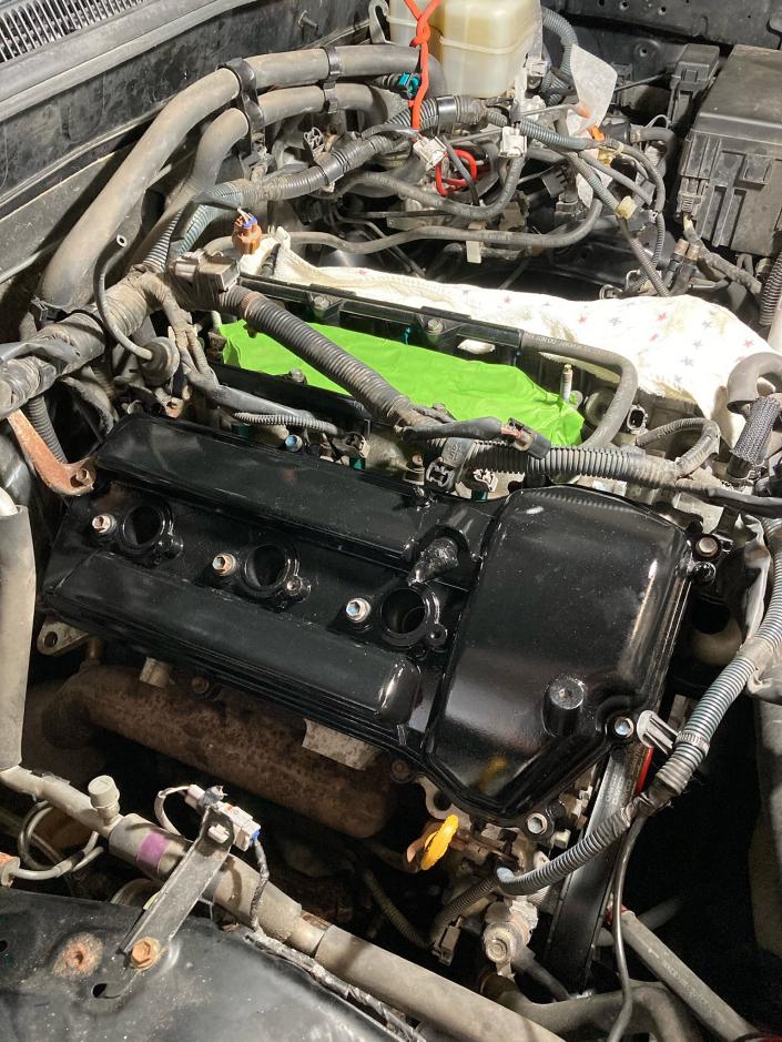

Spent the weekend, on and off, replacing the intake plenum gasket, # 2, 4, 6 cyl fuel injectors, and valve cover gaskets. Sprayed the valve covers black while they were off. My LTFT bank 2 is running lean under load and adding fuel while bank 1 is normal. Looks like my injectors are partially clogged, #6 worst of all.

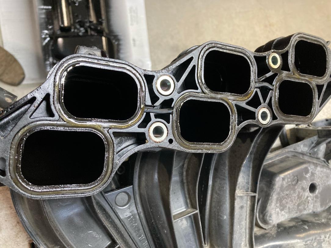

What I did today - intake gaskets
Tried to post the picture of the endoscope smoke test I just did clearly showing a brittle broken lower intake gasket. Crazy how much smoke was coming out, hopefully that will take care of the miss fires I was getting.
