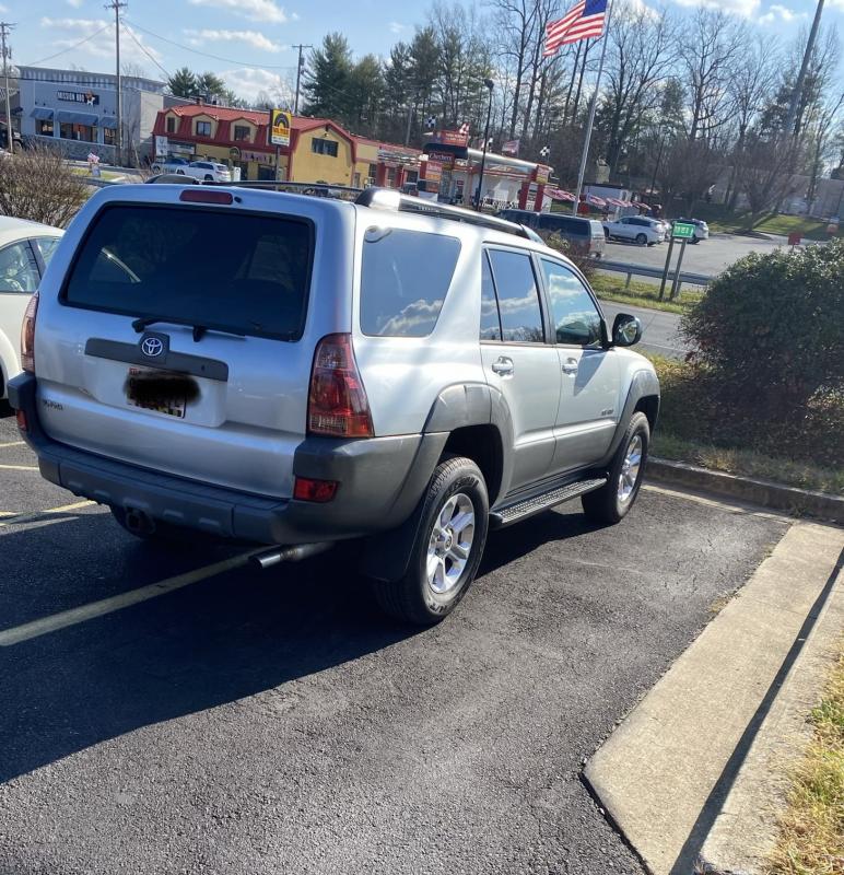

Finally took some time to paint the rear door that was fixed and primered some months back along with all the plastic trim around that was faded bad from spending most of its 17 years in Florida.
Neighbors looked at me pretty funny..

Looks very good!
What brand paint did you use and where did you buy...did you use spray cans or paint gun, did you do a clear coat after color coat?
How much paint did you use?
What brand of paint did you use and how did you spray it? Looks like you did a great job laying down the metallic flake to get it match well.
looks good. Ive done some weird shit in my driveway, including painting an area on the inside lip of the hatch, so I know the looks you're talking about

Looks very good!
ATX paint, I can look up to see what paint code exactly I used, they have quite a bit of variants that pull up under my cars paint code, but we went with the default and it matched pretty close.
I bought it from a local sherwin williams auto supply store where the shop my brother works out sources a lot of their stuff. I bought 2 quarts and thus far sprayed out 1 entire can using 1:1 reducers. I had JUST enough I feel like to cover the trim (excluding the front bumper) and the entire rear gate in about 3-4 coats.
and it was definitely sprayed with a gun, I've gone the spray can route before and it is harder, longer, more expensive and not even worth the comparison result wise..
I sprayed 1 light coat of clear and about 2-3 (depending on the area) heavy wet coats that were wet enough to ALMOST have some runs so that it flowed out nice.
Thanks! It was my 3rd-ish paint project.. so I'm getting half decent at it.
I used ATX paint and need to look up what brand clear.. it was all medium-grade stuff. Not Finish1 or anything like that, but definitely not the cheap stuff. All sourced from Sherwin Williams Automotive locally.

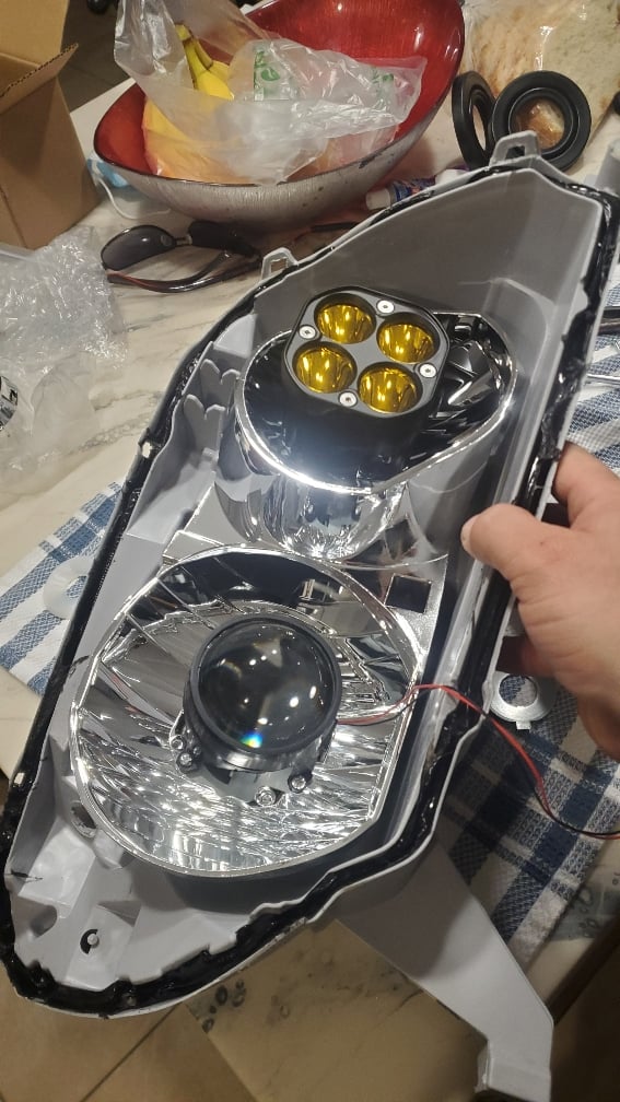

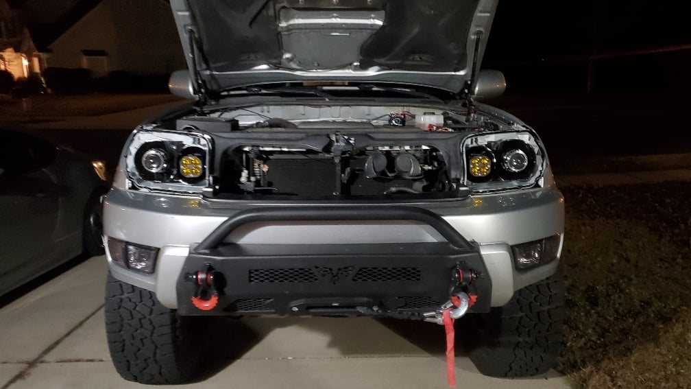

My first iteration of the projector upgrade wasn't really good, and I stripped my adjustment screw while aiming the lights so im onto headlight build 2.0 now.
Since the acme projectors have a built in solenoid for the high beam all in one housing the oem hi beam location was free... and ...well you see.. what happened was a late night impulse purchase..

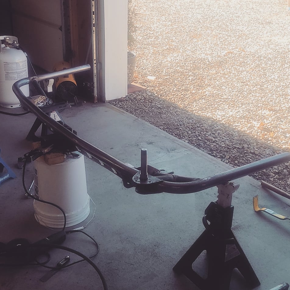

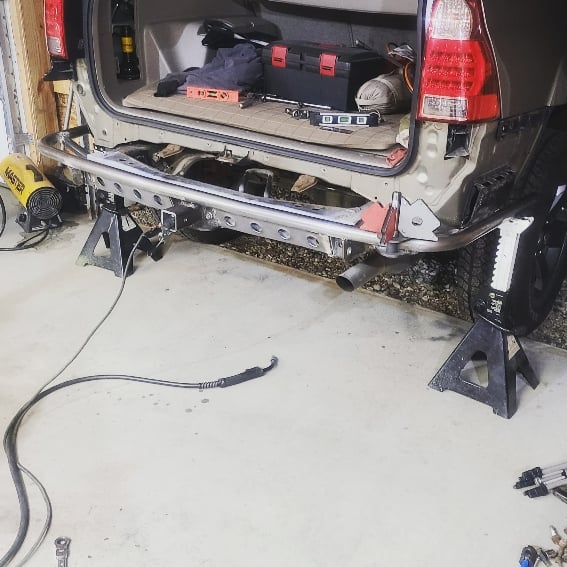

Been working on this for about a week. All thats left is drilling and tapping the holes for the latch before I retrieve the bumper, add mudflaps to the bumper, mount the license plate, and run the wires for the lighting.
This is turning out killer, keep us posted with some final install shots after its painted and mounted. I'll keep an eye on your build thread!

Which pods did you use for the high beams?
Sent from my SM-G986U using Tapatalk
its a cheap, $60, amazon pod
Amazon.com: 3E LED Yellow Driving Fog Lights 2Pcs 3Inch 40W Waterproof Driving OffRoad Work Lamps For Wrangler Offroad 4X4 Auto Car Jeep Truck ATV UTV Boat Motorcycle bait: Automotive
I wasn't sure if it was even going to work with fitment and what not and I don't anticipate using them all too often on top of being inside of a pretty-much-sealed headlight housing with no moisture so I figured they'll hold up OK.
That looks like peanut butter haha
