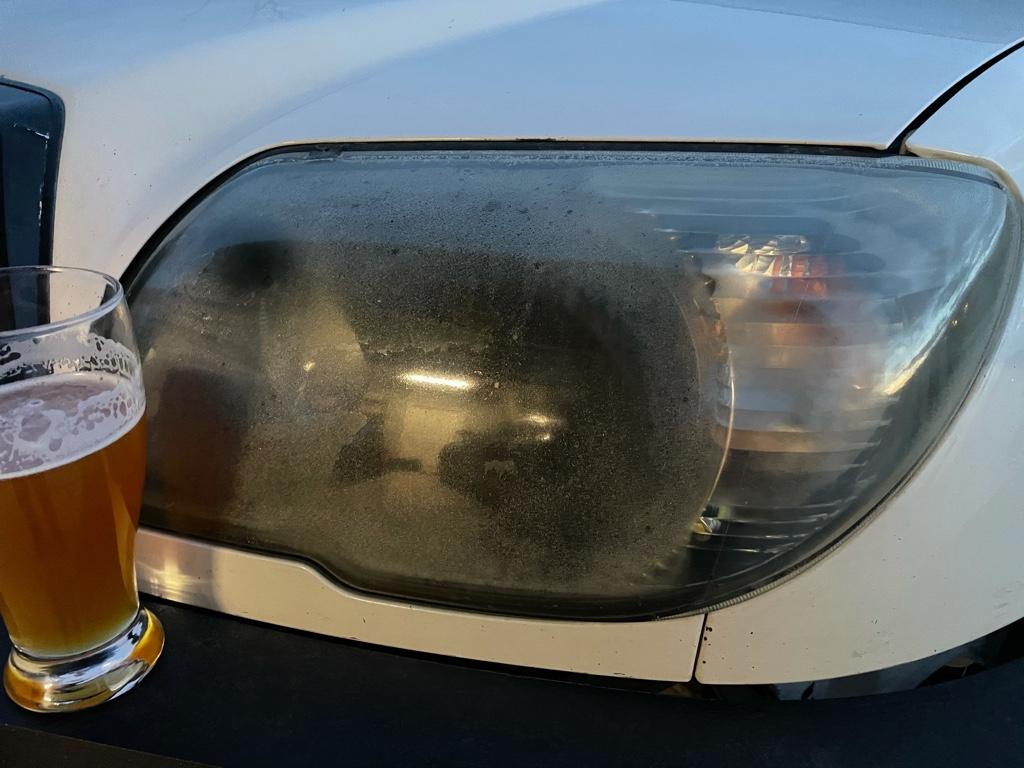

FML, noticed this yesterday after some hail and snow. Don’t know if I should dry/reseal or just replace.
Other side still looks good!
Use a hairdryer or park your truck in the direct sunlight for as long as possible with constant light. Should dissipate and once it’s all gone, remove the light from the truck and run a bead of RTV or Silicone around the whole thing. Chances are high that moisture got in one of the bulb locations. Easy fix but if it persists, buy new light as they are fairly inexpensive.

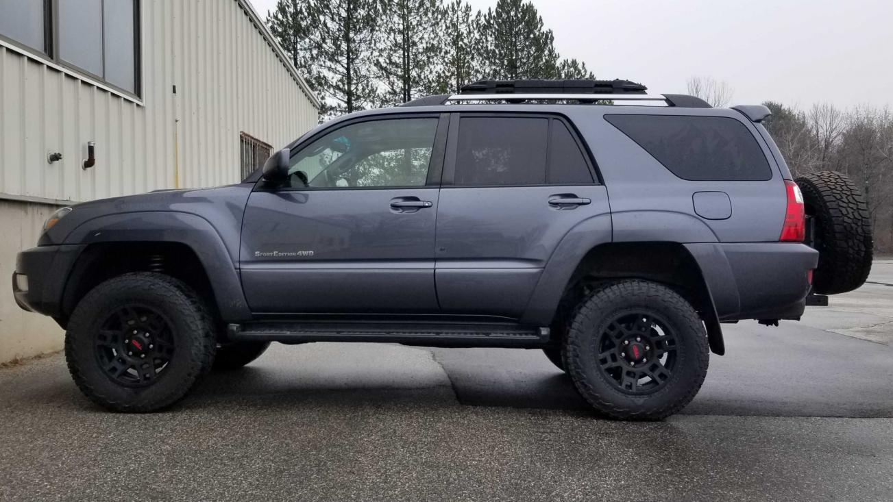

Installed rear Toytec RCC2.0HD springs and moved the front Bilsteins from stock up a notch with my existing Toytec 2" springs. All to compensate for the hitch mount tire carrier (and boat towing this summer)

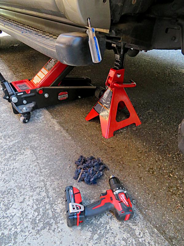

But here's somethin' with the 4R that provides a little entertainment value to a Sunday. Needed to tighten all four wheel spacers after about 100 miles since installation. Figured while I had the front wheels off it was a good time to remove the mud flaps. Upon removin' the passenger side, it became apparent that there was a bunch of debris, including sand, packed into the lower body edge behind the mud flap. (Where the screwdriver is shown stickin' in.)
Turns out some damn mouse, before my ownership, thought this was a dandy spot to nest up. Used what looked to be chewed up blue insulation and/or blanket. I say before my ownership because of the apparent road sand packed into the mess - loads of it - and it's not used here. Nor have I driven it in sand. And the prior owner's cabin air filter was mouse chewed, replaced now with a HEPA filter. Looked as though these mud flap nest materials plugged the bottom body holes where sand might've been able to fall or wash out, makin' a perfect setting for accumulation of moisture and rust.
Sure not a predictable place for a mouse problem!
Sheesh.

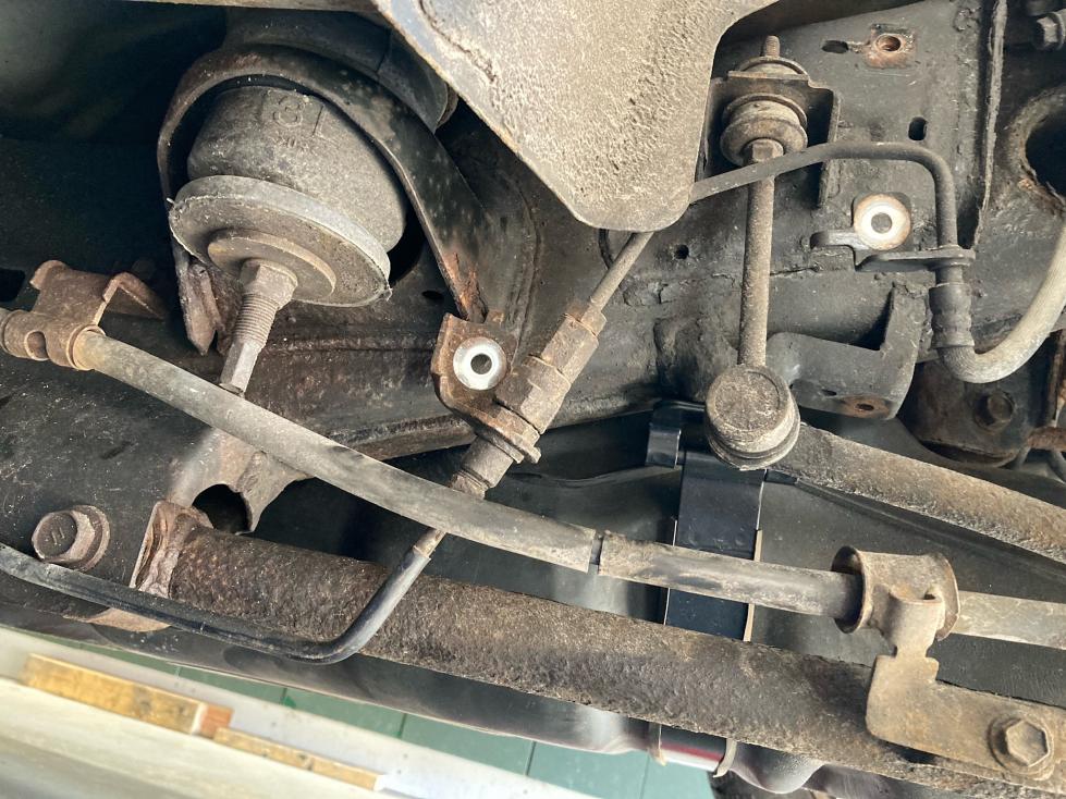

. Replaced the 2 rear hard brake line because they were shot.
