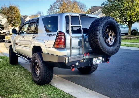

Swapped out the XREAS for TRD off road Tacoma spring/struts and rear shocks. Added 1.5" spacer in the back as well.

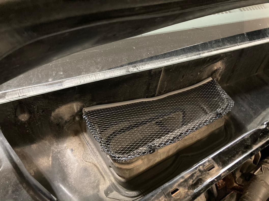

Spent a few minutes tonight adding a mouse guard on my ventilation air intake.
I used some extra coated steel gutter leaf guard which just happened to be black and added a split silicone vacuum hose to protect the firewall paint.

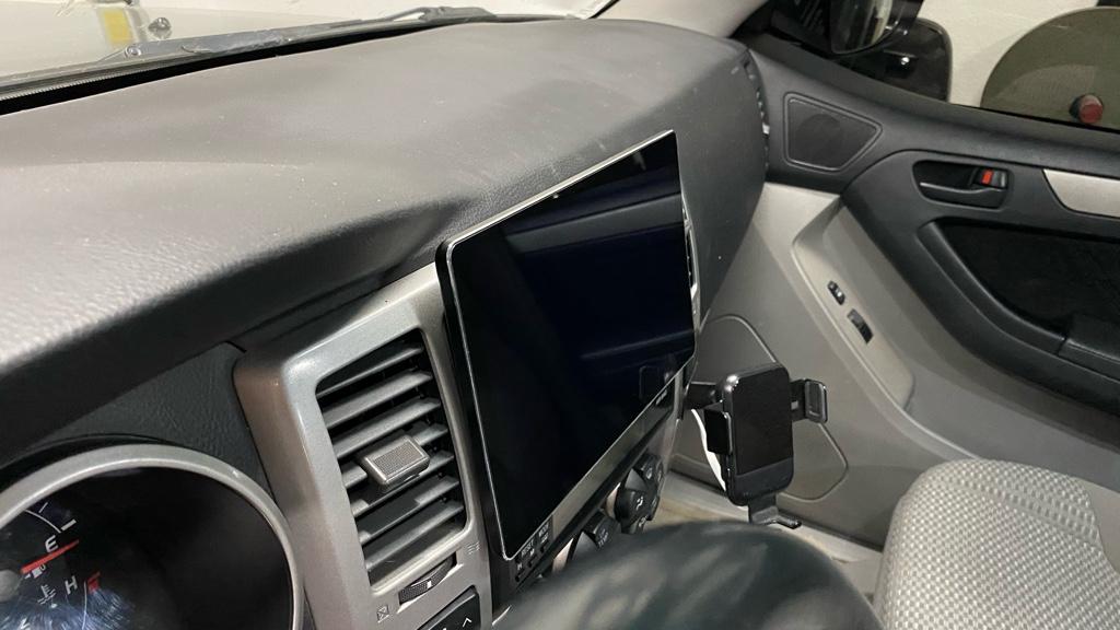

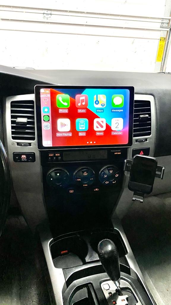

Installed a 10.1” Joying head unit. So far, so good. I still need to run the backup camera but otherwise I’m happy with it.

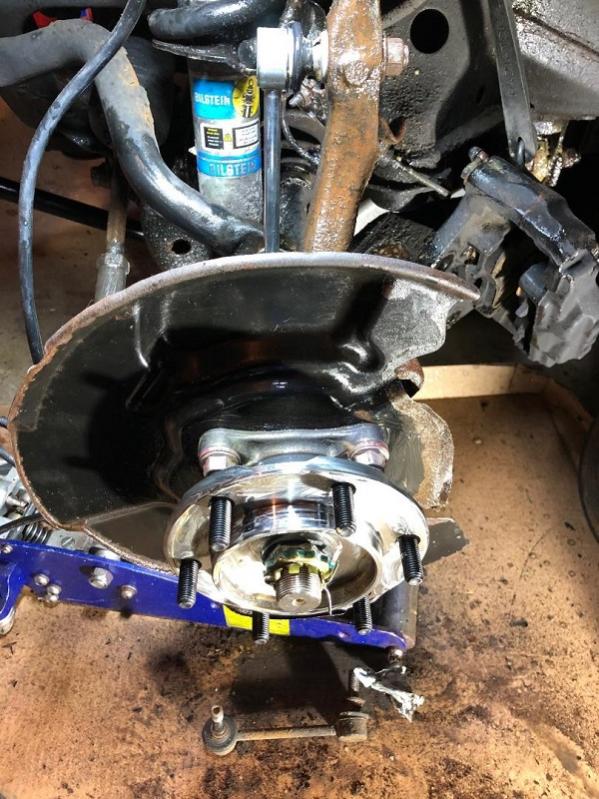

Installed Blue Pit hub assemblies on the '05 4Runner, and replaced the sway bar end links because I kept getting a clunk going over pot holes. Turned out the mysterious 4Runner clunk was the air box bumping against the fender due to the foam filler around it being shot.

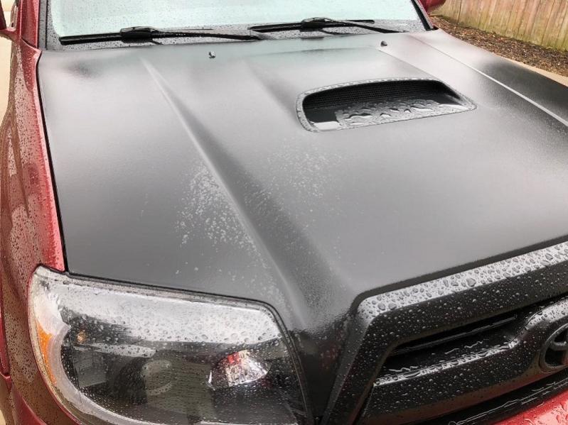

Also painted the hood on my '07 with bedliner. The Arizona sun destroyed the clear coat.

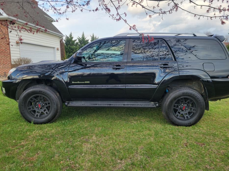

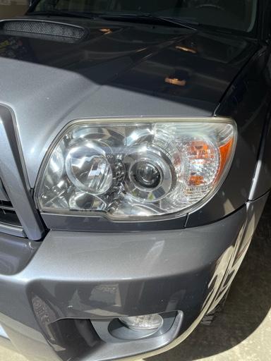

I put on some new wheels and tires today. Well at least new to me. A few weeks ago I was able to pick up a used set from a 2020 Tacoma. I also polished out the yellow headlights using a 3M restoration kit.

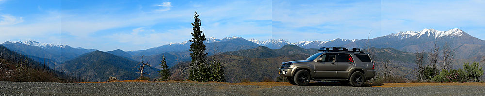

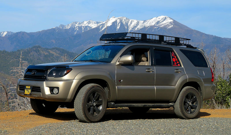

Took the dogs for a Spring spin up the mountain from the house. Looked for morels and oyster mushrooms on creekside alders, hiked a little, the dogs swam in ice cold run-off, and I practiced with the Kimber.
Easy, fun drive in the 4R, 'though we did have to dodge fallen trees and rocks while drivin' through forest areas burned in '17. Calm, beautiful weather today, but not a place to be on a windy day. Next time I'll pack a chainsaw. :lookout:
