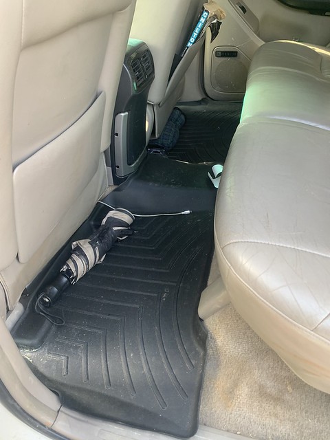

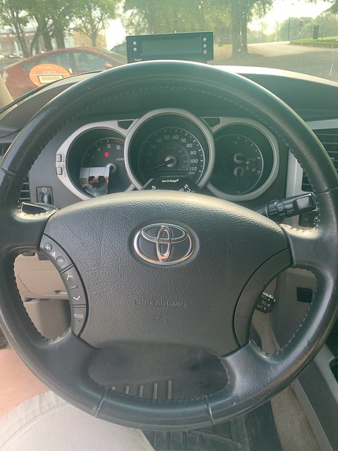

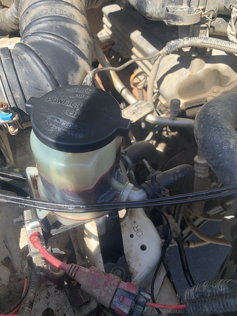

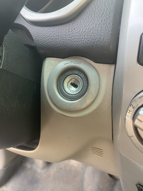

Got some goodies from the junkyard the other day: got a good condition steering wheel, the plastic ignition trim ring, and scored a second row weathertech! Also got a clean power steering reservoir since I couldn't see through mine.
While I was replacing the power steering reservoir, I replaced some cracking hoses and flushed the power steering following this writeup:
DIY: Power Steering Flush (4th gen specific)
Here's part numbers for the hoses, I just used whatever was cheapest on Rock Auto:
PS Reservoir to PS Pump: Sunsong 3404929
PS Reservoir to hardline: Sunsong 3402985
PS Reservoir to Hardline
Not pictured, I also replaced my blower motor since it was squeaking a ton. Glad I was able to get a lot done!

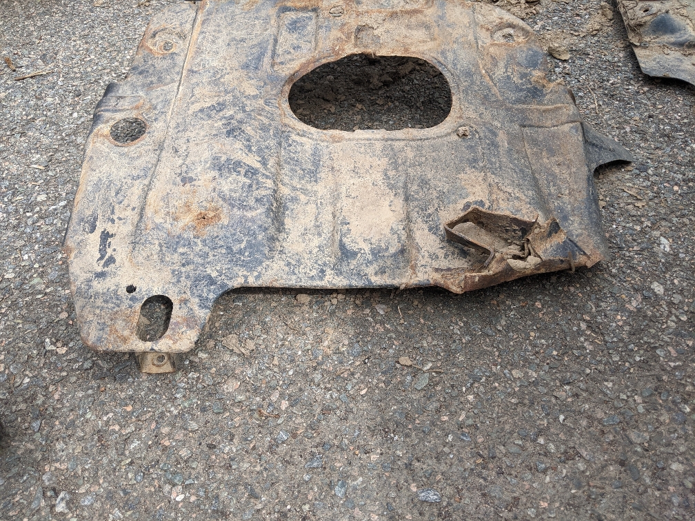

Throw it on now, the front stock skids are pretty weak. Especially the one under the oil pan, its like paper thin.
you right you right!
I did a whoopsie without even trying lol. A single piece to replace the front two skids skid is also going to prevent this from happening, since there won't be a seam to grab.

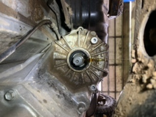

I was able to get my front brakes replaced along with sway bar bushings. Failed trying to get the front output shaft seal replaced. I was able to get the front driveshaft off but couldn’t get the nut off of the flange for the T-case. Not enough leverage or torque! I’ll try again this weekend on a lift. My spring compressor should be here tomorrow and hopefully I can get my front coil overs done and total chaos UCA’s rebuilt next.

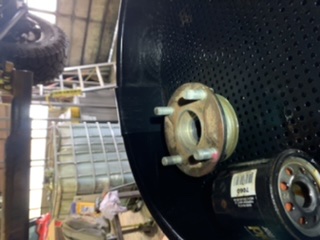

Got my front output shaft seal replaced. Things went way smoother with a lift. Sorry for the wonky pics for some reason this place flips them all weird.

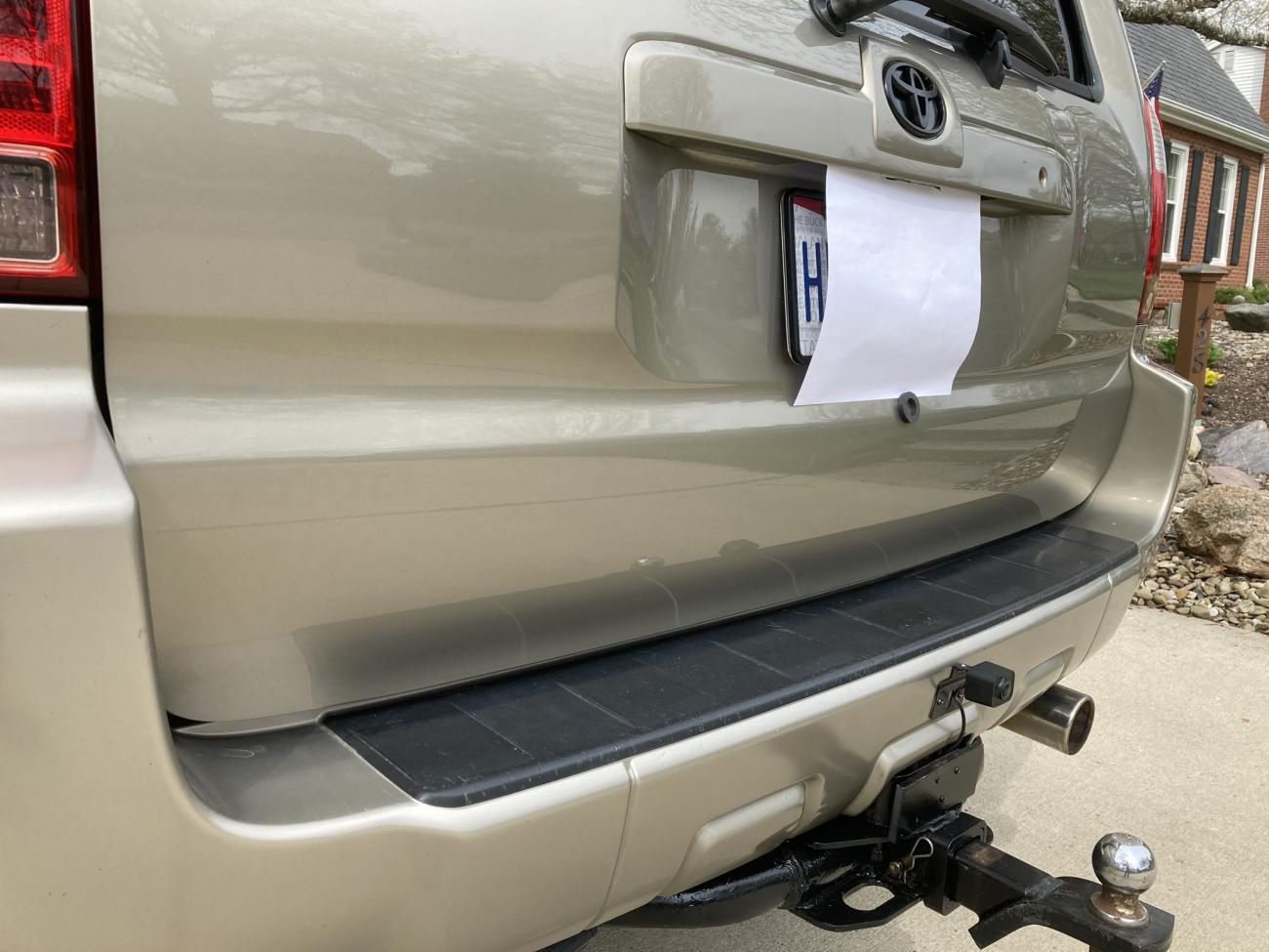

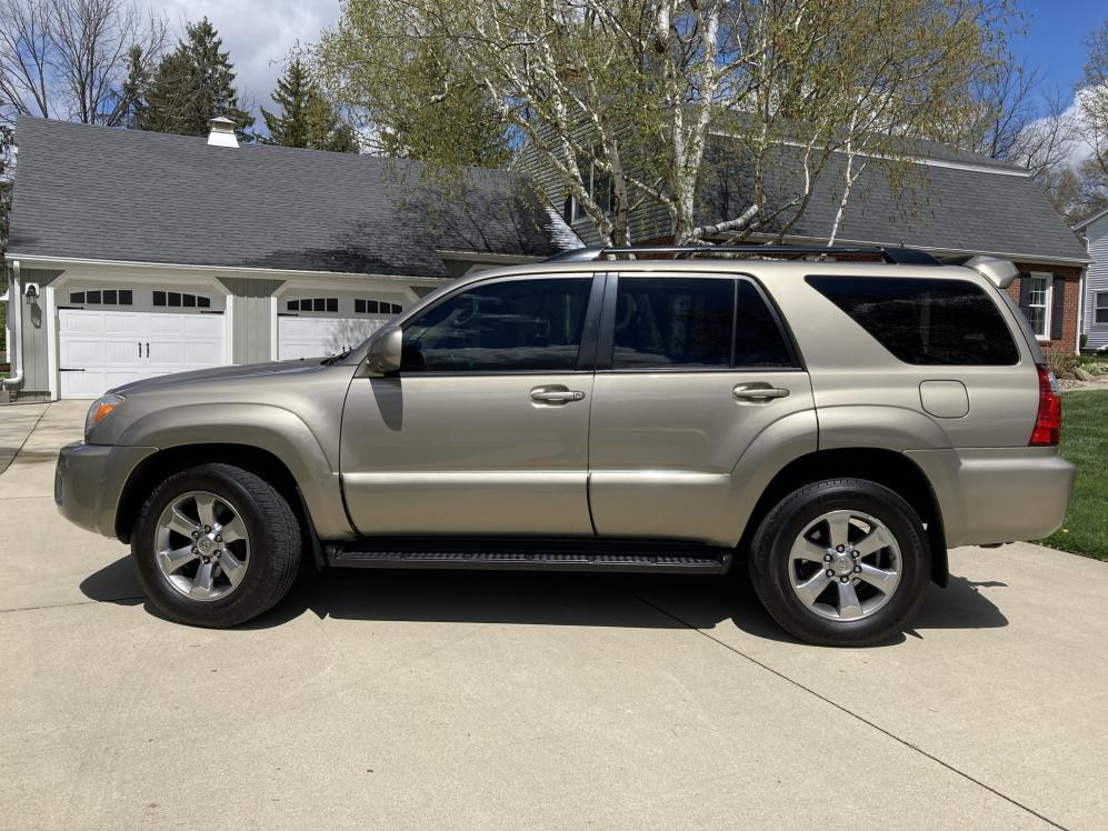

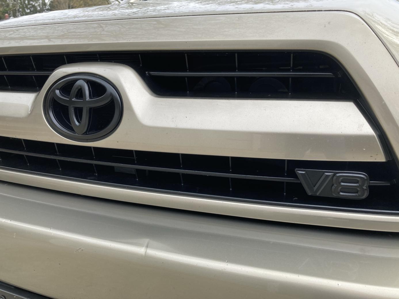

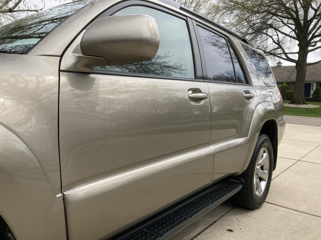

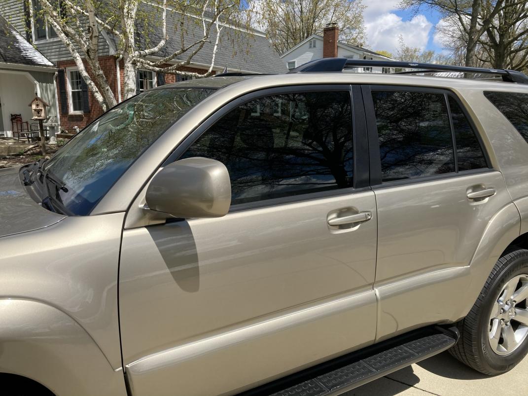

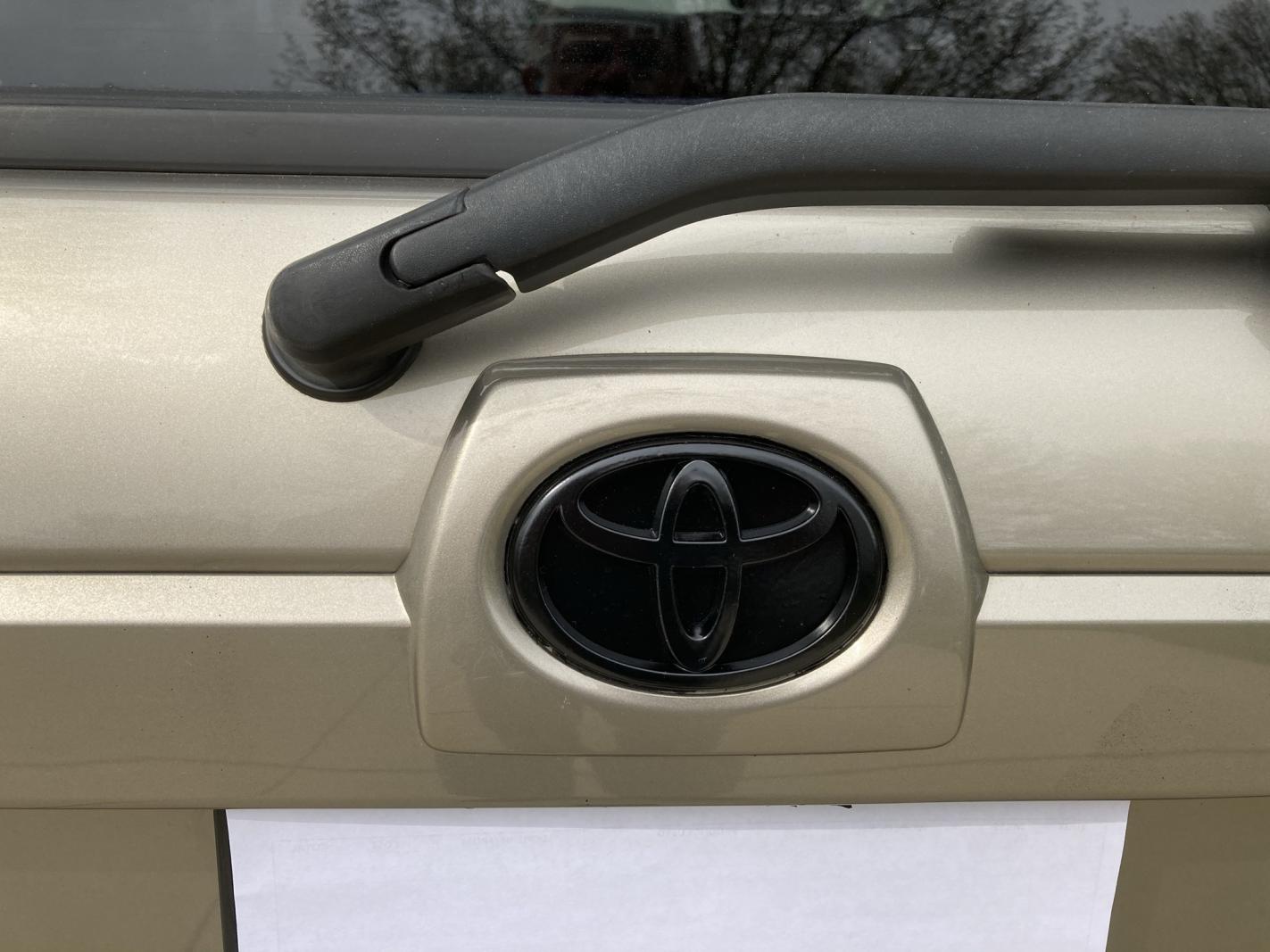

A little paint and a de-badge
I considered doing the Plasti-Dip on my front and rear emblems but ended up painting them with primer and then a semi-gloss black. I like how it turned out. Then I got brave and de-badged the tailgate. Being my 4Runner is 14 years I was afraid that once I removed the letters there would be the infamous “ghosting” of the letters on the paint. Well.....I am happy to report that it was possible to get rid of any “ghosting”. Once the letters were removed (with a heat gun and trim tool) I used Goo Gone to remove any tape residue, them I used rubbing compound by hand to do 90% of any ghosting removal. Honestly there wasn’t any on the doors and on the tailgate there was just a little where the 4Runner emblem was. I then used my DA polisher and a little “Finesse It 2” to restore the shine on the clear coat and Voila...In less than an hour I had the entire vehicle de-badged, cleaned and polished. Very happy with the results! Thank you previous owners for taking care of the paint and garaging this gem of a truck! My next project is perhaps the wheels.
