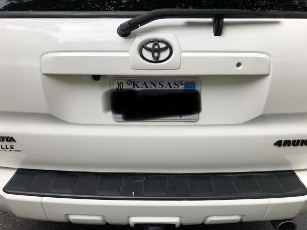

Installed this backup camera yesterday in anticipation of replacing the OEM head unit when I replace the evaporator core. No idea on longevity, but install was straight-forward and it looks OEM.
While waiting on Denso/Sony parts, I wanted to get the pain of routing wires around the back window and into the cabin out of the way and it didn't disappoint. I also proactively ran wiring for LED hatch lights once I get around to it, will captured details when I do.
Some install notes:
  • Since the replacement head unit hasn't shipped yet (bought this just-released Sony unit), I verified camera operation and placement using a 9V battery and spare TV. Worked like a charm.
  • For running the wires from the hatch to the cabin via the rubber grommet, liquid dish soap and water was a game-changer.
  • This seems obvious but check rear-window clearance before you button it all back up.
  • I noticed evidence of water infiltration into the hatch and will be replacing the hatch window weatherstripping to help prevent a larger issue.
I was gonna document the backup camera install process for a how-to but found that it's been covered fairly thoroughly. That said, if anyone is interested, happy to pull one together for this camera.
