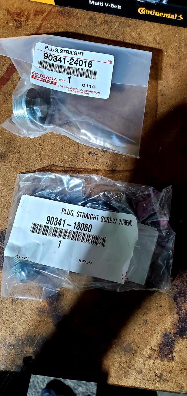

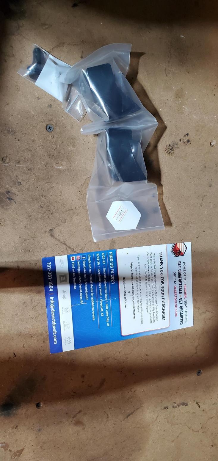

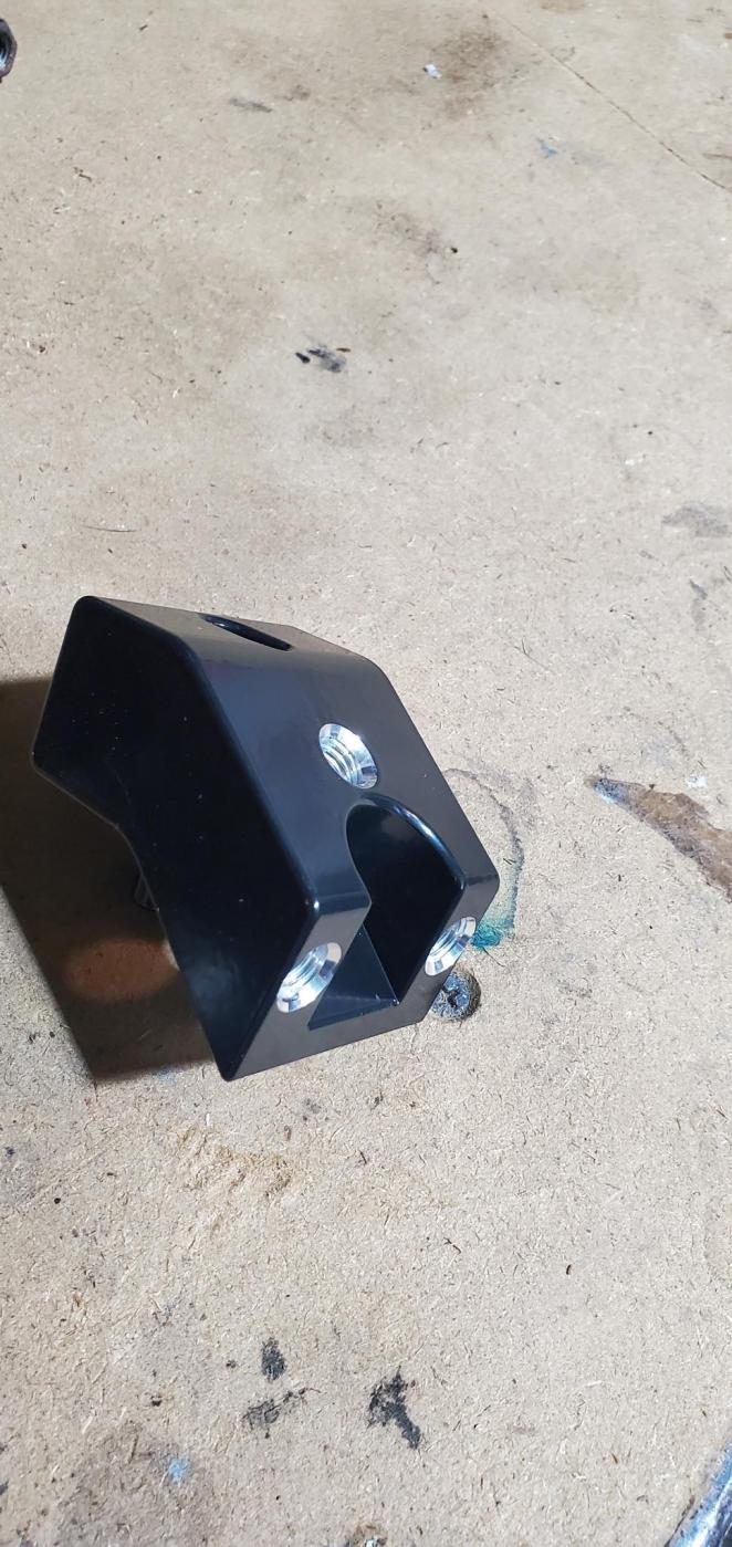

It's been a while since I've done anything to it really. But it's time for some refreshing...Got a few things done and a few big things in the works.
163k
-Changed front diff fluid with Redline HD Shockproof 75w90
-Changed diff Fill and Drain plugs to the Lexus Parts with nuts on them so you don't have to strip the plug and fill every time.
-Installed Desertdoesit Seat Jackers. AMAZING difference. Highly recommended if you do long trips.

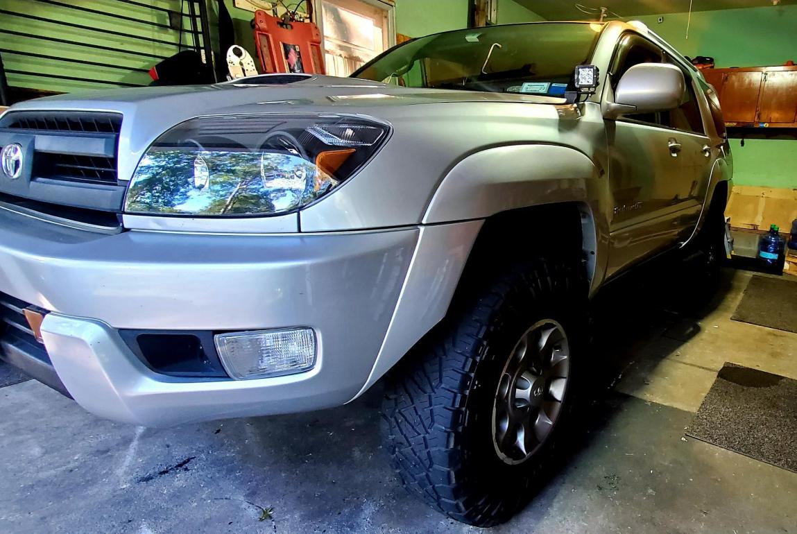

Finally upgraded from Michelin xlt a/s in 265/65/17 to Yokohama Geolandar A/Ts in 255/75/17. So far I love them. Even driving on dry pavement is a huge difference, I can feel the grip (and the Michelins are still at 10/32 tread so it's not just new vs old tire comparison) and somehow even my mild driveshaft play seems to be gone... No idea how that could be physically possible. May post a thread about it to try and figure it out because it's really confusing me.
