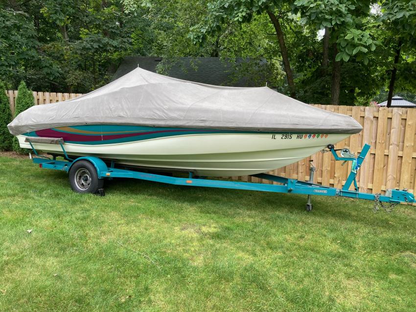

Getting my sport ready to tow a new used 21’ ski boat home tomorrow.
:party:
Got the boat home and noticed watery grease coming from the trailer bearings. Found the bearings are shot, rough as can be. Got parts ordered and hopefully can get it rolling before the weekend.

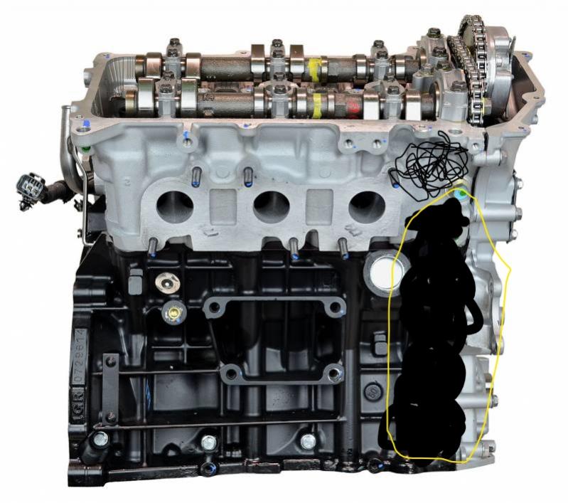

Head gasket on an '05 V6
Finished replacing the HG last week but immediately had misfires in 1,3,5.
Got it back from the shop (they checked compression and coils and said those were good and it was too much work to go further into it) and today I tore her back down and found I was advanced a link on the timing chain despite a dozen checks last time.
Fixed that and am rebuilding her but found a huge amount of new oil leaking from what I think is the oil control valve filter on Bay 1. There's some older looking oil above that, but the bulk of the really gooey stuff starts at the bolt (the one with blue paint on it in the photo). Not sure if that's caused by over-pressure from misfiring or bad seals or what. Any thoughts?

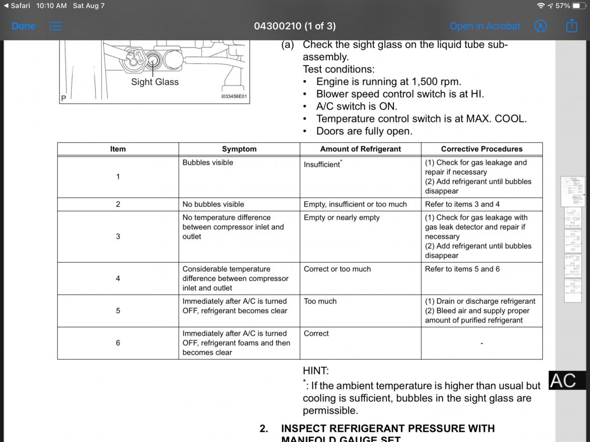

Today I recharged my AC for the second time in 3 years -- I did it the day I bought it. I noticed the AC was a little weaker last summer and it didn't seem any worse this summer, but it definitely wasn't ice cold. I put about half a can of refrigerant in and it's ice cold again.
I'm wondering if it has a small leak somewhere or if recharging after 3 years is pretty normal? It's a 2008 and only has 79k~ miles
Replace the schrader valves and add dye/oil to the system. Makes it easier to find leaks in the future. Mine was leaking from the condenser lower line.
use the sight glass when you recharge. Stop once the sight glass has no bubbles (engine at 1500 rpm). Using weight gets you close, but the sight glass gets you there.
