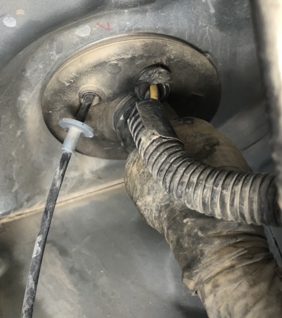

Those of you that have run wires thru the firewall for switches or subs- whats the easiest way to get wires into the engine bay? Is there a factory location that is easy to add wires to? I'm hoping to get my subs out of my old truck into the engine bay. I might drill a hole and use a cordgrip for strain relief/weatherproofing but if there is an easier way to do it than that, I'd be super game.

How many wires are you talking about? There’s a little nipple on the side of the wiring harness where it passes thru the firewall that I cut a slit in with an x-acto knife and fed a wire thru with a little soap on it. I was able to run three 12 ga. wires thru to my lighting relays. Looking at the driver side firewall below the hood hinge the nipple is at about the 1:00 position on the bulkhead harness.

Ah thanks. For now it will be just two, I’m thinking of a 4awg red and black pair. I’ll take that into the back directly to the amp for now. In the future i’ll be running it into a small positive and negative busbar for an inverter, interior lights, and other accessories. Eventually the subs and other stuff will run off of an isolated battery and not the main battery, but one thing at a time.
