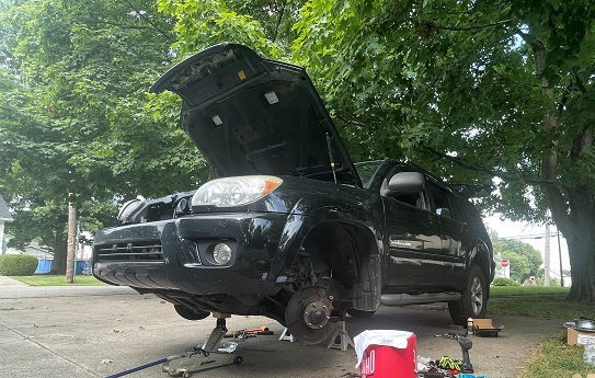

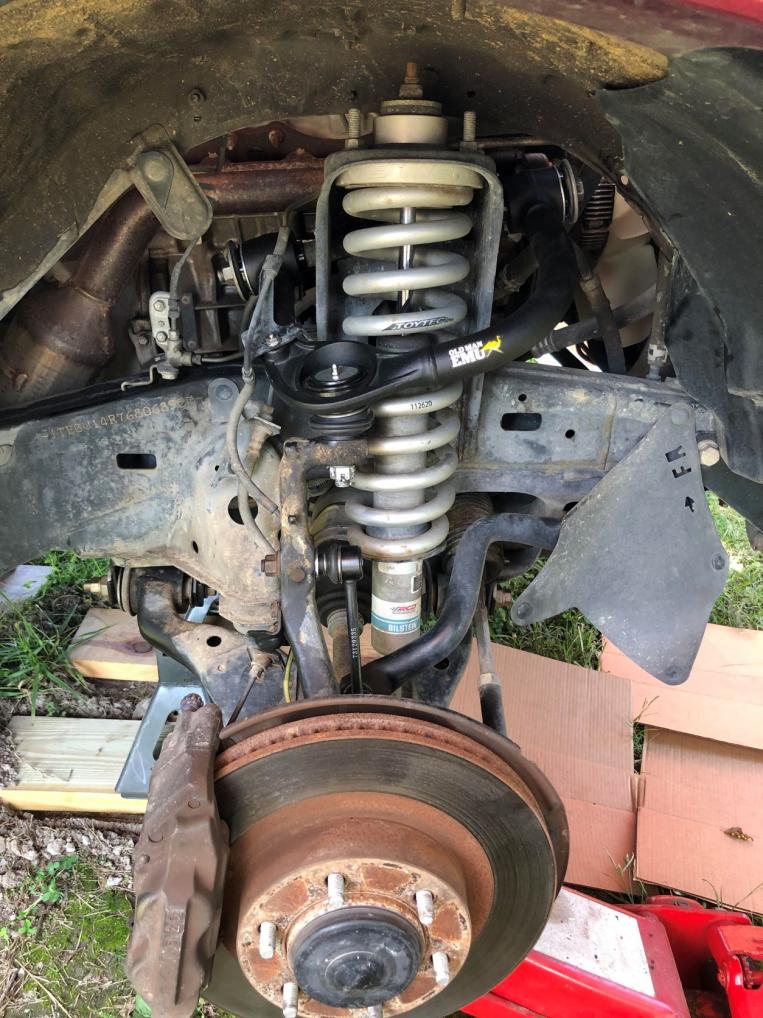

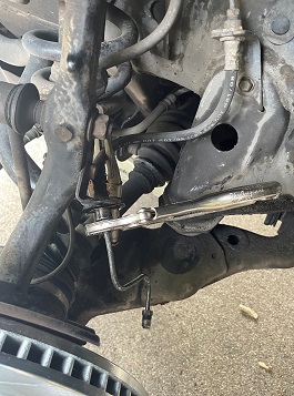

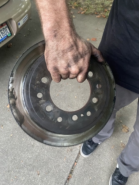

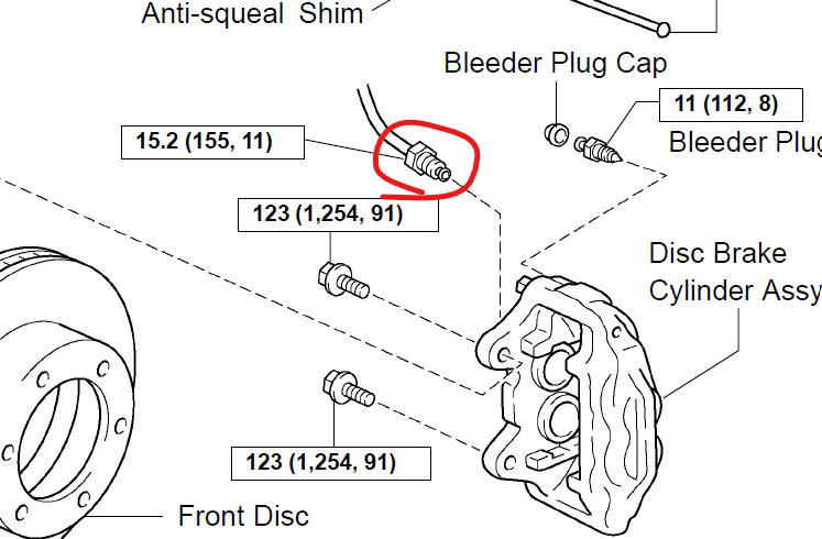

Started replacing pads & rotors on my 08. I've had here about 5 months. My RL was sticking and smoking.
Found my FL caliper locked up. Ordered replacements for FL & FR. Also found hard lines attached to the front calipers! W.T.F. Over?!?
I have flexible steel braded lines ordered, now to just find the PN for the Fitting circled in red.. anyone?! :pout:
I have no manual and haven't had much luck finding it.
I have flexible steel braded lines ordered, now to just find the PN for the Fitting! :pout:
Anyone happen to know that? I have no manual and haven't had much luck finding it.
To buy that short steel brake line from the flex hose to the caliper from Toyota and OEM it's going to cost a minimum of $30 to $35 for just one front caliper!!
I had my driver's side break, so no brakes at all and I drove 90 miles home on a Thanksgiving night because nothing was open and couldn't afford to tow it that far, I used my parking brake and downshifting to stop with no issues, no real traffic to speak of so I was lucky.
That being unnecessarily said, I went to the auto part store and bought a straight piece with the correct size "Japanese" fittings and the correct length and very carefully not to kink it bent it to shape, it cost me $2 to $3 for the brake line and with a quart bottle of brake fluid lees than $10 overall!!
Take the entire steel line with you to make sure you get one with the correct fittings and length and take your time bending it, you could even get a couple extras in case you do kink one or two trying and still come out WAY ahead over the OEM replacements!!

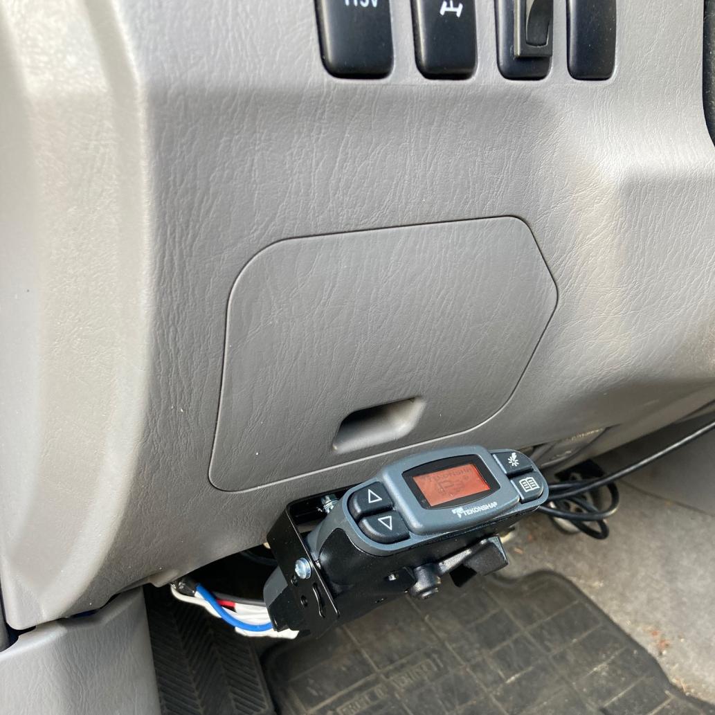

TBC installed
I'm getting ready to go supertrucking with my T4R. I've got some home improvements coming up and big boss at work is letting me borrow his flatbed to make things easier. Because the flatbed has brakes on both axles, I ordered a trailer brake controller and got it installed. Pretty neat, super easy install. Turns out some (if not all?) of the 4th gens had a plug for brake control preinstalled under the dash. Mine was on the back of one of the harnesses behind the drivers side kick panel. Install could not have been easier. Only thing left is I need to get a metric nut from work tomorrow and put the ground ring terminal on one of the studs up under the dash. As it turns out, the only nuts I have are American :cool:

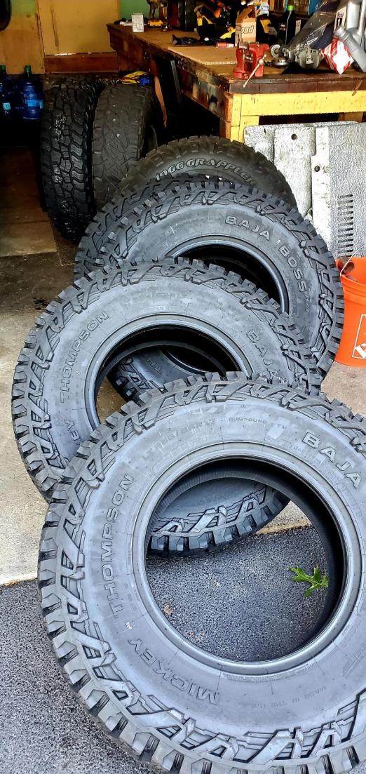

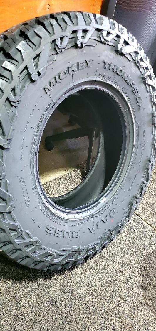

A little preview
255/85/17 Mickey Thompson Baja Boss's ....

A little preview
I thought that 85 was a typo until I zoomed in on the pictures. These have my interest for my third gen, a skinny 34" tire.
Any idea what they weigh and how they're generally reviewed? I didn't even know that size existed until now.
A little preview
After he posted the photo I searched to find the weight because they look a bit heavy, what I found was 65+ lbs, so if true definitely going to be a hit on the MPGs.
They are basically a Brand new tire by Mickey Thompson with 3 ply sidewalls, 3 peak snowflake rating, and made in the USA. There aren't extensive reviews yet but any feedback I've seen has been overwhelmingly positive.
The scaled weight is 64 lbs.. and for comparison
, the scaled weight of my current 285/75/17 ridge grappler is 67 lbs
Mickey Thompson | Baja Boss A/T
They look good, and a 50k mile treadwear warranty is good for LT off-road tires. 64 lbs isn't terrible. My ST Maxx in 255/80/17 are 58 or 62. I can never remember, either way only a few pounds less. I don't need 34s, but I would love to have them. MPG on the 3rd gen went out the window a long time ago :)

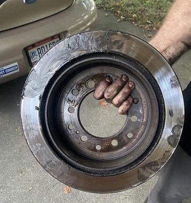

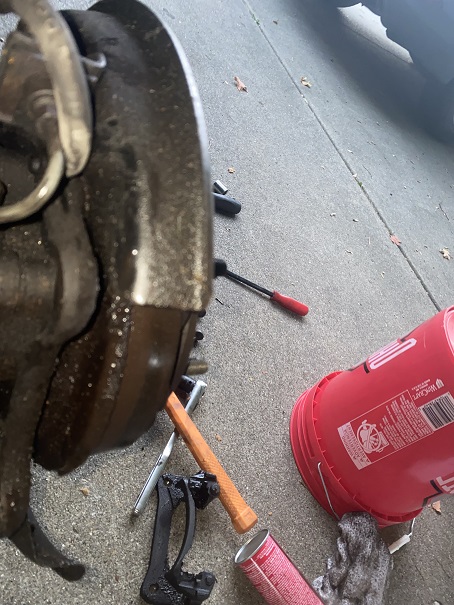

My Grandfather had a similar experience to yours years ago!
I'll have my braided hose shortly, just waiting for delivery.

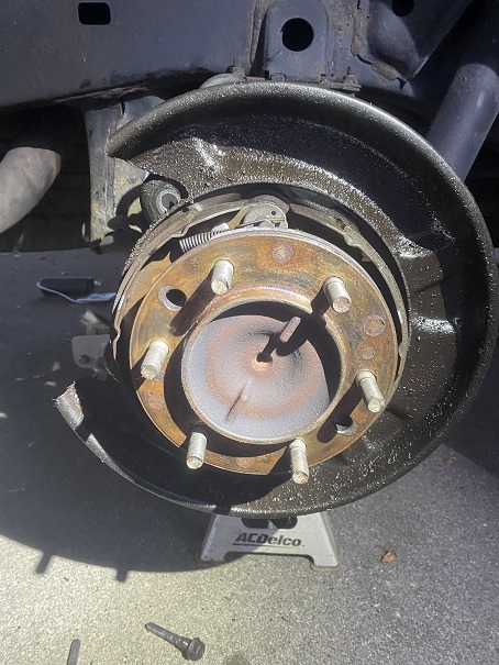

Last night I replaced the LR rotor & pads without issue.
The RR however, I found completely covered in diff fluid. So now it's seal replacement time.
Hopefully the bearing is good but we'll see!

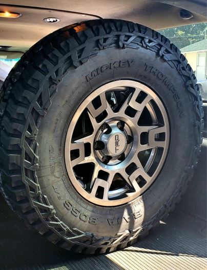

Got em mounted today.. few more things to finish on the truck before its wearing these shoes

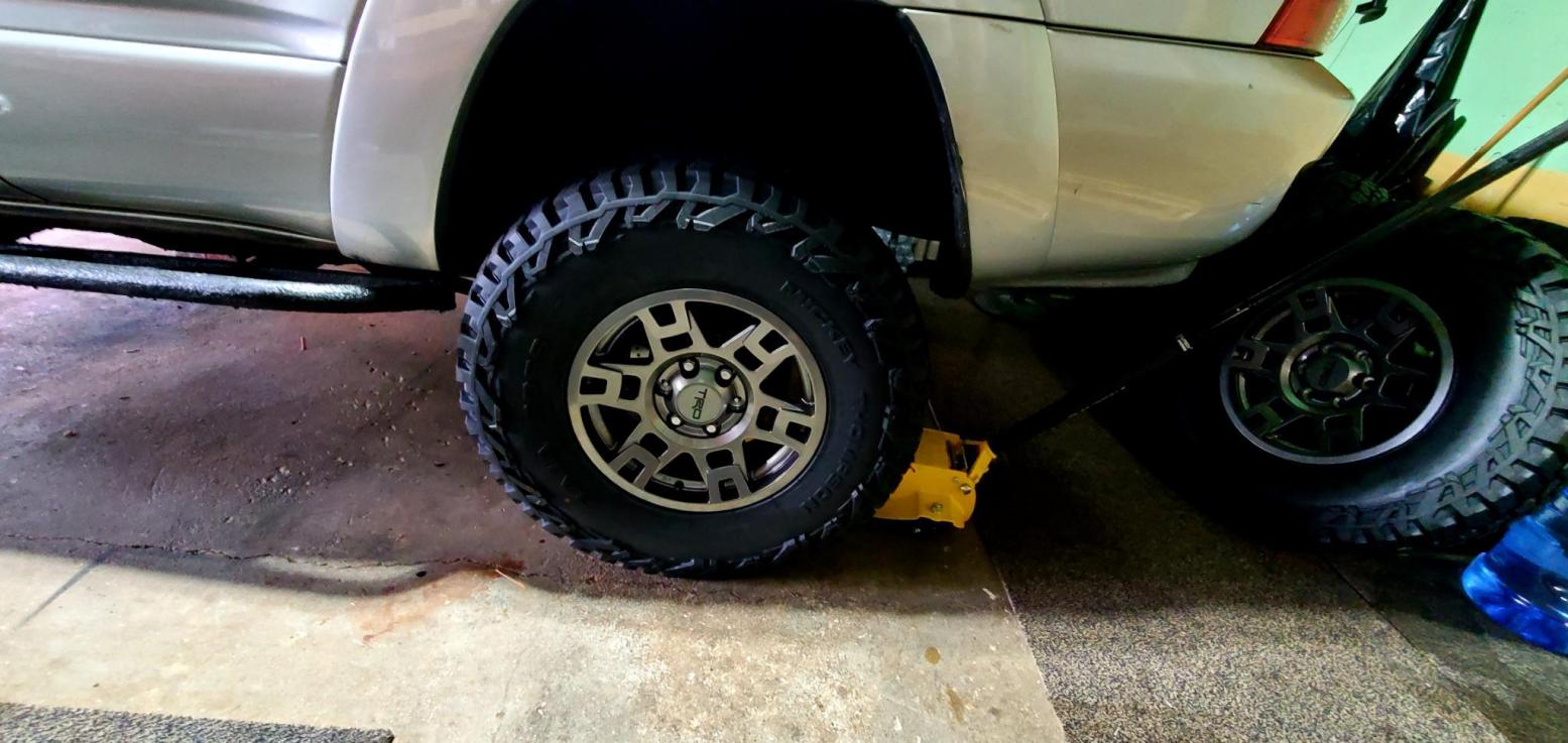

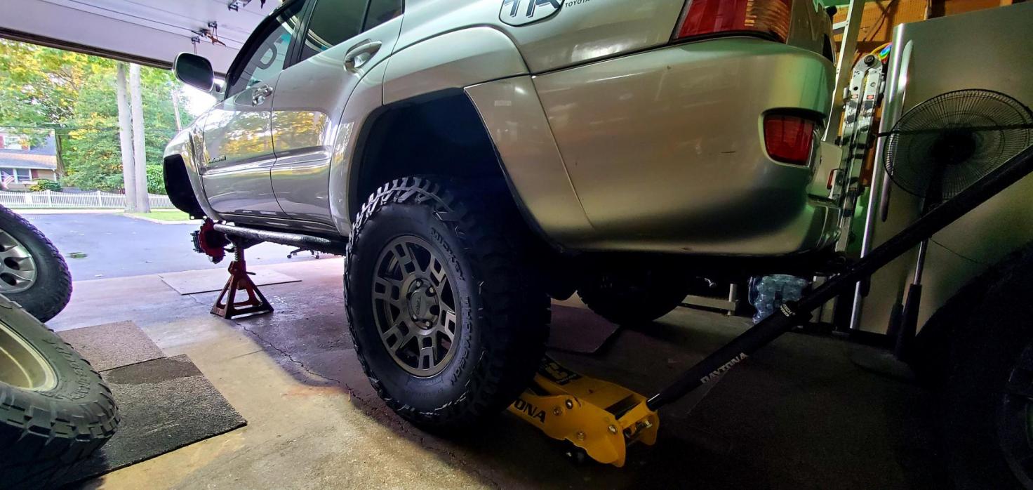

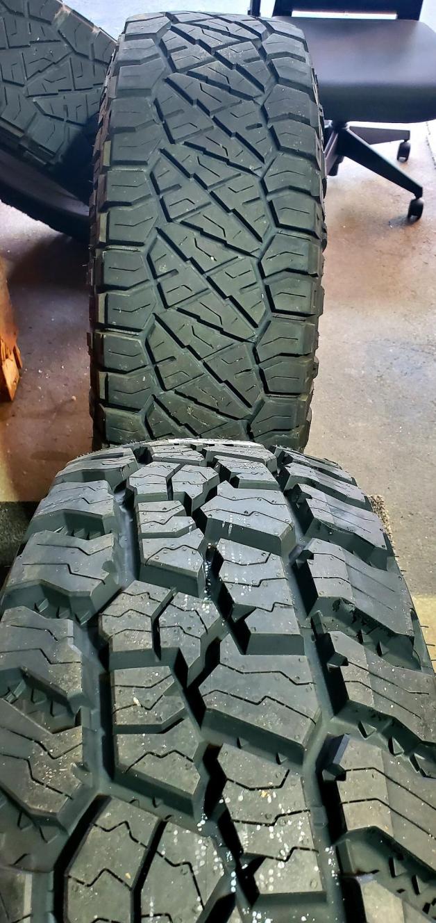

Some Test Fitting and comparisons- 255/85/17 Baja Boss AT vs 285/75/17 Ridge Grapplers
I cycled the rear up and down with the jack and looks like clearance is no problem, I Have bump stop extensions on there now, and im adding Durobump extended bump stop onto the extensions this weekend so no fenders will be popping off in the rear at least lol.
