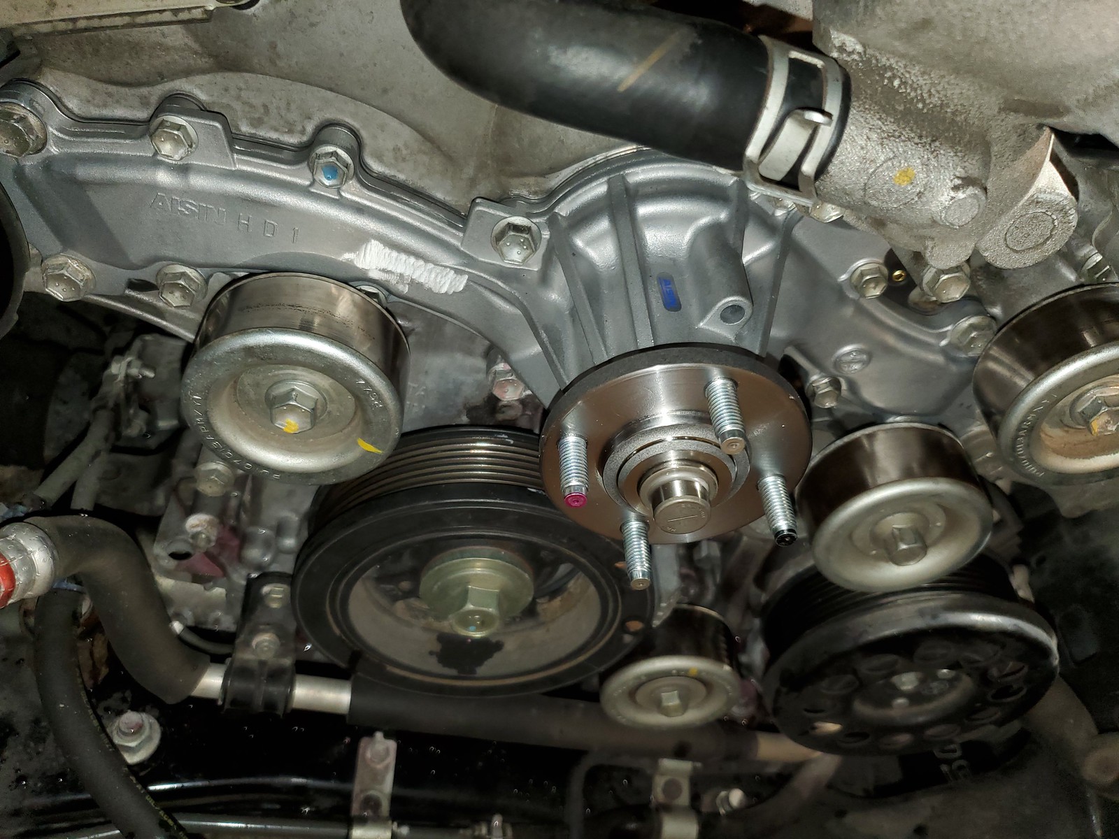

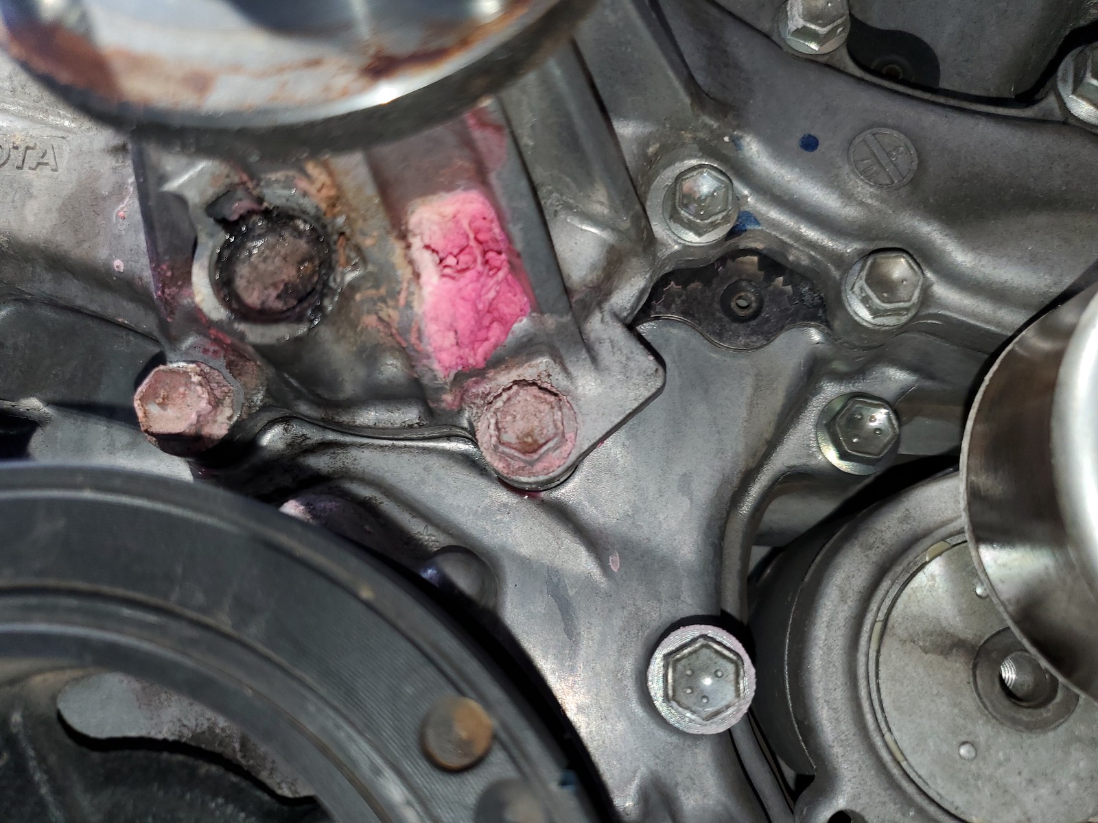

Here's the water pump that was leaking on my 08 V6 too. Supposedly the Toyota dealer replaced this 5 years and only 15k miles ago for the previous owner per the Toyota records when I bought the vehicle.
It didn't look like anything had been touched in there based on the dirt/coloring on the timing cover behind the water pump. The bolts also had some goop on them and they seemed to be in 'strategic' locations, as if they were installed by the factory that way. So unless the tech who did it put all the bolts back where they go it seems like it was never actually done despite what the records show.
That does make me feel better that the pump actually lasted probably 83k miles instead of only 15k miles. Hopefully this one lasts a long time. Went with an Aisin pump, Toyota Thermostat and belt.

New Aisin Pump, with the Toyota name ground off.

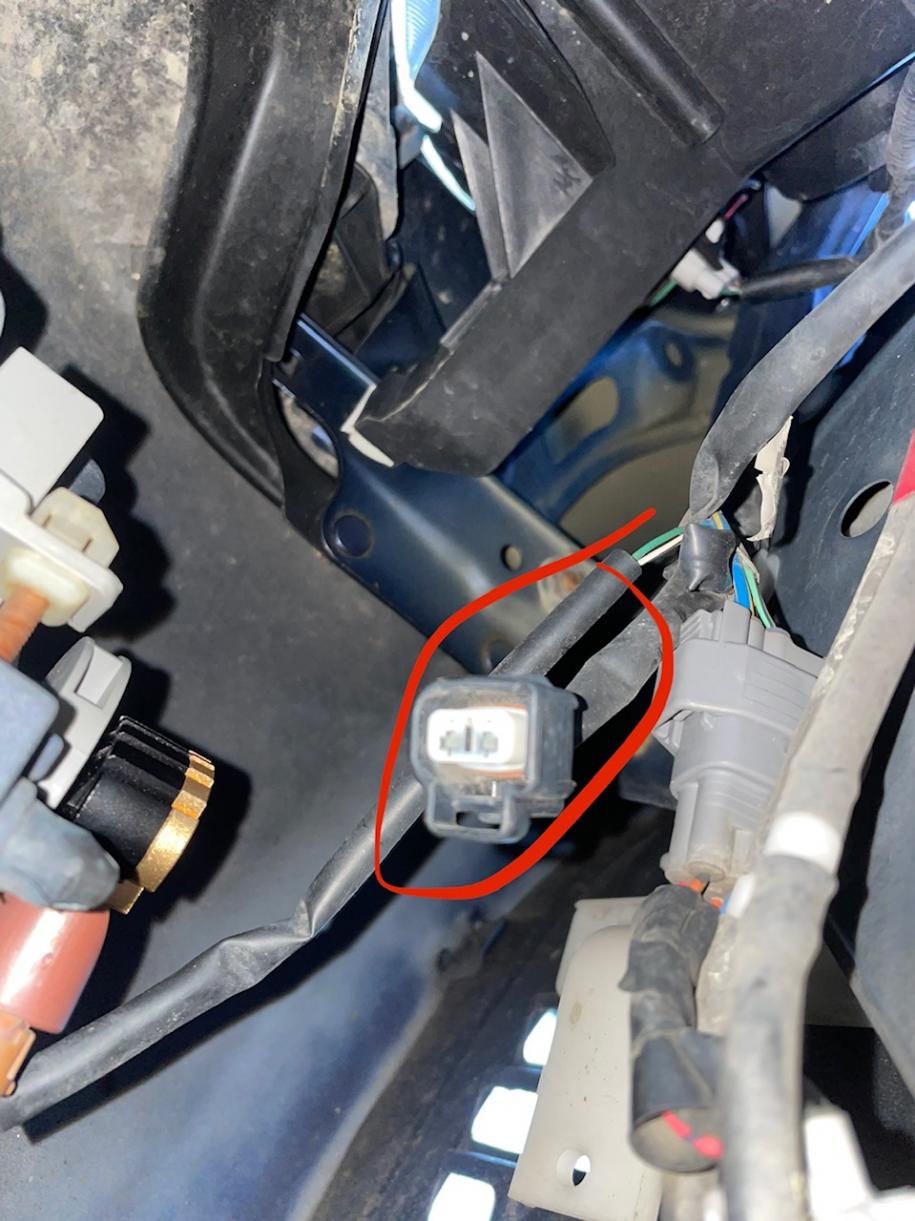

New 4Runner owner as of a month ago! I was changing out my foglight bulbs when I noticed this harness hanging near the passenger side fog light. Does anyone know what this is for? I apologize my flash blew out the exposure a bit.
Thank you!
