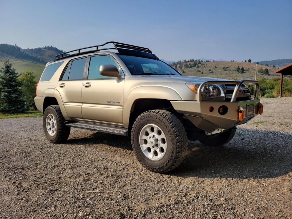

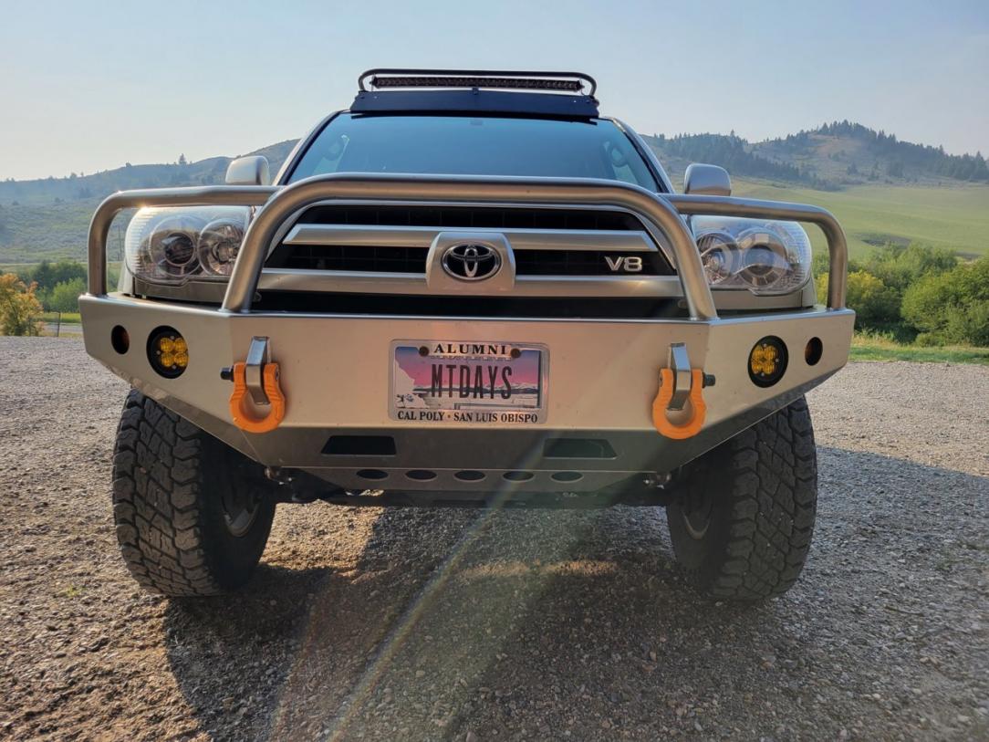

I installed some BD Squadrons and threw a couple "uber" shackles on...the color choice is more function over fashion mind you...

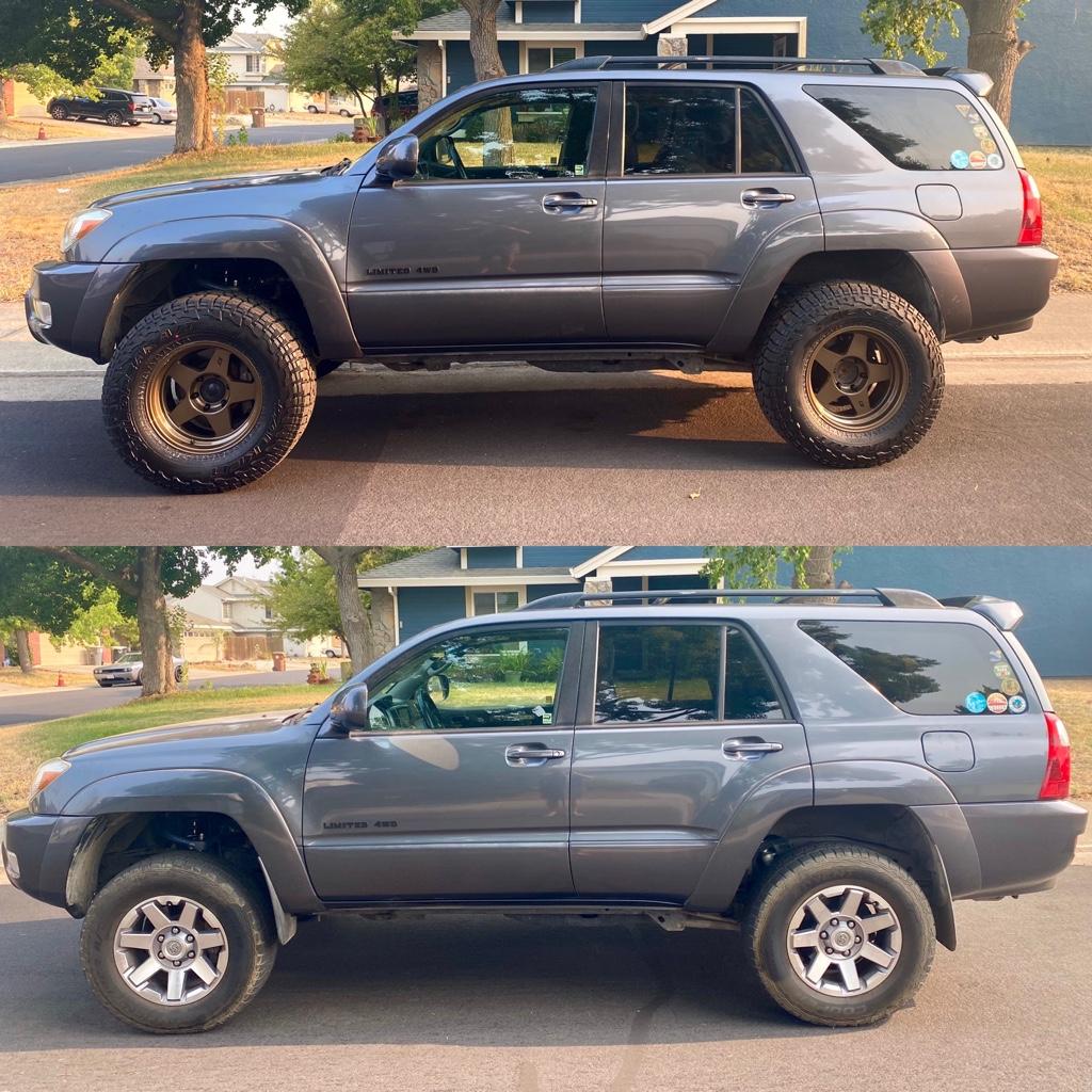

I’ve got the same setup, though my truck didn’t have XREAS. I think I achieved 3/2 but hard to tell since the old suspension was so sagged. Anyway, here’s a visual of how 285/70/17s looks versus stock 265/65/17.
Those tires look quite big in the picture but looks good. Are you getting any rubbing? At what height/settings are you running the front shocks? What rear springs?
Running the 6112s with 650lb spring on setting 3. I had it on 5 and it was too tall. Rears are 5160s with an Icon 2” spring.
Caster is 3.6 on both sides. Fender liner is pushed way forward and there’s no rubbing in the front. I didn’t not think the bumper at all. I removed the mud flaps and trimmed the inner fender where the mud flap was. It will rub the body mount on full lock but that’s being addressed soon.

I’m running the 650lb on the front and 2” superflex coils on the back. When I first installed the fronts I was running the driver at 5 and passenger 3. I didn’t like the feel or how it was so I got a 1/4” spacer and put both at setting 3. I haven’t done an alignment since I’m waiting for my UCA. Hopefully by the end of the month I’ll have it all dialed in with some new tires.
For the V8s the instructions on Bilstein.com show using the same clip height. I also have a 1/4” spacer on the driver end it’s almost level (depending on how much gas I have). In hindsight a 3/8” spacer would have been perfect.
When you get it aligned see if they can get the caster closer to 4. I’d rather trim the bumper than need a BMC. Mines fine on road for now but with -10 offset and 285s it’s going to need to get done.

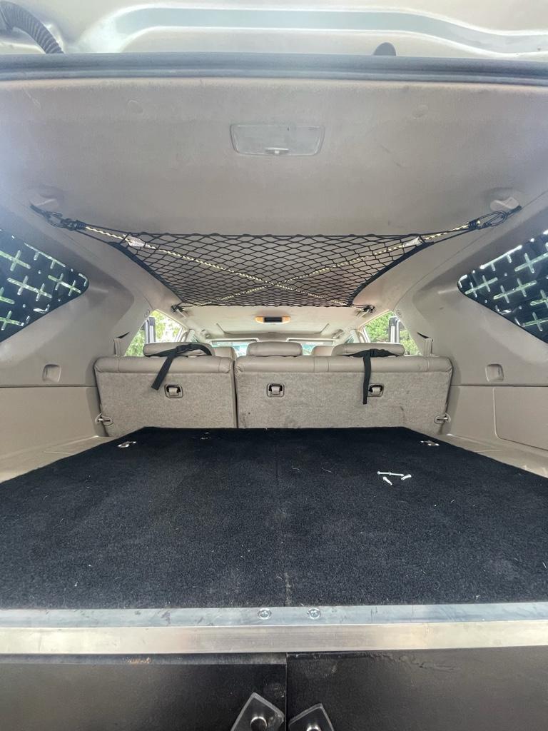

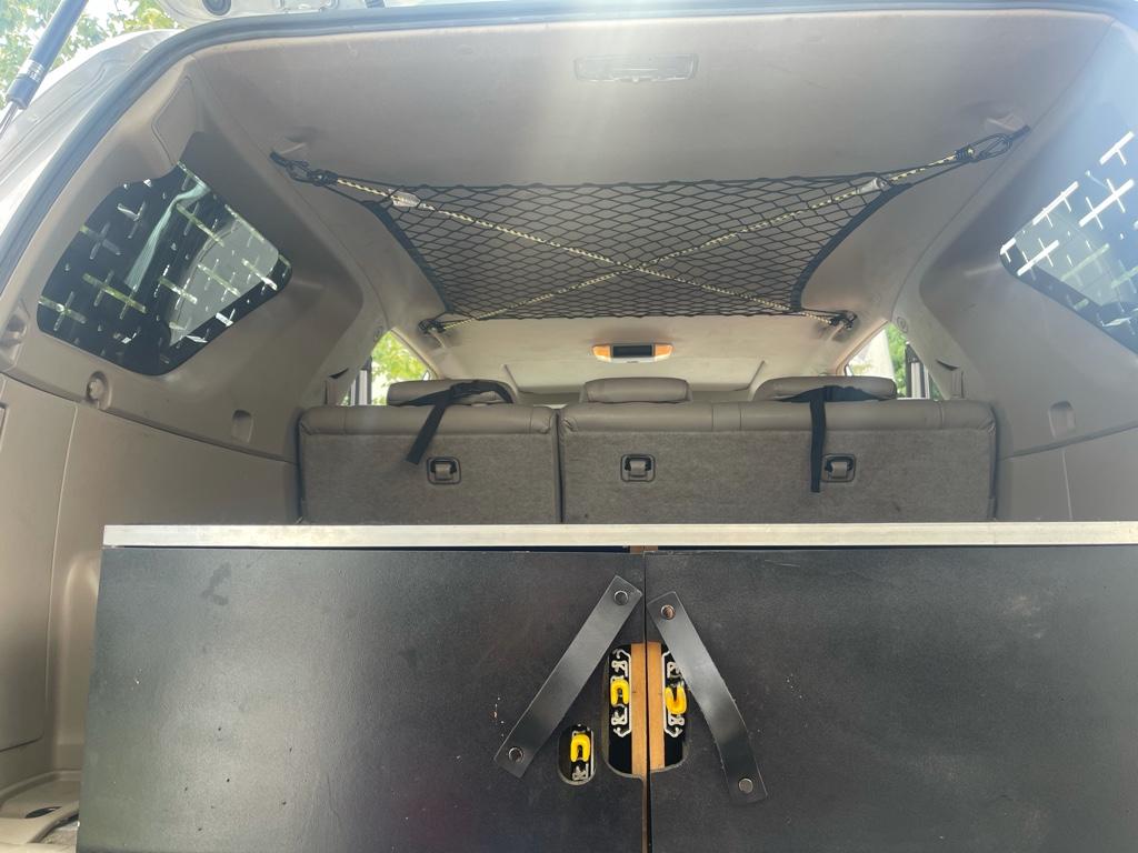

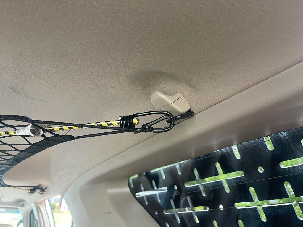

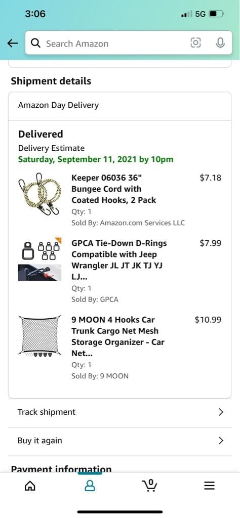

For the overlanding guys and gals, cargo net attic storage is ridiculously cheap, easy and fast to implement.. $28 from Amazon and 15 mins of work.
