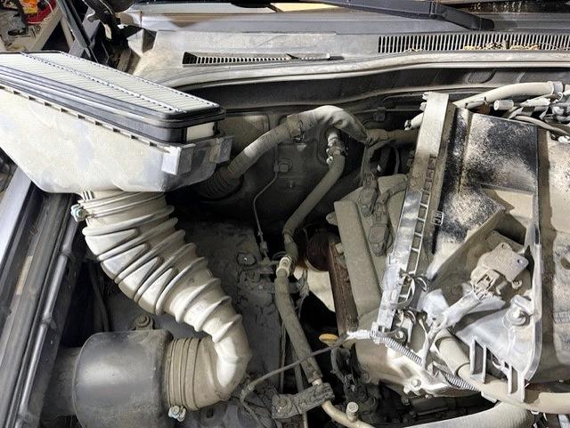

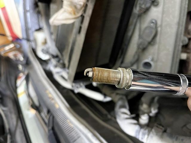

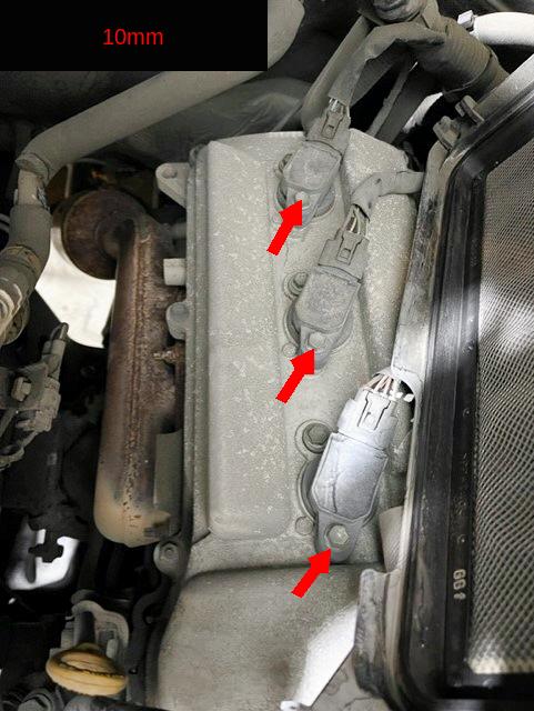

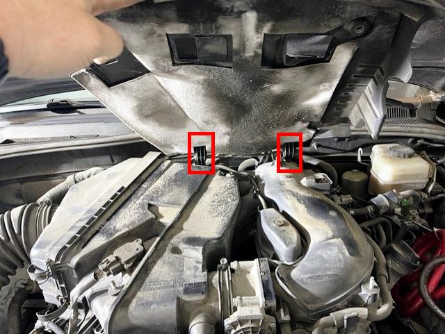

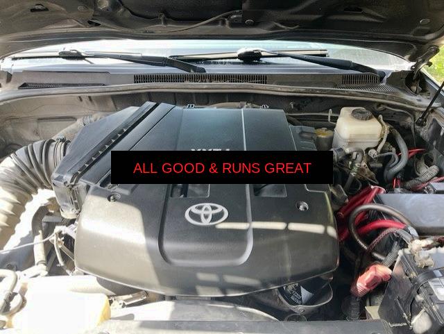

Addressing the check engine light/rough idle/misfire cyl 6
[THREAD] Addressing the check engine light/rough idle/misfire cyl 6
2/2
REPLACED SPARK PLUGS: Amazon.com
REPLACED COILS: Amazon.com
REPLACED PCV VALVE: Amazon.com
