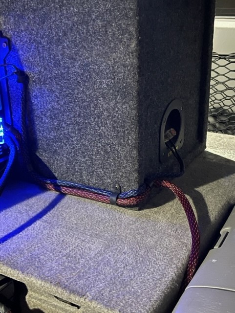

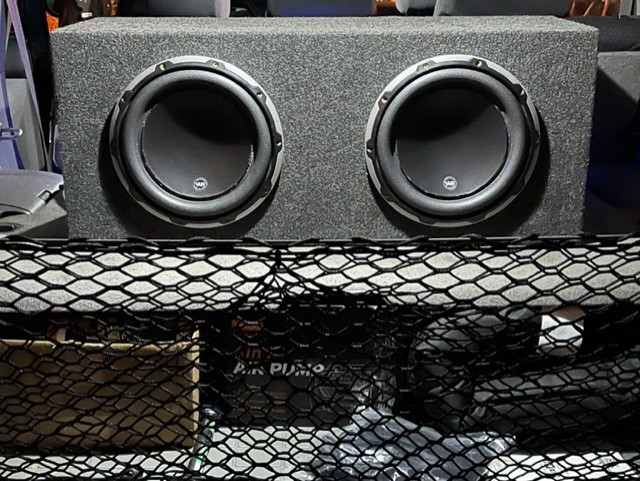

I pulled out my MTX Terminator dual 12" Sub box w/ 250w amp and made some changes.
I inherited a sub box with dual JL 10w6v3-D4 subs that needed refoamed.
--> Amazon.com

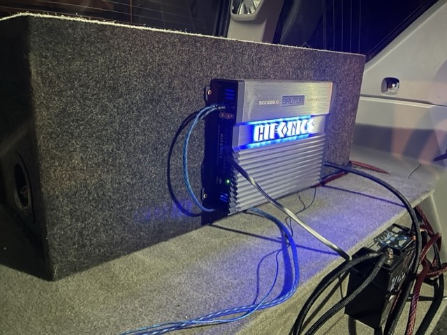

After refoaming these kickass subs and letting them cure for 48hrs I rewired the sealed sub box with new 10 gauge speaker wire, jumpered the dual voice coils and ran them in parallel @ 4 ohms per x 1 ohm to a Hifonics BXX1200.1D Brutus Class D 1200W RMS 1 Ohm Mono Car Subwoofer Amplifier.
--> Amazon.com
YES, this amplifier is bullet proof and a true 1 ohm.

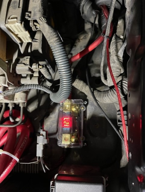

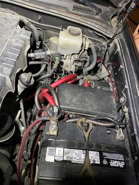

I upgraded to The Big 3
--> Amazon.com and installed a 0/2/4 Gauge Car Audio Digital Led Display Fuse Holder ANL 100Amp Include Fuse Distribution Block.
--> Amazon.com
I threw in a Kinetik HC600 glass mat agm supplemental battery to act as a capacitor for extra power.
--> Amazon.com
Tonight I am installing a Stinger SGP38 80-AMP Battery Isolator and Relay with 12v cutoff to keep the Kinetik from leeching power from the start battery.
--> https://www.amazon.com/Stinger-SGP38-80-AMP-Battery-Isolator/dp/B001HC6UJ0/ref=sr_1_3
I am also adding an additional fuse distribution block between the Kinetik battery and the 1200w amp. Upgrading both fuse blocks to 175 amp ANL fuses.
https://www.amazon.com/gp/product/B081VTGSRY/ref=ppx_yo_dt_b_asin_title_o00_s00
Why the additional battery? I just replaced my alternator recently and I'm reluctant to dole out the required $429.00 for a Mechman 240 Amp Alternator.
--> https://www.mechman.com/alternators...0-amp-alternator-for-4-0l-toyota-lexus-truck/
I will eventually go that direction. Some of this may seem like "overkill", but if you've ever had your car catch fire you'd take every precaution to avoid it.
Now I have a sound system that is simply insane!!
I'm also replacing my stock hood supports with StrongArm 6228PR Hood Lift struts.
--> https://www.amazon.com/dp/B074G8VHCB
Pretty sure they are the same as Monroe.
Maybe this might help anyone doing a similar upgrade. Cheers!
