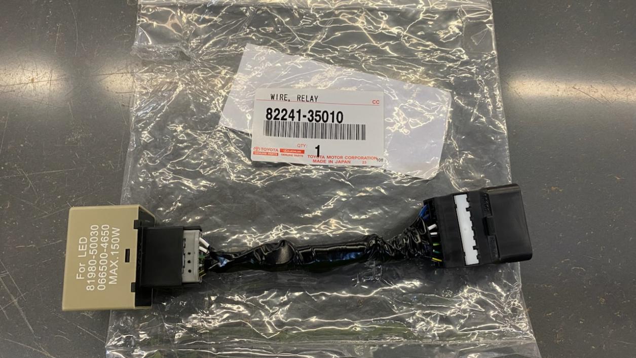

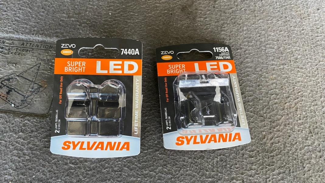

Got the LED Flasher relay from Diode Dynamics, adapter harness from Toyota and new LED bulbs in. Previously I had LEDs in the rear with a built in resistor from LasFit. I really liked them, they were super bright but only lasted 2 1/2 years and at $50 a pair, I couldn’t justify the price tag of replacing them.
For this change, I was not interested in wiring in resistors but definitely wanted LEDs everywhere and eliminate the hyperflash. Unfortunately this does make you lose the DRLs which is unfortunate, I will miss those as I like the benefit of being seen better when the headlights are off, kind of the point of switching to LEDs. It really makes me cringe at the thought of cutting the factory harness. So after some searching through the forums, I decided on changing the flasher relay, which accomplishes what I intended which was being able to run any LEDs I wanted to without a huge price tag. I ended up with Sylvania LEDs for both front and rear for their “Lifetime” warranty and what I see as a reasonable price. I am pleased with the rears, but the fronts are not impressive. Two reasons for that, the housing of my after market headlights is full black and does not capture and reflect the light out like a chrome or polished housing would. Secondly, the bulb is not clocked correctly in the housing, so even if it was a chrome housing, it would not be using the light output to its fullest. To remedy this, I’ll be looking for new bulbs in the front that have more of a 360° design and maybe a forward facing lens.

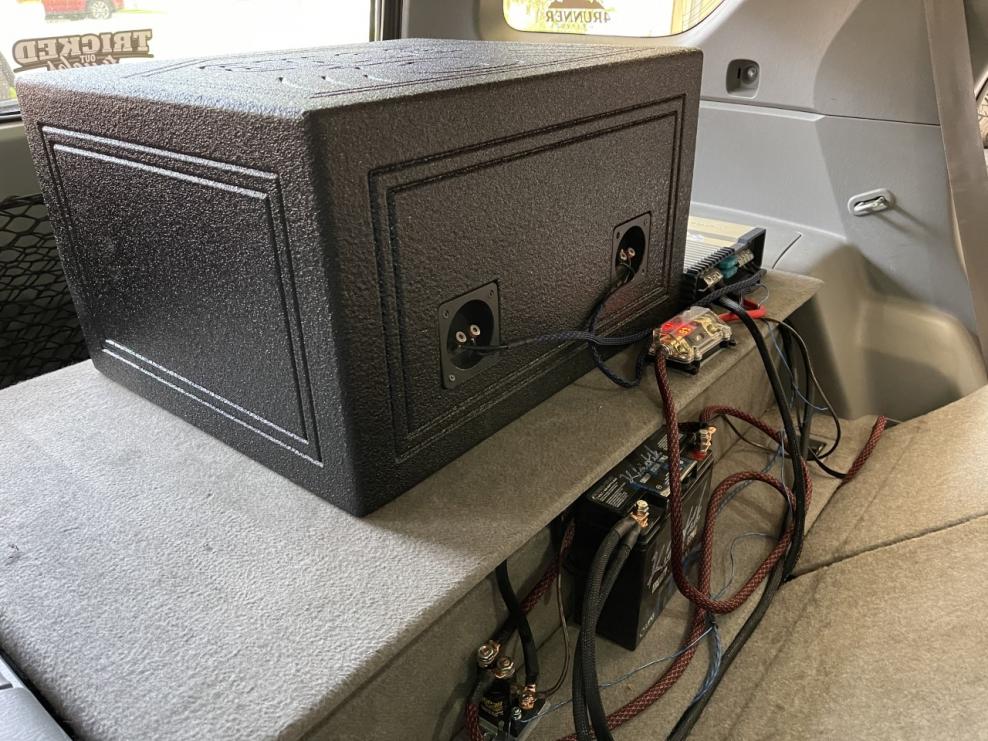

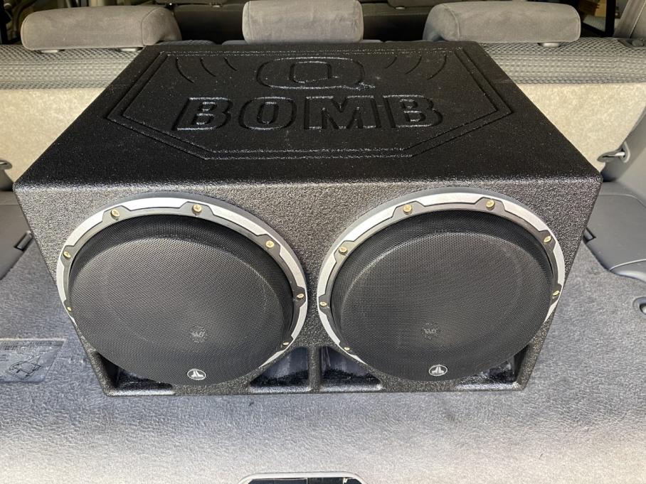

I pulled out my MTX Terminator dual 12" Sub box w/ 250w amp and made some changes.
I inherited a sub box with dual JL 10w6v3-D4 subs that needed refoamed.
--> Amazon.com

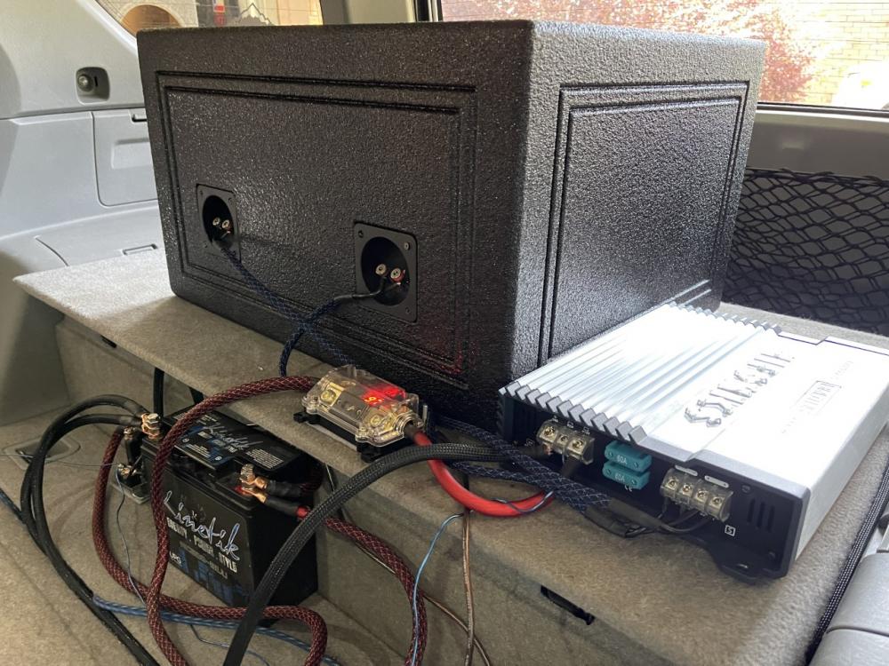

After refoaming these kickass subs and letting them cure for 48hrs I rewired the sealed sub box with new 10 gauge speaker wire, jumpered the dual voice coils and ran them in series @ 4 ohms per x 1 ohm to a Hifonics BXX1200.1D Brutus Class D 1200W RMS 1 Ohm Mono Car Subwoofer Amplifier.
--> Amazon.com
YES, this amplifier is bullet proof and a true 1 ohm.
I upgraded to The Big 3
--> Amazon.com and installed a 0/2/4 Gauge Car Audio Digital Led Display Fuse Holder ANL 100Amp Include Fuse Distribution Block.
--> Amazon.com
I threw in a Kinetik HC600 glass mat agm supplemental battery to act as a capacitor for extra power.
--> Amazon.com
Tonight I am installing a Stinger SGP38 80-AMP Battery Isolator and Relay with 12v cutoff to keep the Kinetik from leeching power from the start battery.
--> https://www.amazon.com/Stinger-SGP38-80-AMP-Battery-Isolator/dp/B001HC6UJ0/ref=sr_1_3
I am also adding an additional fuse distribution block between the Kinetik battery and the 1200w amp. Upgrading both fuse blocks to 175 amp ANL fuses.
https://www.amazon.com/gp/product/B081VTGSRY/ref=ppx_yo_dt_b_asin_title_o00_s00

So far, so good! It's working great.
As you can tell by the pictures, I couldn't leave well enough alone and upgraded to a ported sub box which gave me an additional 3db at the same power as the bigger sealed enclosure from before. I am noticing though that once isolated w/ the ignition off the secondary battery HC600 drops down to about 9.7~10 volts. This tells me that my Kinetik is fading and needs replaced although I have seen that this voltage is still ok. I am going to replace it as these batteries are inexpensive and are relatively reliable for audio applications.
