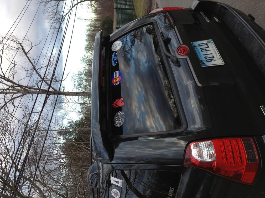

Next, on the advice of Mark, I tried out the 11w reverse lights. These things are amazingly bright. My crappy camera phone can't really do these things justice. Also, they have some decent width/throw as well. It is worth mentioning that they are a really tight fit, as in rubs on the way in, but still easy/worth it to install.

Next, on the advice of Mark, I tried out the 11w reverse lights. These things are amazingly bright. My crappy camera phone can't really do these things justice. It is worth mentioning that they are a really tight fit, as in rubs on the way in, but still easy/worth it to install.
