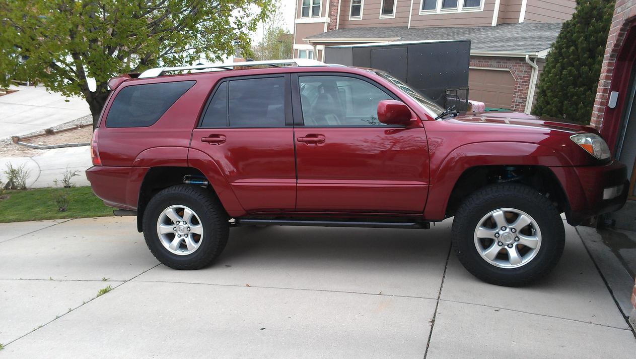

Got a leveling kit and new Toyo Open Country AT 2's
