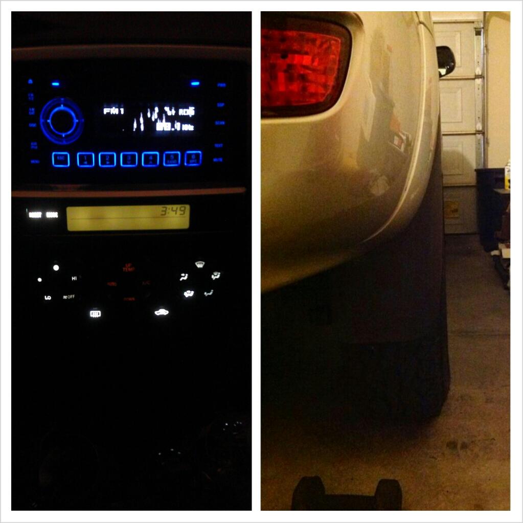

Installed SCION's T1809 HU & removed my spider traxx spacers then sold it to my buddy.

Also found out today that the previous owner backed into something. When we put the BL in the passenger side of the bumper cracked and revealed that it was fixed with Bondo. So if anyone has a white 4runner and would like to send me the right side of their bumper, I'd be interested.
