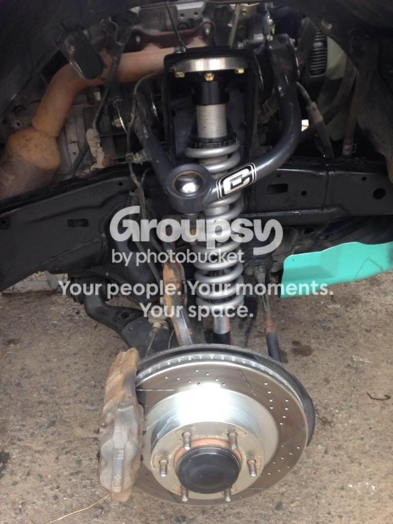

Treated my 4runner to some new things, new cross drilled and slotted rotors, akebono pads, and camburg upper arms. My truck is all happy now.
photo_zpsd42cee2b.jpg~original
what size tire?
Wanted to go 285's but stayed at 265/70/17 due to negative offset of the wheels I didn't want to risk doing a lot of cutting and trimming

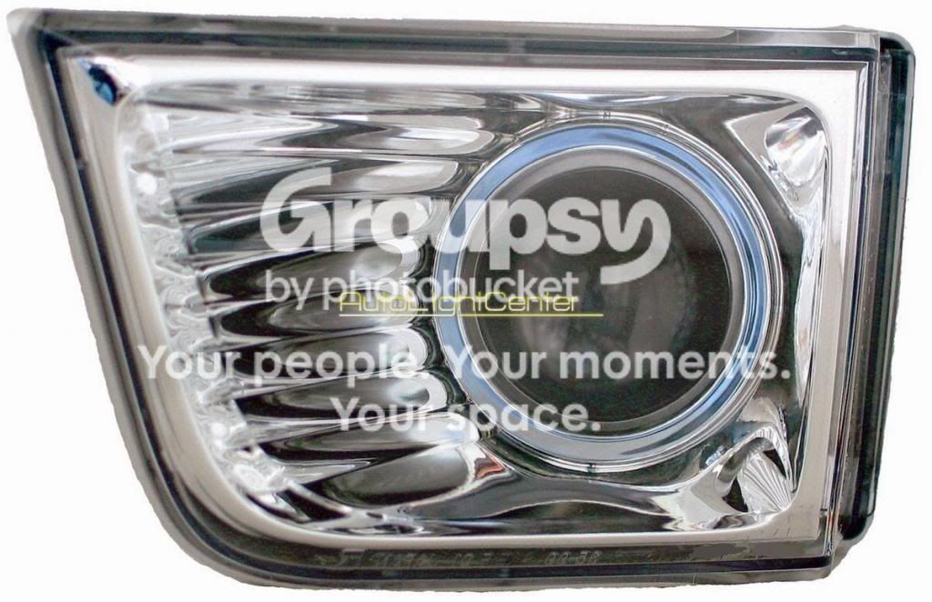

hey guys, so i just finished the blacked out headlight mod this weekend and I'm loving the look so far :happy:
I sat down for a couple hours and stared at my car and was wondering, it looks like i have a projector lens for my fog lights.
am i able to take apart the fog lights and paint the chrome part outside of it, will that affect the reflection of the projectors, I'm new to knowing anything about projectors, any info if I'm able to paint the chrome/reflector part around it
You do and you can. I've had a set of fogs sitting around forever to black out. I'd use a high gloss paint so it shines a bit, but you will still have plenty of output
I did a set for a buddy with matte black and it works fine. The chrome isn't for reflection purposes.
Reflectors are for show. Projector does all the work.
