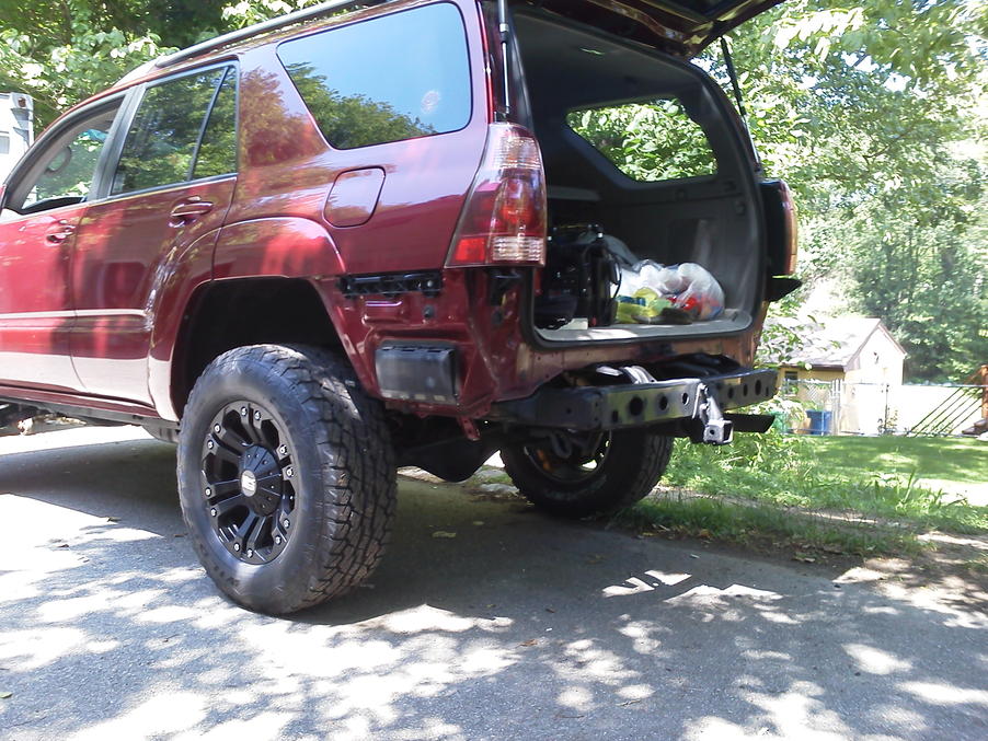

rust prevention
I took off my rear bumper cover and scraped the rusty stuff off , primed and painted. Its one of those spots you never get anything other than salt into. Then I wirebrushed all the welds on the frame, hit them with rust converter and sprated the whole underside with a coat of flat black rustoleum. Ready for the winter.
