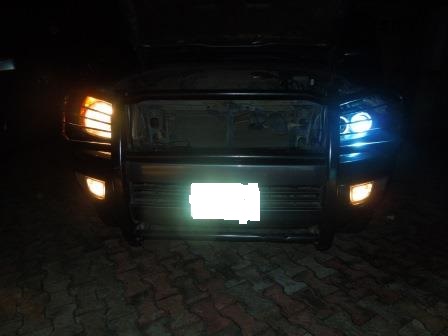

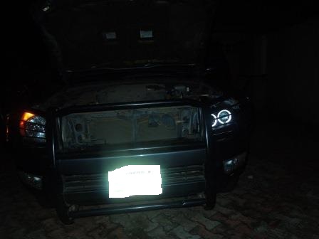

Doing my first CV swap
hid on, strnge..removing the headlights wsnt as difficult s i expected going by comments by forum members........ loosening the sidewall liner makes it waaaay eaasy

I hope you have an impact and a torque wrench for that axle nut. The proper torque on that guy is key to a long bearing life. 176 ft lbs IIRC.
Getting it off kinda sucks too. huge breaker bar is good, impact is better since the hub won't spin as easily.
