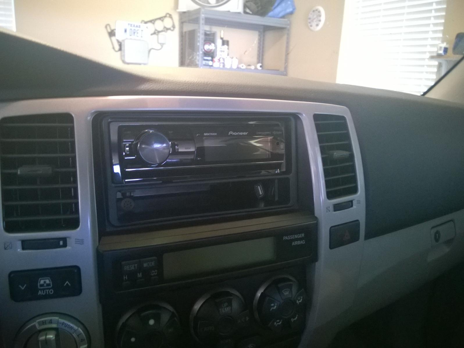

Pioneer DEHX9600BHS Installed:
BT Audio and Phone works great. Nice upgrade from stock head unit even with stock speakers (Non-JBL).

Which bezel kit is that? How do you like the fit with the Pioneer bezel trim?
careful with the mic there, you may get echos from being in that cubby hole.
you should run that mic over to the center speedo and stick it to the top of that. for best perfomance you should speak into the mic, like you are on american idle singing :P

I did used that Metra kit before and didn't really like how it set my radio, so I swapped to a american international kit off crutchfiel, hhere's how it looks when I utilize iso bracket mount on the kit.
