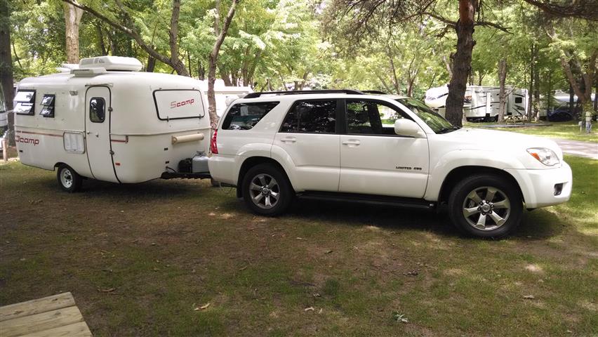

After 3 weeks of ownership...
Sunday:
Hooked up our camper and set up Prodigy P3 controller. Locking up the trailer tires was kinda fun. :mullet:
Today:
  • Installed Weathertech mats & cargo liner
  • Installed license plate
  • Took our 1.25-year old boy to Ace Hardware to get license plate bolts & washers. Took him to a park with dirt roads so we could exercise 4LO and CDL. :happy:
Tomorrow:
Go camping with the family.
