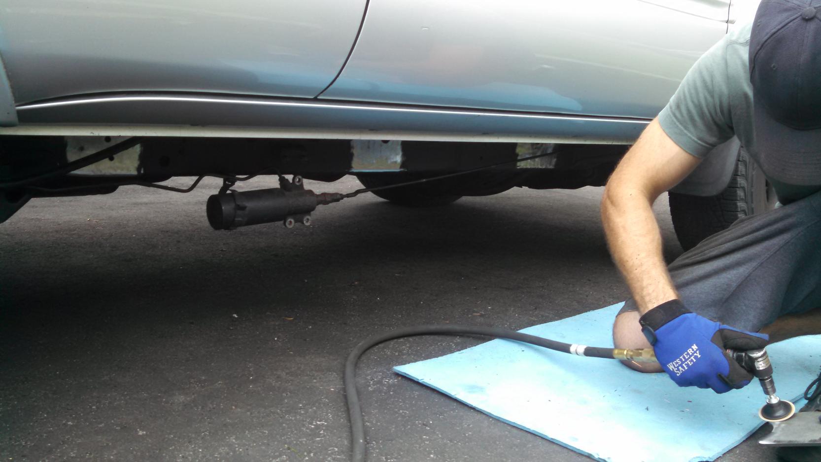

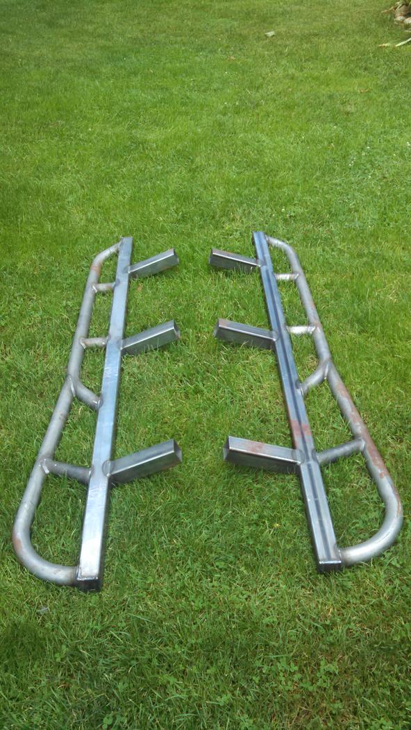

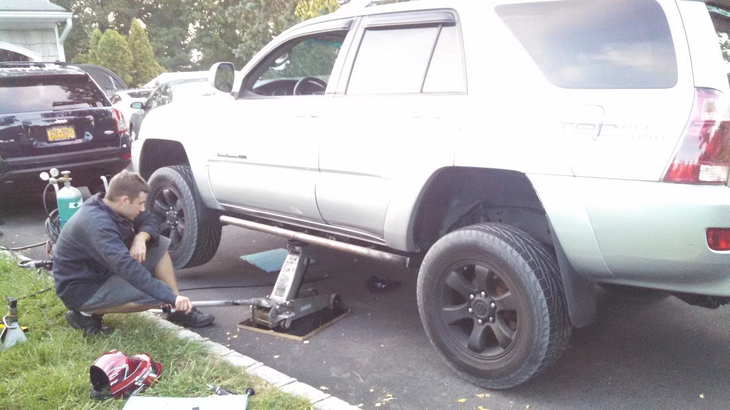

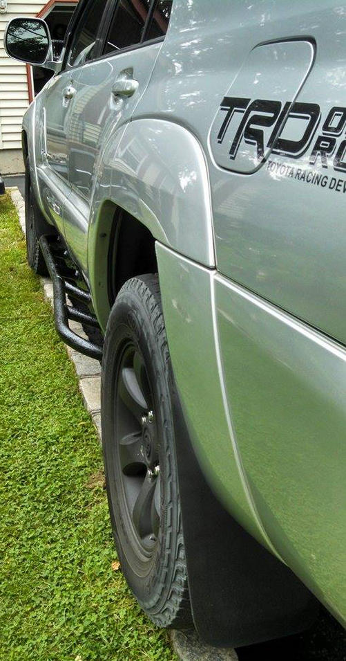

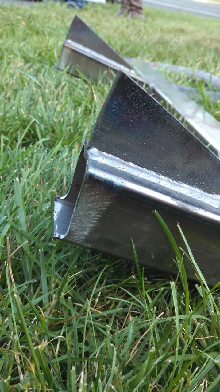

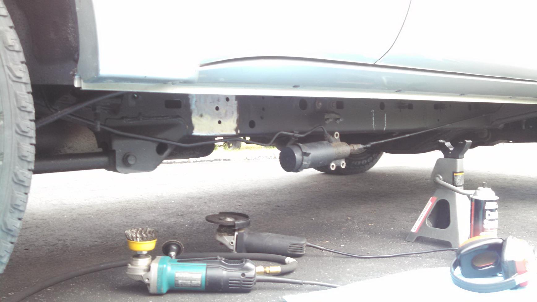

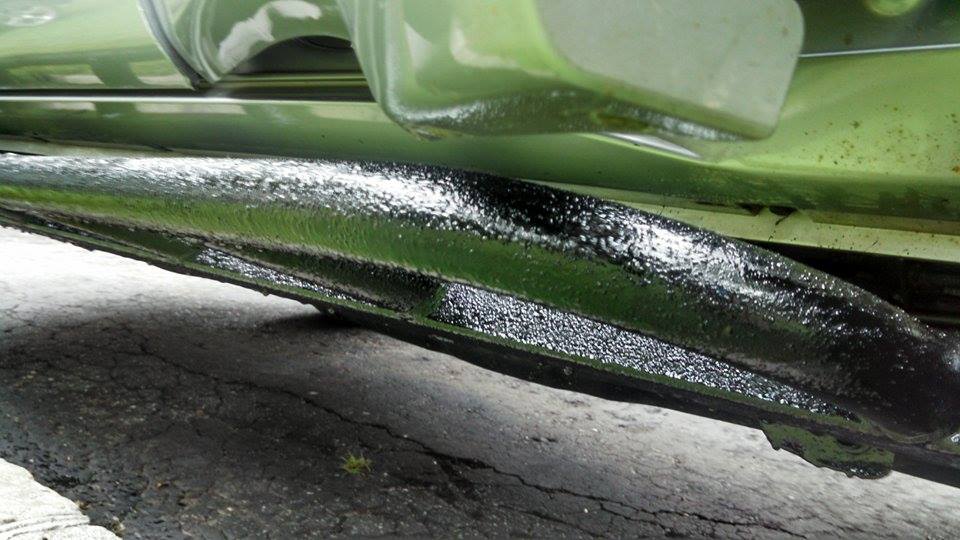

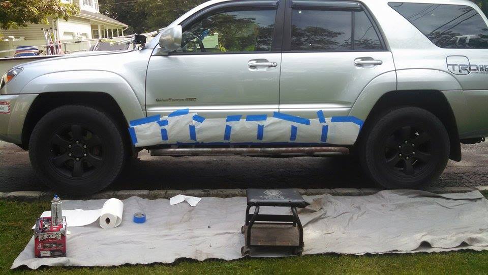

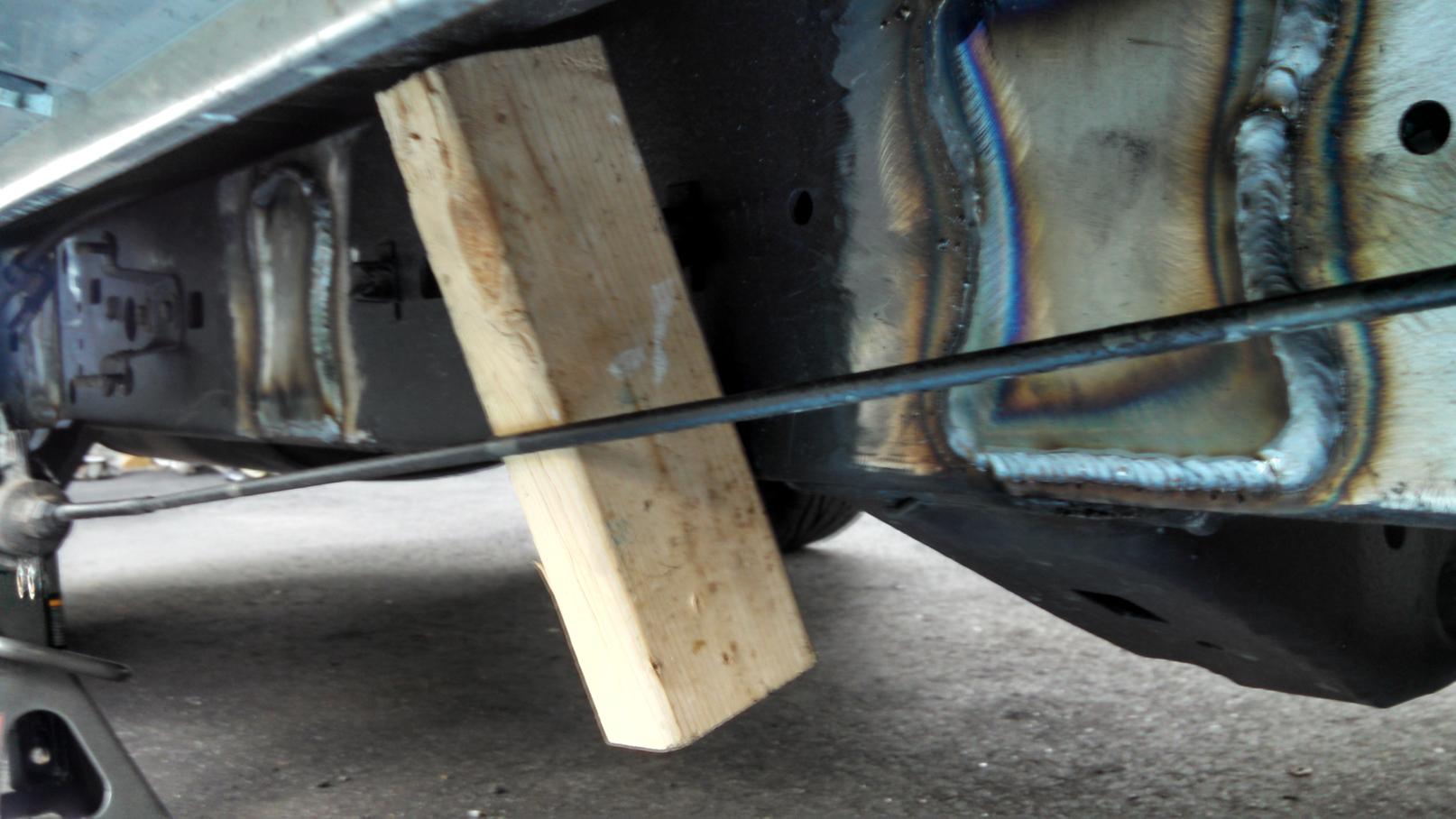

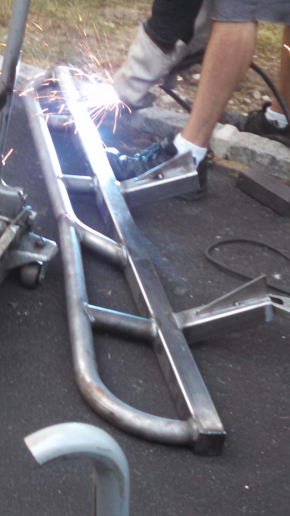

In the process of putting BAMF weld up sliders on. Had some trouble getting them to sit flush on the frame and still have the rear door be able to clear. Im not sure what the deal is exactly with that but the square stock feet had to be notched in order to compensate for the angle and sit flush on the frame with still enough room to clear the rear doors.
Currently got the drivers side on and coated it with Herculiner bed liner. Pass side will go on this friday.
Anyone who has attempted to weld sliders on has some idea of what im saying.. And if you haven't and are going to.. ask me and ill answer your questions.
ALL welding credit goes to my buddy Kris.
By the way my 4runner has XREAS and it was basically a non-issue when it comes to putting these on.
