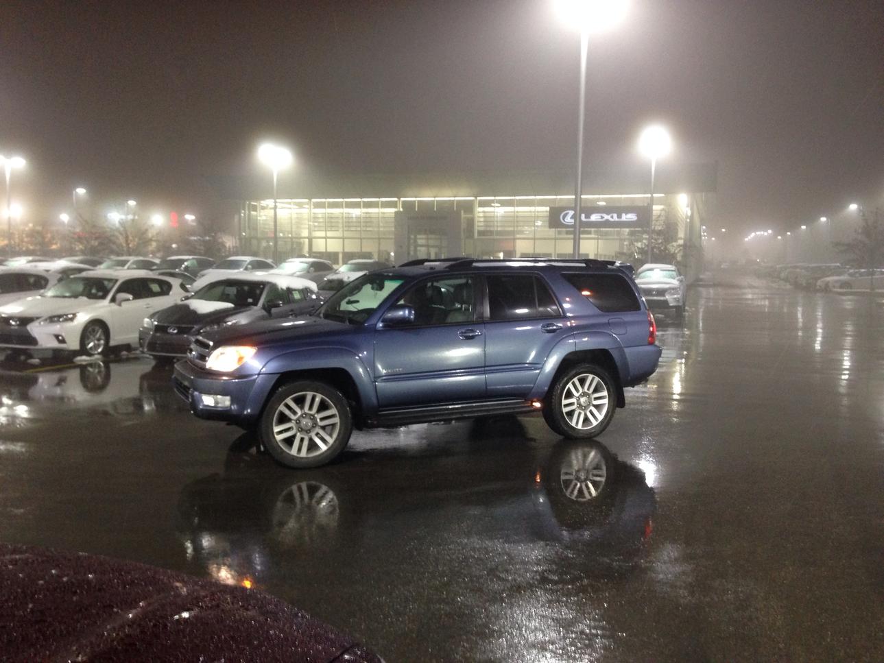

Just got a 4th gen, 2005 V6 Limited 4X4. No nav, no air suspension but it does have X-Reas (bummer) it had approx. 100,000 Miles. I had a 5th gen over a year ago, and have to say that this car is way more balanced and the V6 feels a lot more potent. I'm assuming because it's lighter?
I have a set of 5th Gen Limited wheels which were my winter set on Blizzak DM-V1 so they are on. 2006+ Taillights are on the way!
Anyways here is a pic, Pacific Blue Metallic.
