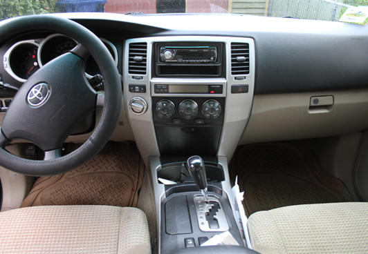

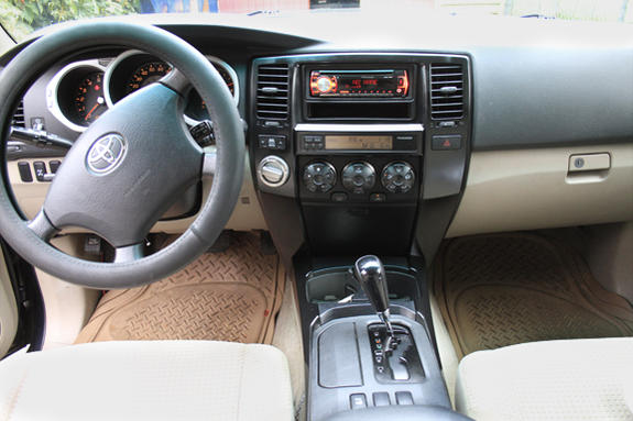

I've hated the silver trim on the dash since I first saw it, I finally had the chance to do something about it.
I popped the trim pieces off, cleaned em up and took a gloss black acrylic rattle can to em. Now it looks to me how I feel it should have come off the line.
For the heat-a/c etc window and the gear numbers I just covered them with Frog Tape then took an Xacto knife and sliced around the inner edge leaving them covered and peeled off the rest. Worked great but I shouldn't have had any coffee before doing it.

Looks awesome!
