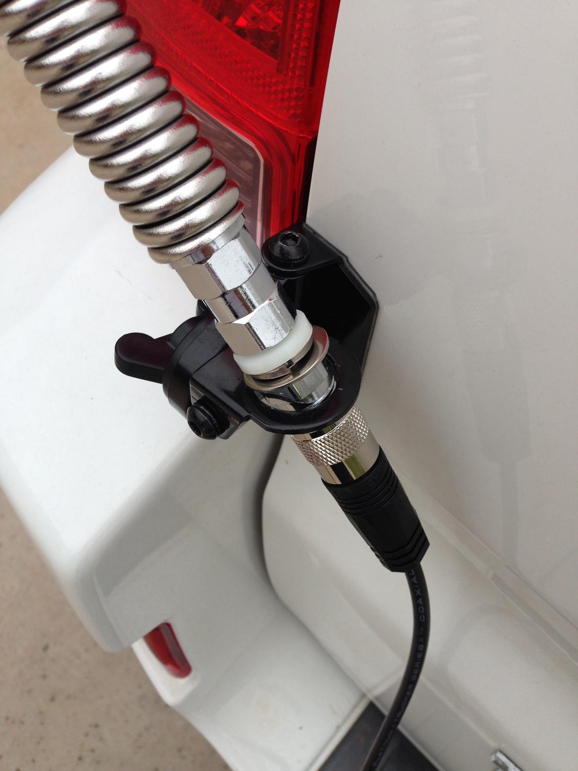

My CB radio setup is incredibly frustrating. I am having the hardest time getting the antenna to mount on the RS-720 and I am not keen on electrical work so thats not working out either.
ugh
