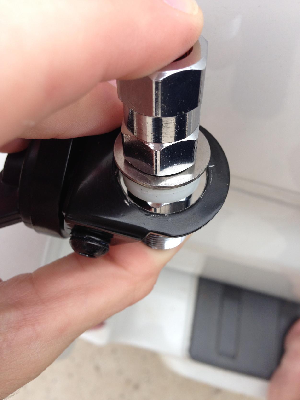

I have tried everything. The problem is that the Comets mount hole is bigger than the mounting stud. I have no clue why this is.

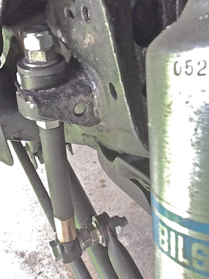

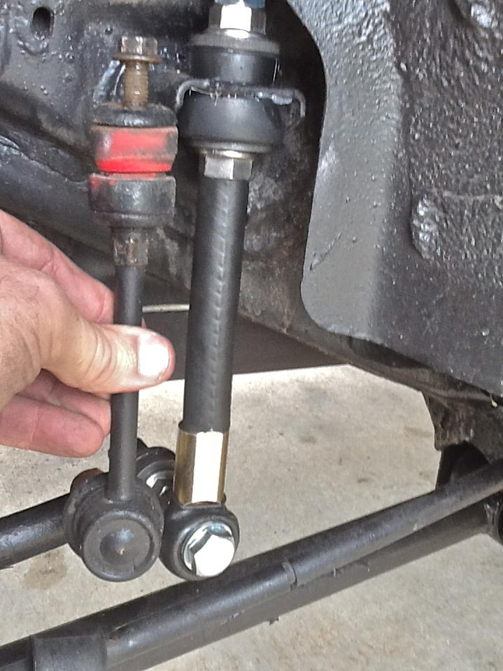

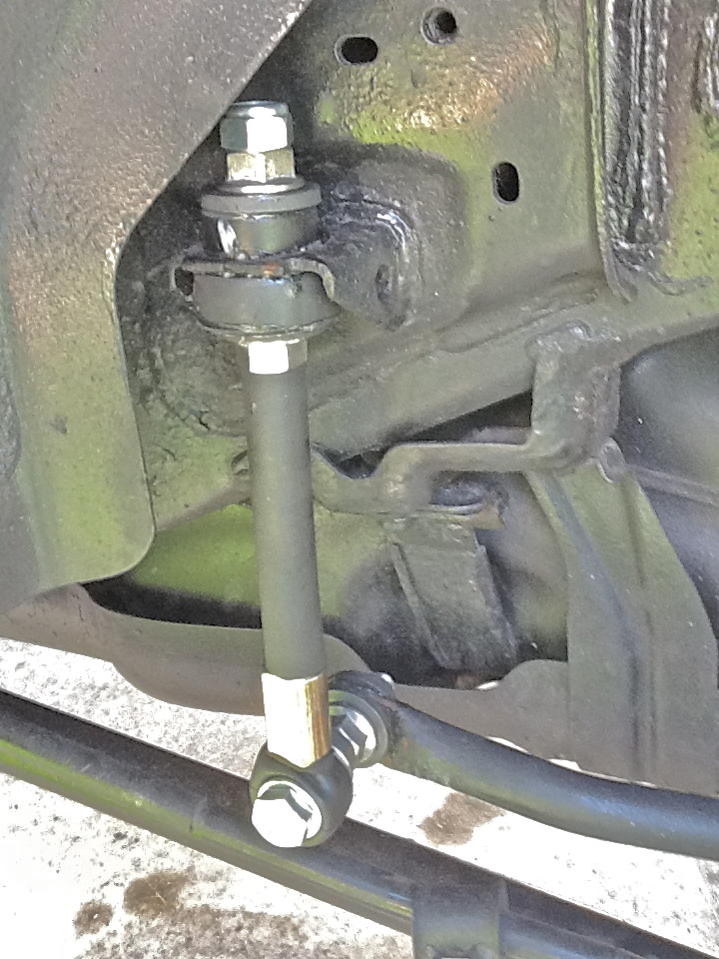

Homemade Rear HD Adjustable Sway Bar Links
My weekend project. Trying to get the rear sway bar geometry a little better. Even a modest 2" lift can cause binding of the end link and bushings on the OEM length sway bar links.

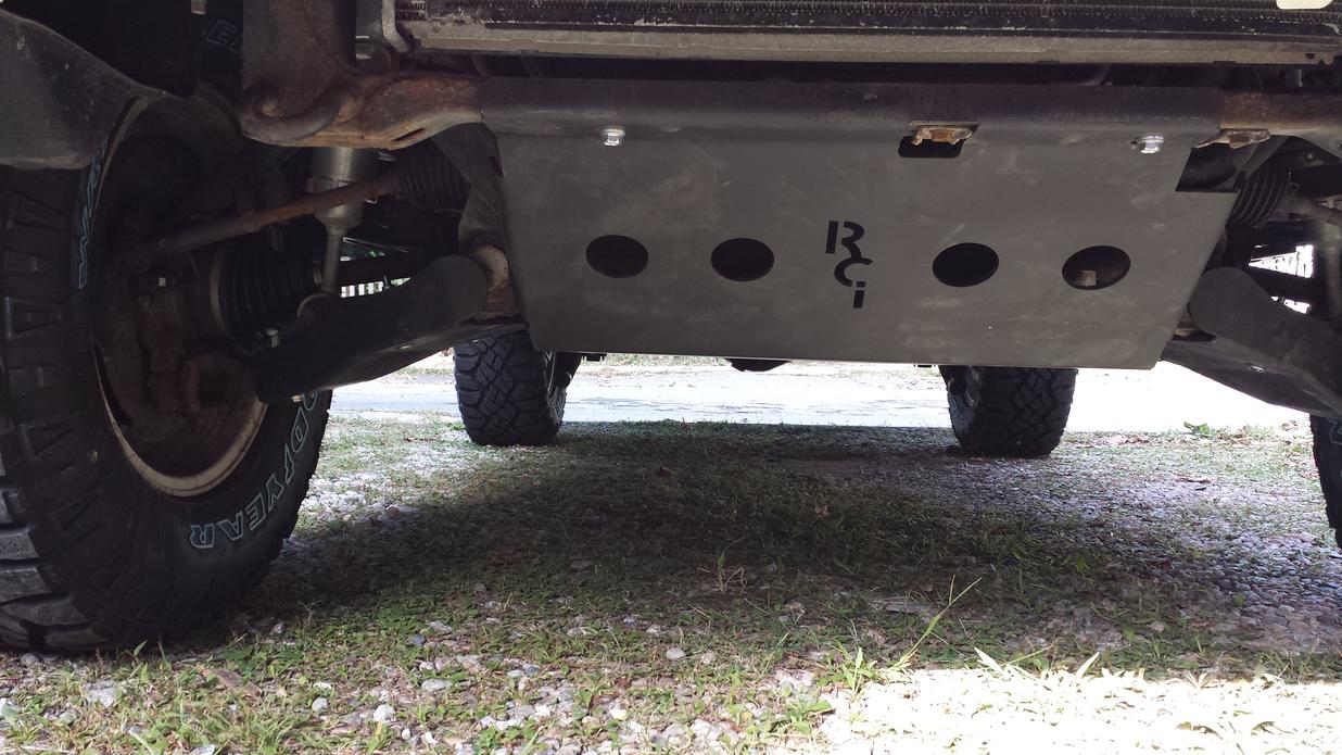

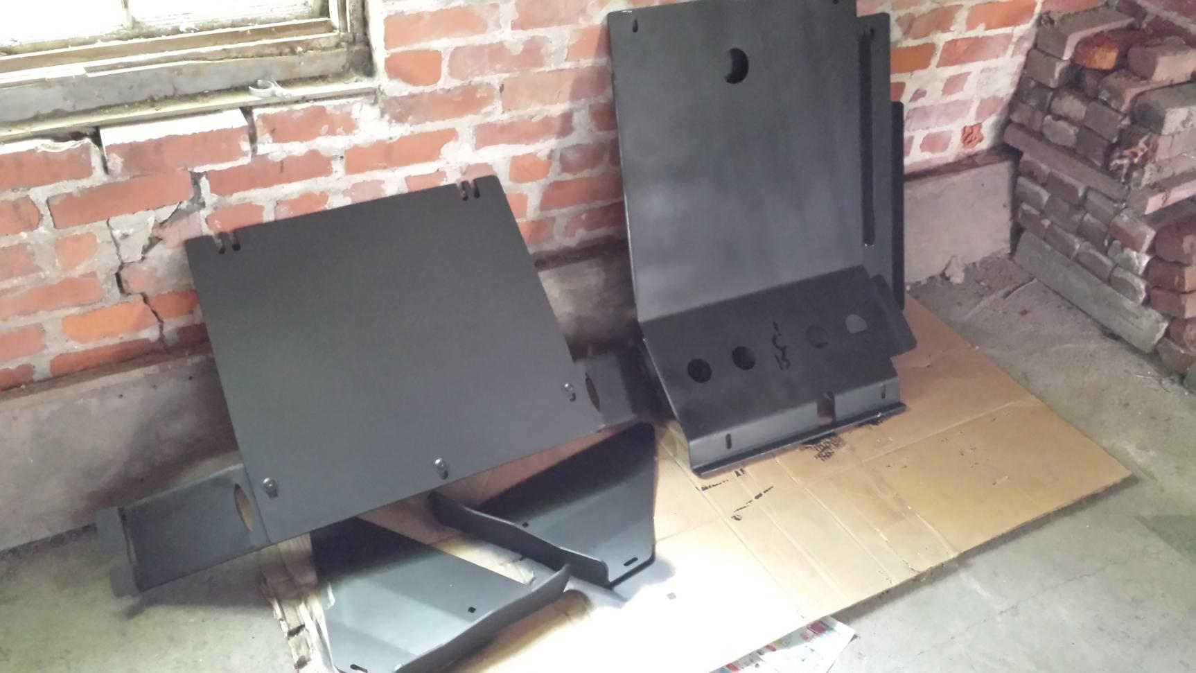

Slapped on some of my new armor.
I got on the Front and the A-Arm skids.
But I had to stop there since I broke the two bolts on the (pass side) xfer case cross bracket. :roadkill:
I'll have to drill them out... yeesh.

If it makes you feel any better Im in the same boat haha, I requested that RCI notch my cross member to accept the sliders I have and they werent...and then I broke the exhaust hanger bolt and turned back lol. Only installed the radiator/engine skid today.
Also tried out my new auto lock grease gun fitting...absolutely awsome. Last time I couldn't lock onto to some of the fittings on the driveshaft and had to use pliers and constant hand cleaning to tighten the fitting, not press a button and push and locked.
like steve said, the setup is all wrong.
Is that a firestik stud? I have what i believe is the same stud with the same mount and no complaints. Worst case, get another washer..
Second though, check the PN for me. Might be that you have the stud meant for the fire-ring connector.
You need the K-4A not the K4 if that is the case.
Mine is a K-4A. Bought it from Amazon and it says Antenna mirror mount at the very end.
I will probably swing by lowes tomorrow and get another washer.
