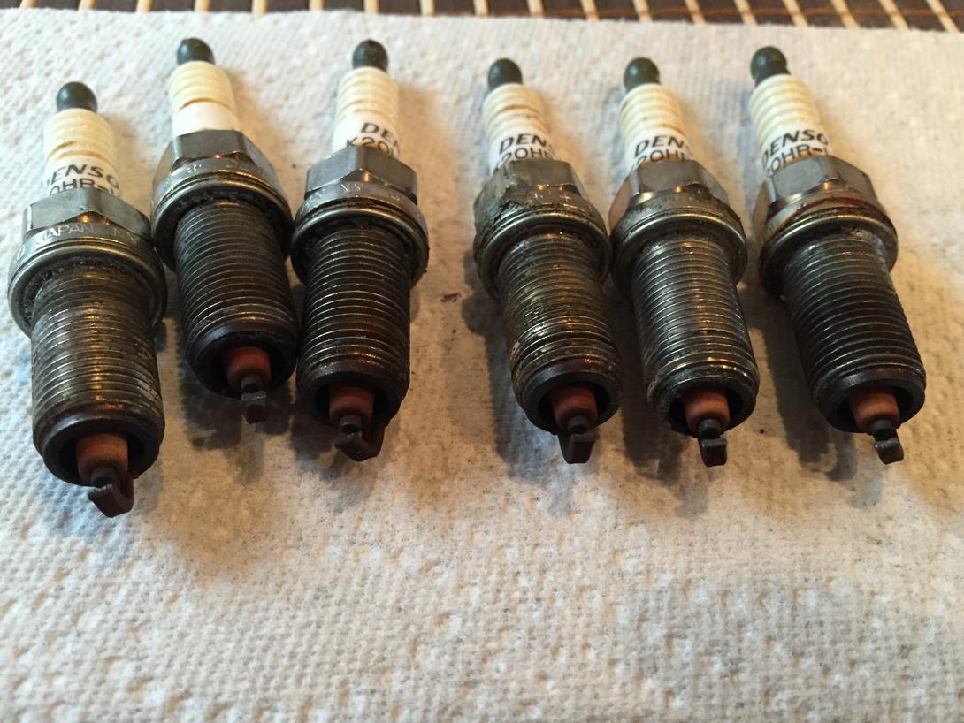

Went with OEM Denso. Toyota PN 90919-01235/Denso PN K20HR-U11. Although I usually go with NGK Irridiums, this time I could not justify paying 10-15 dollars each plug, found a deal on Ebay for 6 OEM plugs for 21.96 w/ free shipping. Just a side note when I checked the gaps 4 of the 6 were a bit too much @ .046, its best to be at .040-.043.
If your 4runner is equipped with the V8. 90919-01210 these are Denso Irridium OEM plugs
