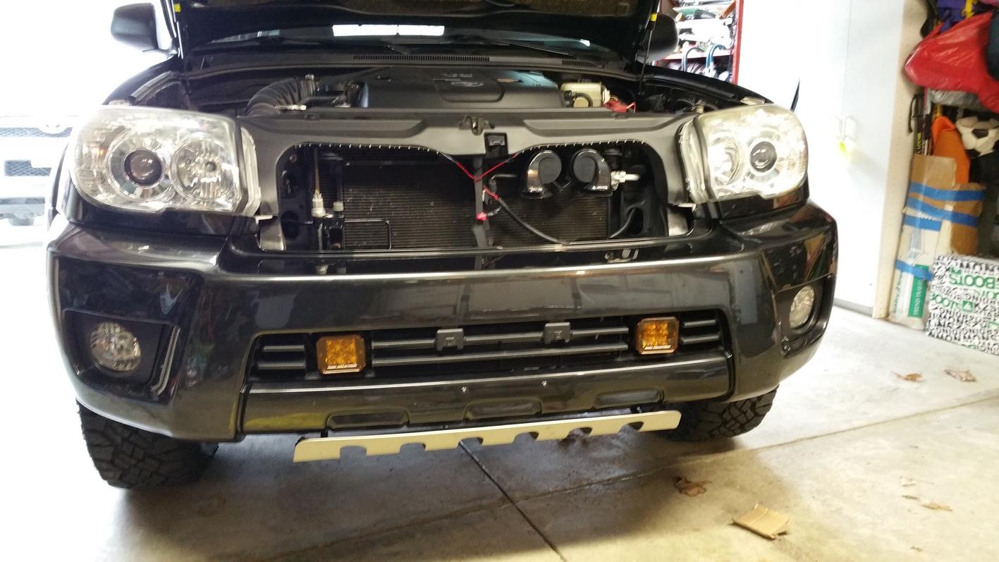

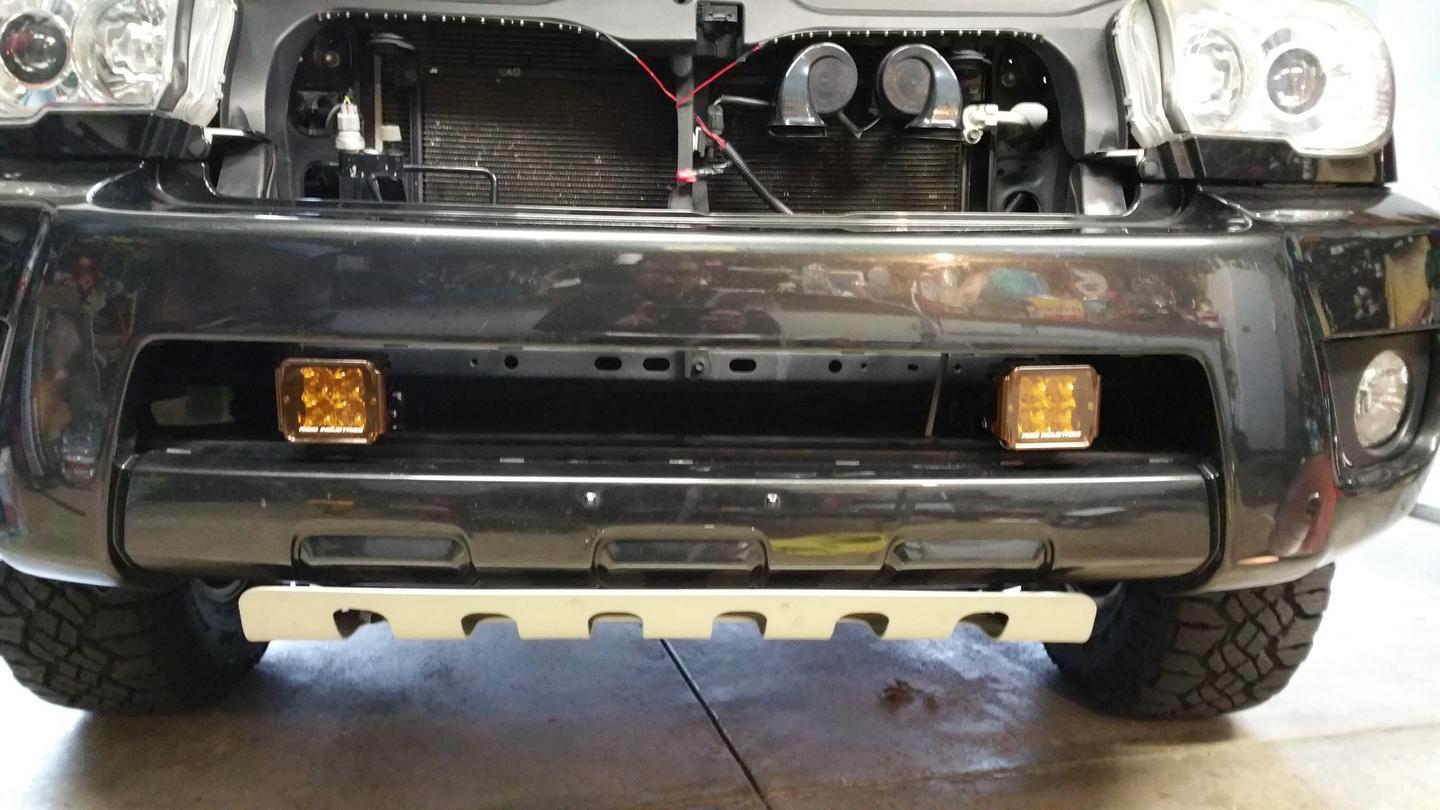

Put some work into my rig this weekend. Scored a deal on a shrockworks bumper that was modified for glass fenders and a body lift. Had to undo all the modifications that the previous owner did which entailed hours of grinding and rewelding. Bolts were a PITA to realign but it works. Here are some pics.
Still has some work and touch ups left. Paint and a few weld spots needed on the wings. The rework was worth it for the price I got the bumper for. I'm happy with it.

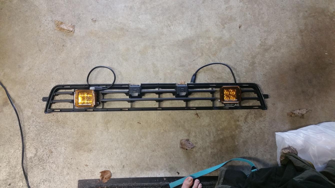

And finally after 4 terrible hours of frustration of loosing nuts in the front bumper that I'm never going to see again unless I take the bumper off it finished minus lights being wire still have to do that
Looks great but just a warning - it looks like it's a little close to the fenders, they recommend 1/2-3/4" gap between the panels and bumpers to keep from damaging the fenders/filler panels when the body and bumper shift on the frame while flexing off road. If it's possible and you plan to use it off road, I'd lower it a little.
It's really easy to take the bumper off and put it back on just so you know. 6 bolts, unclip the wiring harness to fog lights, and it lifts right off. 2-3 minutes

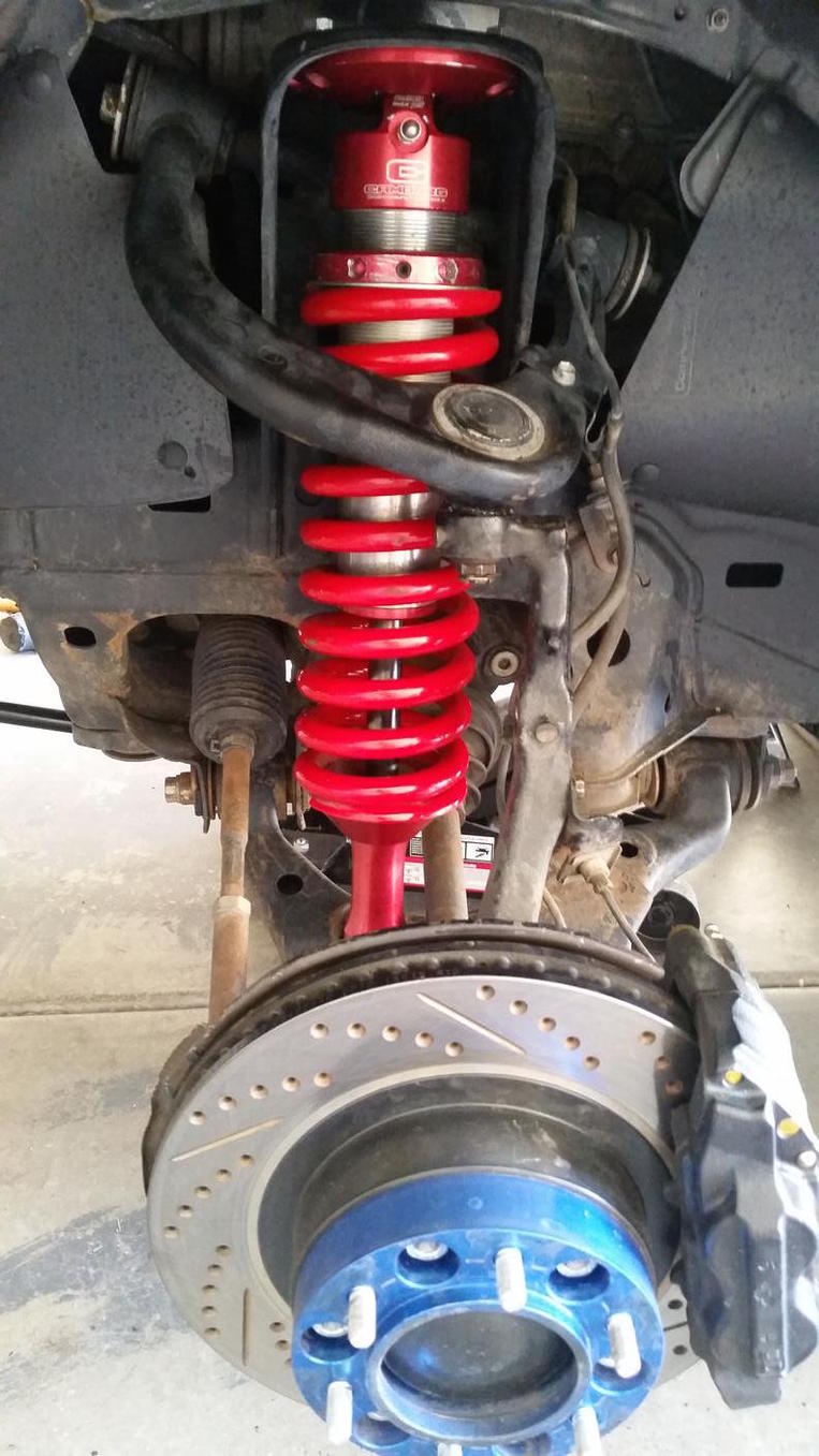

Got the craigslist specials mounted up. The ride is amazing, very pleased. Now if I could just find some camburg UCAs in stock...
right, thank you! that was brought to my attention once I installed it. lining up the bolts was a PITA. i know i've gotta loosen them all up again and try to get that gap. hopefully it won't be too bad. thanks a lot.
