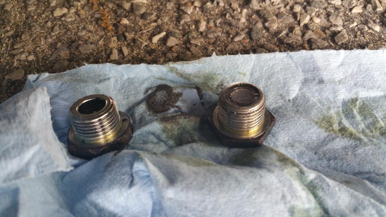

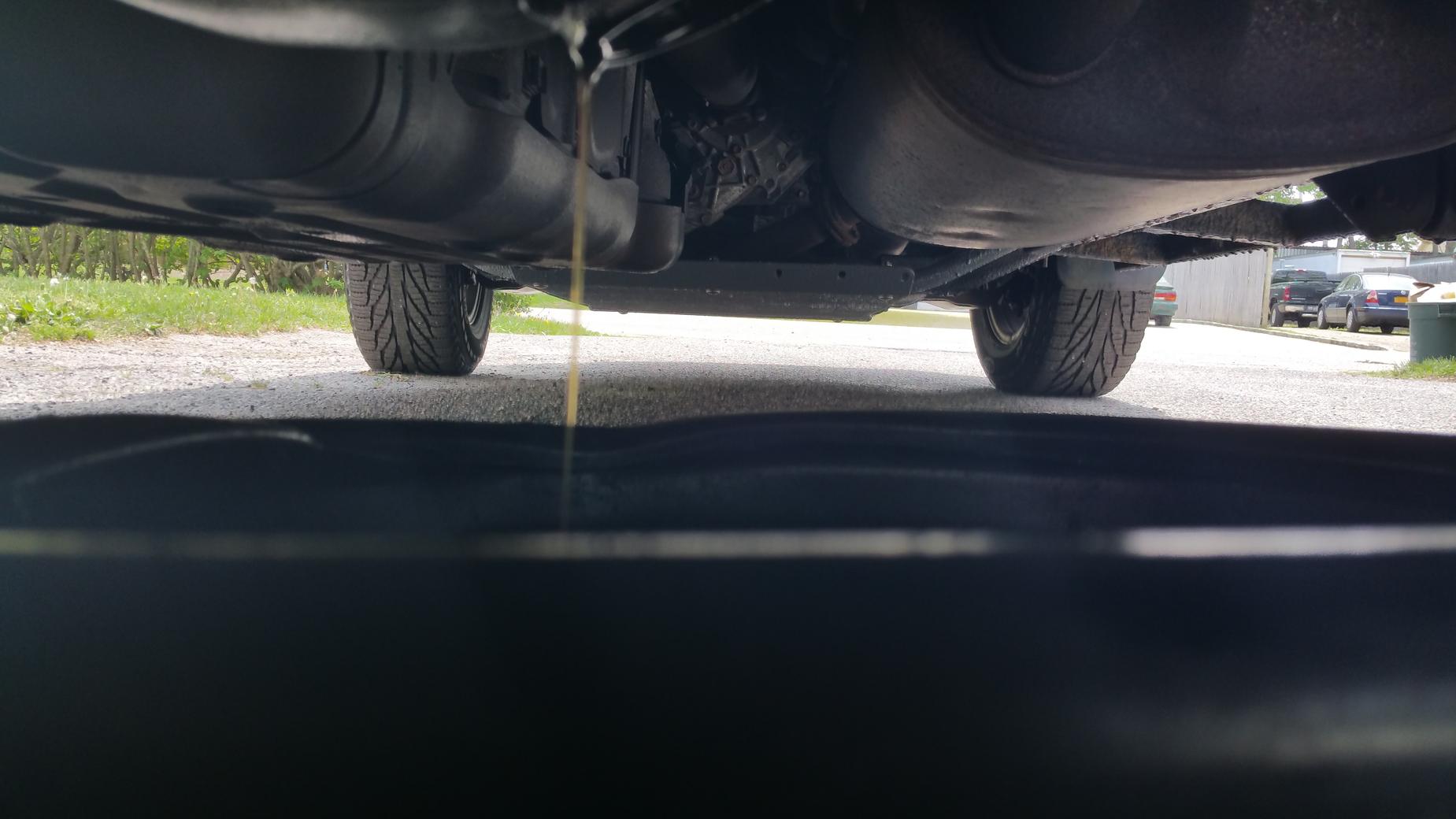

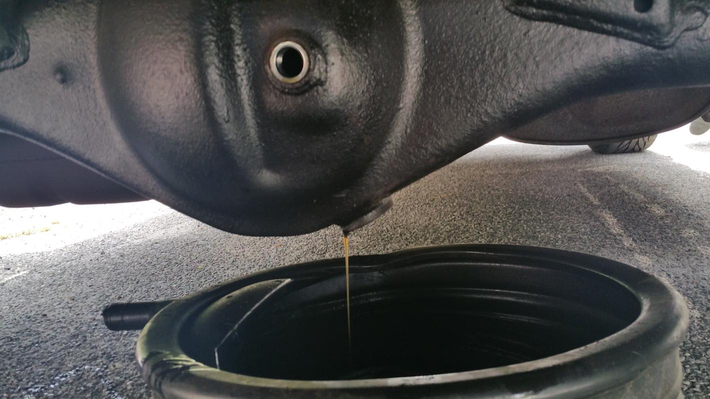

Changed rear diff fluid today.. Way to easy for anyone that plans to get it done, .. do it yourself.. Oil changes are harder. Kinda messy with the mobile 1 bottles just cut the tops and squeeze it in.
Original fluid looked normal, drain plug had no visual signs of shavings or wear. Everything came out and went back no issues with rust.
Mobile 1 synthetic 75w-90

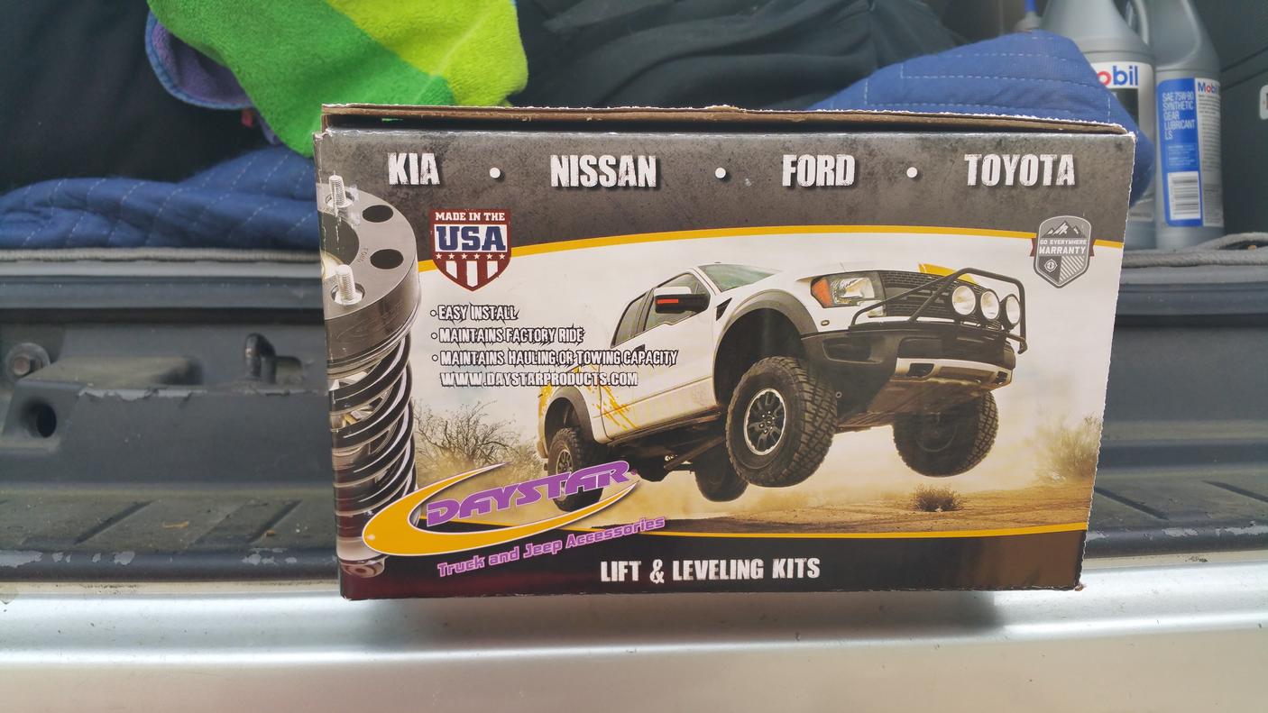

Also got a little project for tomorrow in the mail
Daystar lift

That is one damn clean undercarriage. Did you just get it sprayed or something?

[MENTION=12797]JeffM[/MENTION]er I do a yearly/spring time underbody cleanup, hose it off real good, roll around on the creeper, light wire brush any rust and hit it with 2 to 3 cans of either underbody or some heavy duty black spray paint on any vulnerable spots. it keeps it clean, protected and looking good. But honestly, its one of the cleanest northeast driven 4runner i've seen underneath which is one of the reasons I bought it.
